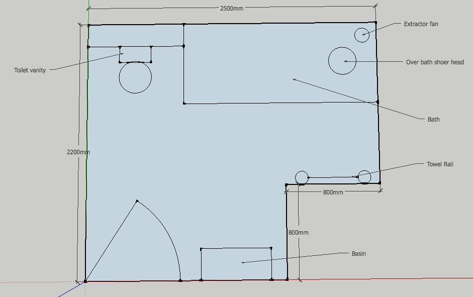

Hey guys,
I'm struggling to decide on how to position the lights in my my bathroom.
It's L shaped, with a bath with a rain shower head.
We don't really want a light over the bath ( for when she's laying back looking up)
I've got 5 LED down lights - don't have to use them all.
I'll attach a rough plan of it.
Any ideas?
cheers

You can get swivel type down lighters that willl point elsewhere than down

2x down lights spaced evenly, taking the line from the centre of the back wall.
50w or equivalent led wide angle 38 deg. This based on the installation of additional side lighting at bathroom mirror for an even shave.
Add a dimmer for bath time:censored:
Happy now :)
To make it less rough, do the following:
  1. Camera -> Standard Views -> Top
  2. Camera -> Select Parallel Projection instead of Perspective
Any ideas?
A decent-sized ceiling light in more-or-less the centre of the room.
Dimmable wall lights for when relaxation is happening.
Yes, thats what I would do, first find the centre of gravity of your ceiling and smack in the middle. just one light is enough. Pretend you haven't got a corner, but I know you have a corner and you have to lie to yourself.
