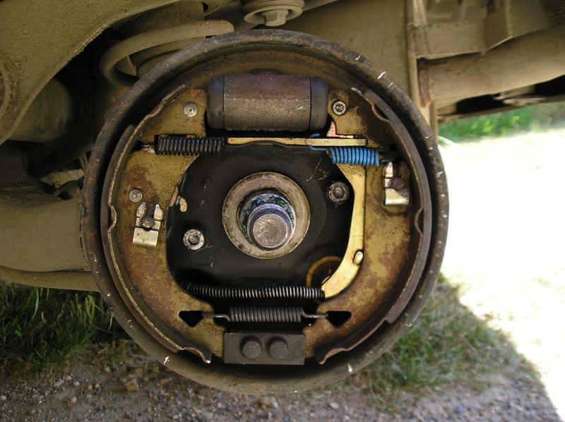

Unscrewed the adjusting nut under the handbrake ( that was screwed up as much as possible) got the hub off and found this;
All looks perfectly normal but before I start working and spending, just wondered if its just the cables I need to change? Should I change everthing Thanks for advice! :confused:
All looks ok there - I assume the car has excessive handbrake lever travel?
If so, check that there isn't a snapped cable, and the self adjusters are ok. (That design is fairly reliable, as it happens). If they are both ok then its either new cables you need or drums too - if they are worn over their maximum allowed diameter.
John :)
The adjusters look like the 'ratchetting quadrant' type, which are behind the left hand shoe, looking at your pic.
Basically if you had the shoes off you would check the pivots of the quadrants for rust / seizure, and also check the knurled surfaces of the quadrant - effectively they move apart when the pedal is pressed, and stay there due to the gripping action of the knurling. All this is fairly obvious with the shoes in your hand, but awkward as hell to describe :confused:
If you want to experiment, leave one brake side untouched, with the drum on, and gently press the brake pedal. You should hear the quadrants move apart with a clicking sound. You'll need to reset them afterwards, or the drum won't go back on.
Just a comment concerning the cables - they may look ok, but you can't tell if they have stretched or not.....
John :)
