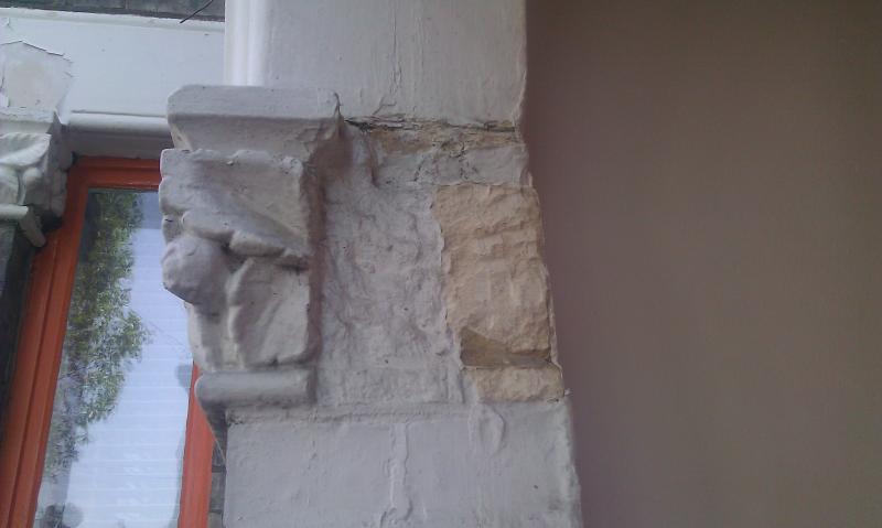

Hi all,
I live in a semi-detached house built 1897. There is a decorative masonry moulding in the entrance porch that has been half broken away by a previous secondary outer door. My plan is to make a copy of the intact one on the neighbour's house. What is the best way to make a cast, bearing in mind that I can't have shuttering / supports blocking the neighbour's doorway for too long!?
Might have to try and make a cast with air drying clay so I can make a quick impression...

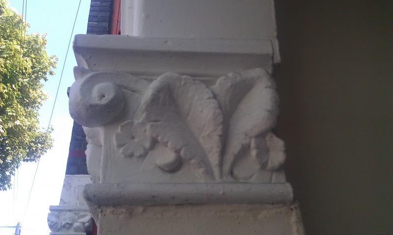

Firstly the two castings shown have different profiles and are not the same.
Secondly there are undercuts on that cast and you will not be able to run a mould of any sense.
Thirdly, an old school bricklayer or plasterer should be able to run that cast freehand with ultra rapid hardening cement small piece of thin ally and few stainless steel screws.
Regards oldun
There is an 'identical' pattern elsewhere on the house, but I see what you mean about the undercut.
