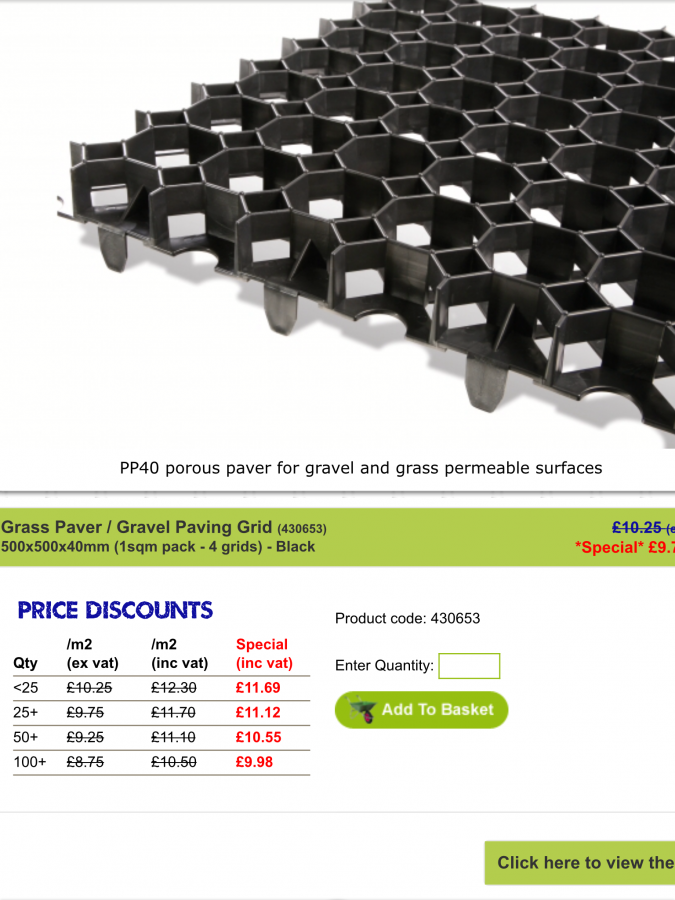

You can lay these where you will drive over.you can then put grass seed in the soil,this will then grow back like a lawn and you can mower over the top with your lawn mower.You get a nice neat lawn.You will need a hard core base before you seed on top for good drainage.

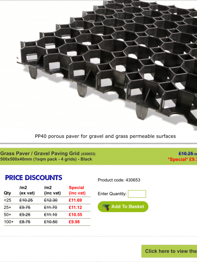

View attachment 104499 You can lay these where you will drive over.you can then put grass seed in the soil,this will then grow back like a lawn and you can mower over the top with your lawn mower.You get a nice neat lawn.You will need a hard core base before you seed on top for good drainage.
The car will be parked there most of the time so grass wont grow
Unless you are the sort of person who goes to work every day in his car.
Before you speak think about other options.
This is a second car i will be using on weekends, i have another car.
