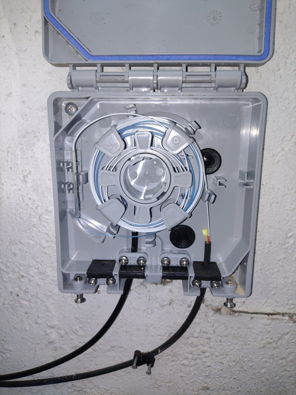

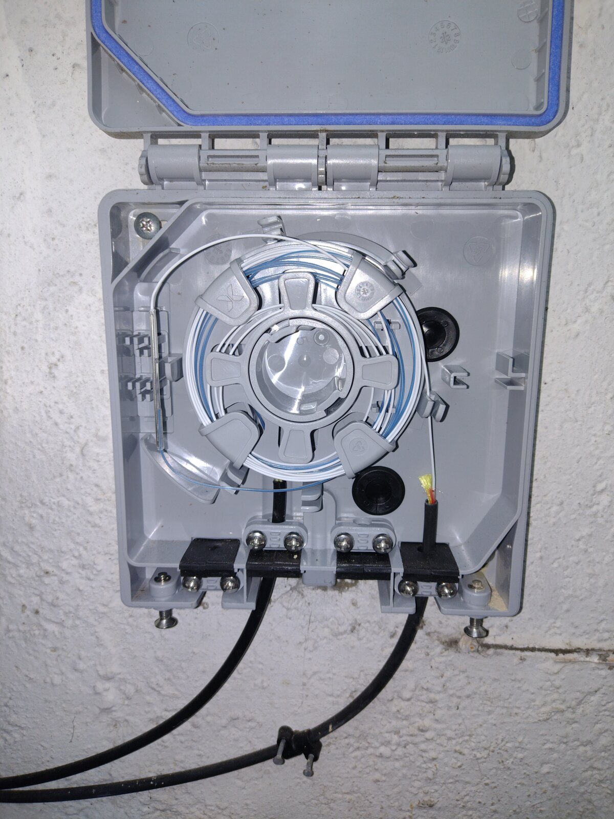

I would like to relocate my fibre broadband from the 1st floor to a room in my loft
There is a grey box outside. Inside of the grey box, two cable are joined together (pic 1)
1. Can anyone explain how the two cables are joined together?
One of the black cable from the grey box comes into my property and this then connects into the optical slot in the white box
2. How does this happen?
Is there some sort of guide online about moving you fibre broadband.
fusion splicing.
The various protective layers are stripped off the fiber leaving only the glass core and cladding. The ends of the fiber are cleaved (cut *very* nearly) and then placed in the splicer. The splicer aligns the fiber ends and then uses an electrical arc to weld them together. A protective cover is then slid over the joint and iirc in most cases the cover is then heat shrunk onto the joint.
Fusion splicers are pretty expensive, presumablly because of the high precision required. The signal carrying core of a typical communications fiber is 9 microns in diameter, so for a good splice you are talking sub-micron levels of precision.
There also exist mechanical splices for fiber, but I believe most telcos avoid them due to reliability concerns.

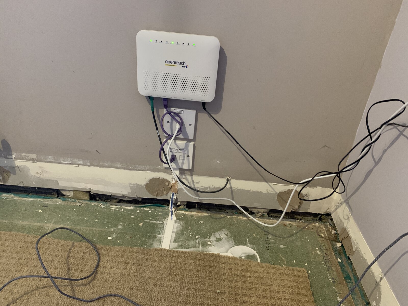

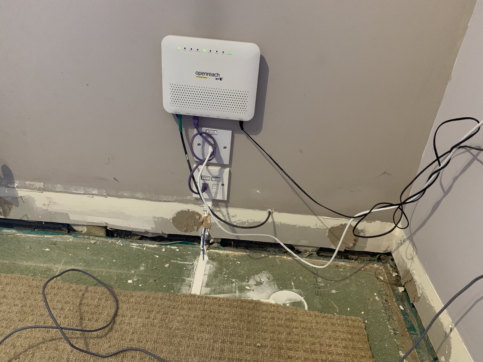

BT have tried various approaches, one approach involves a cable with two jackets, a heavier one for outside and a lighter one for inside. The heavy outer jacket runs to the point of entry, then is stripped off for the indoor part of the run. Then a "field fit connector" is used on the end of the fiber.
I think there are also double jacket cables with pre-fitted connectors, though I don't know how the excess jacket is removed on such cables.
BTW on the subject of fiber connectors be aware of the difference between flat polish (PC/UPC) and angle polish (APC) connectors. Trying to intermate a flat polish connector with an angle polish connector may damage the connectors. Angle polish connectors are color coded green.

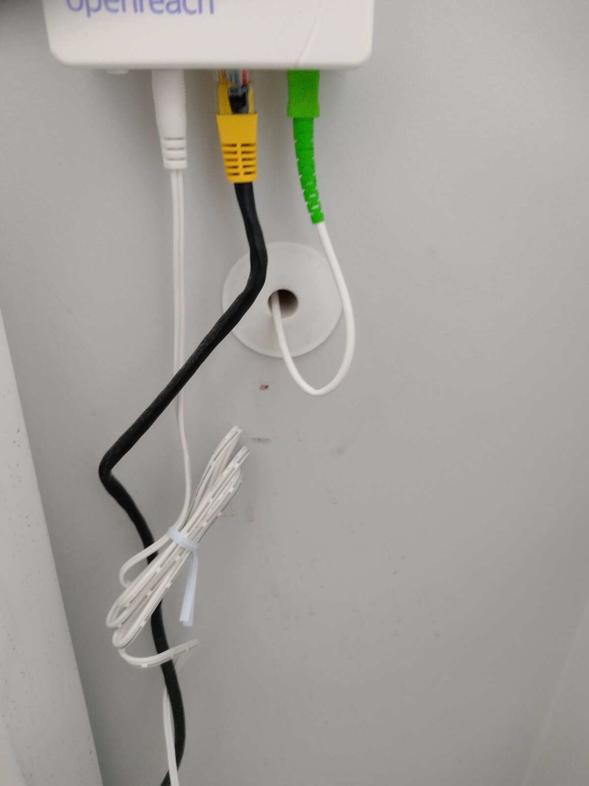

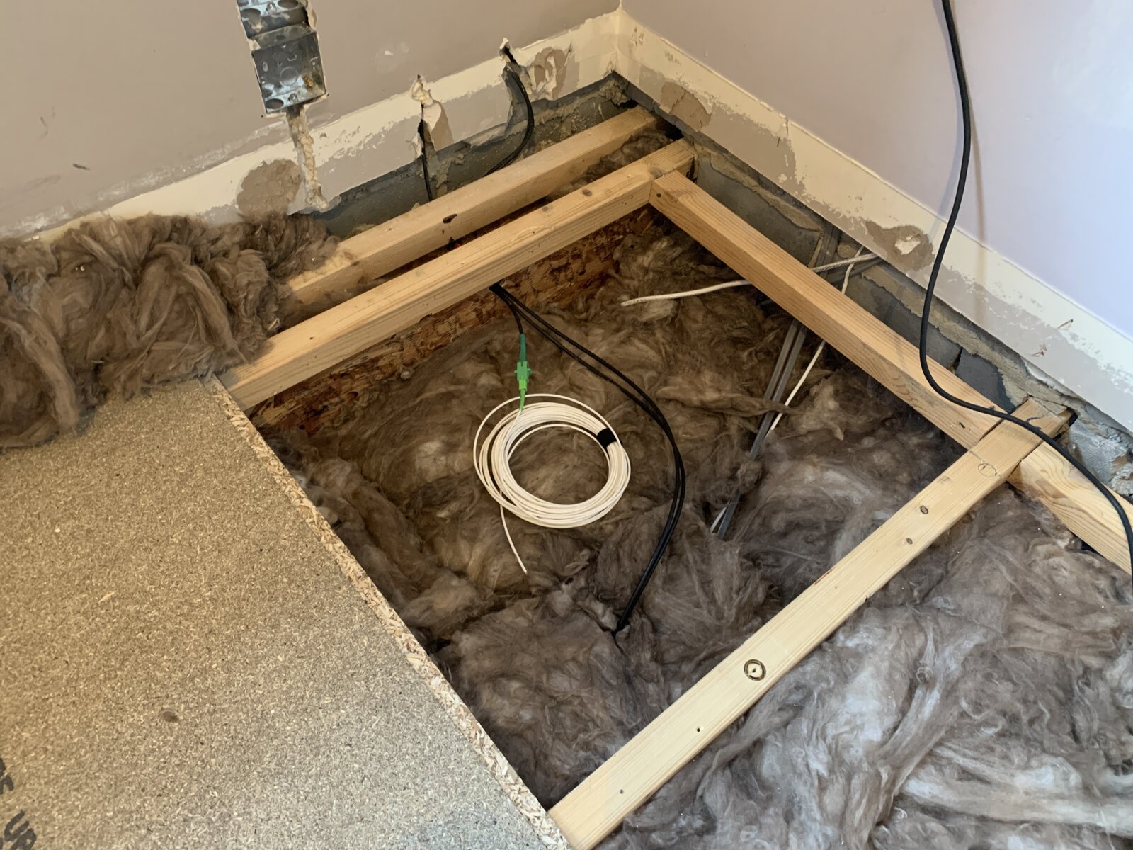

Use this:
It comes with a coupler to connect your existing fibre cable to the extended one.
Unplug the green capped fibre from your Openreach box (hard tug), try it in situ with the coupler and extender cable before moving your kit.
I suffered no speed loss whatsoever, despite the extra 10m length in fibre cable and small signal loss the coupler will give you.
If Openreach ever got shirty about it you could always remove it all and put it back to how it was.
Note: The fibre extension cable is a little delicate so handle with care and do not over bend the radius, it is not suitable for running outdoors, although if you did want to do this there is some outdoor rated fibre cable you can get on Amazon:
See below for photos of what i did to extend mine, was originally on the wall in the spare bedroom, extended it down to the garage below through the floorboard/ceiling.
