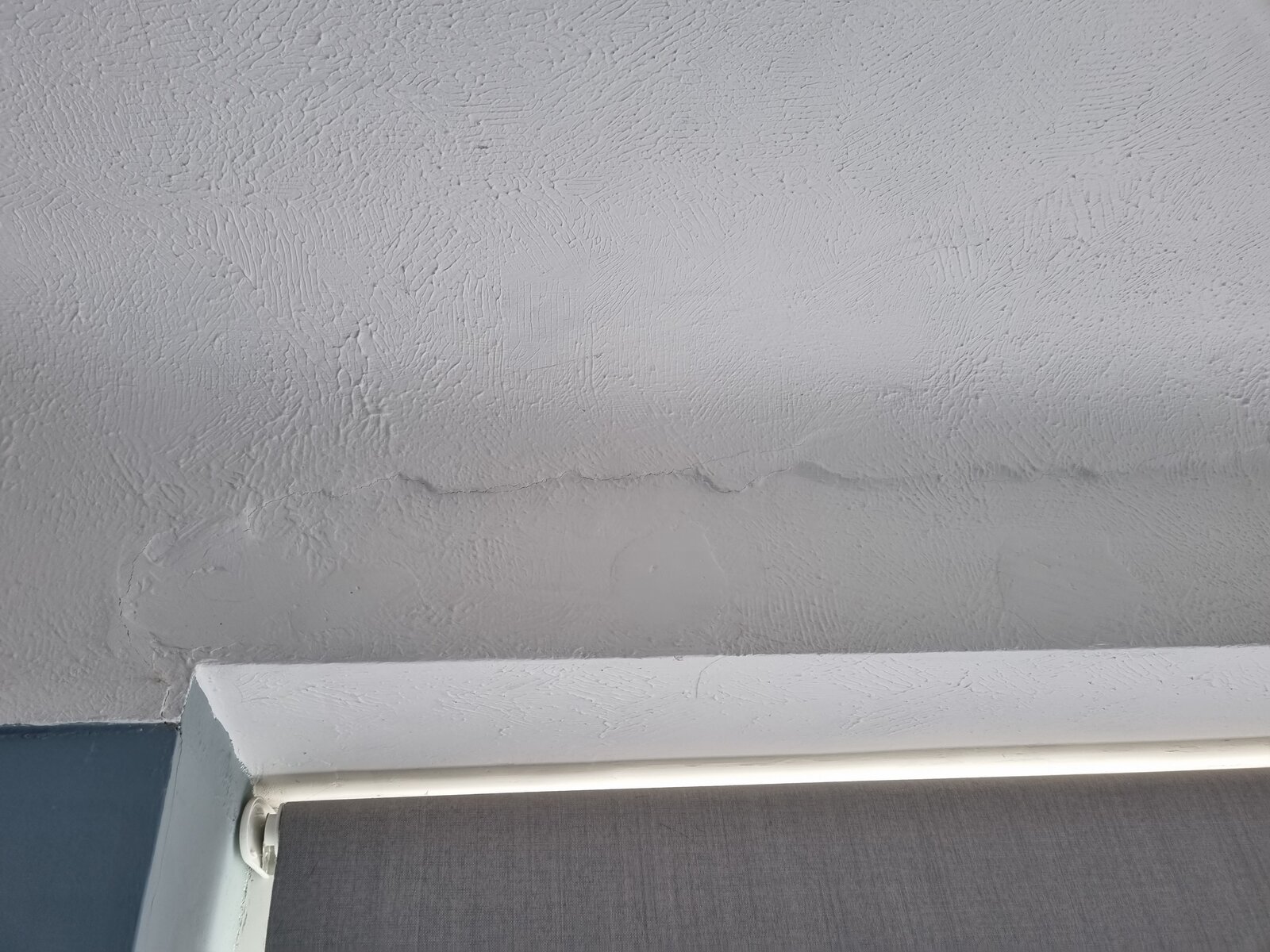

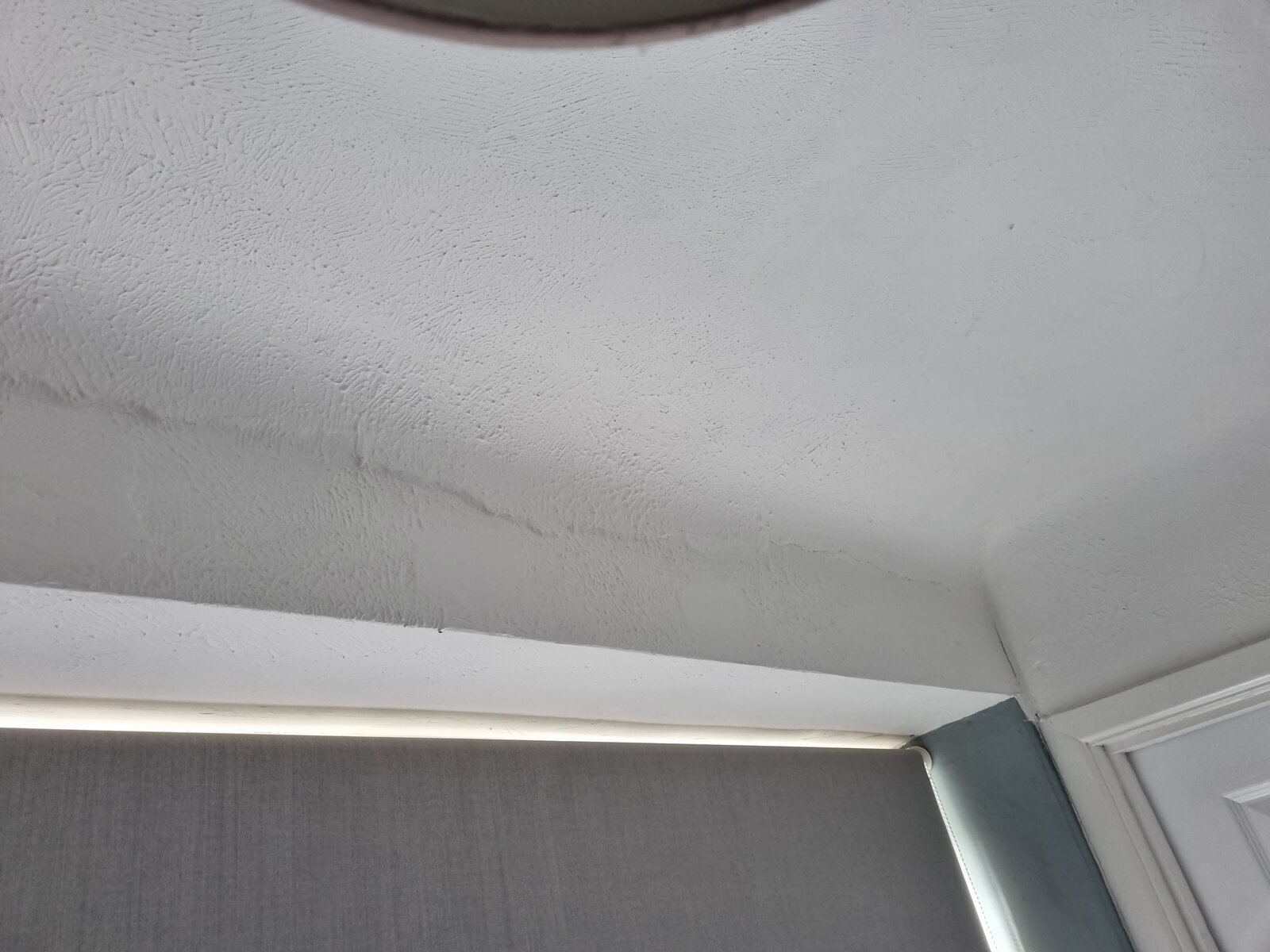

Hey
Some movement above a window from ages ago! Going to refresh the landing either paint so was going to tidy this up
Am I best giving it a light sand? Then pva? Then just grabbing a small tub of ready mixed plaster to tidy it up.
Dont sand anything - Pva the patch and then fill with your repair plaster over a tacky coat of PVa.
There has been, historic you say, movement of the lintel - various cracks can be seen.
Ahh cheers won't sand it then. Will sort it out over the next few weeks
Yeah deffo some movement, I'm guessing it from when windows got swapped to upvc, only a guess.
Moved in 7 years ago and was already present. Cant see any movement or cracks in external side which is rendered
