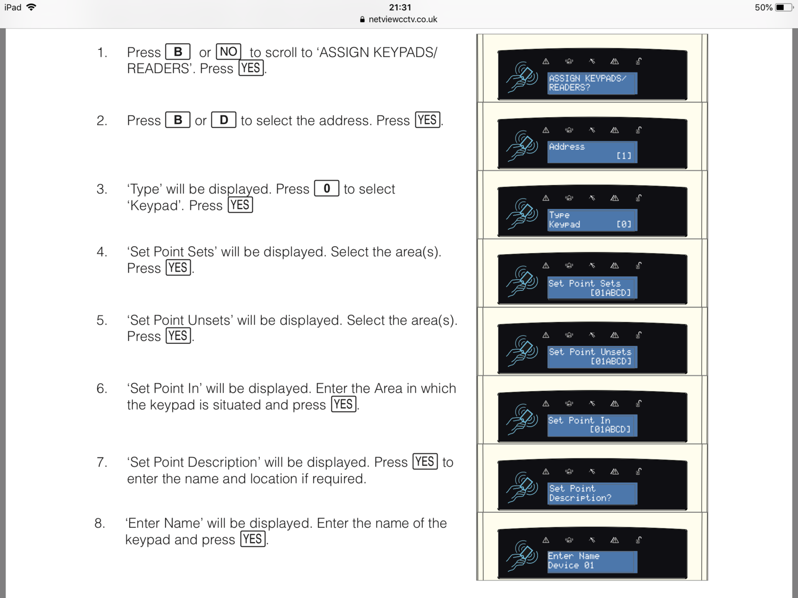

Hi all
Just been trying to program the areas on the Euro 46 V10 system and im getting totally confused.
I have 4 sensors
sensor 1-3 downstairs and 4 upstairs
The manual states area A full set and area B upstairs.
Going through the manual i choose
the input, e.g 01 - then
input type e.g intruder, then
input areas - i select A although know i can select others to but do i need to?
Input areas - Any or all- I do not know which one to select i assume its any.
The attributes i select all as omittable and all other settings i leave as the default setting.
Do i select all inputs as A and the one input as A and B, i have tried different combinations and on exit i get a message saying area miss match. Obviously i am doing something wrong could you all point me in the right direction.
Also a door contact would i class this as Final exit for the input type? this is the door being used to enter and exit property.
What i want is area A for full set and area B to set all down stairs but leave ones sensor unset (upstairs). So would i set inputs 1-3(downstairs) as A+B and input 4 as A only?
Area mismatch because your keypad is only set to area A
...so everything in A , everything in B except the items you want off at night ....eg landing
Yes final exit for entry exit door
Followed the above, Got the system working a treat, thankyou for your help.
