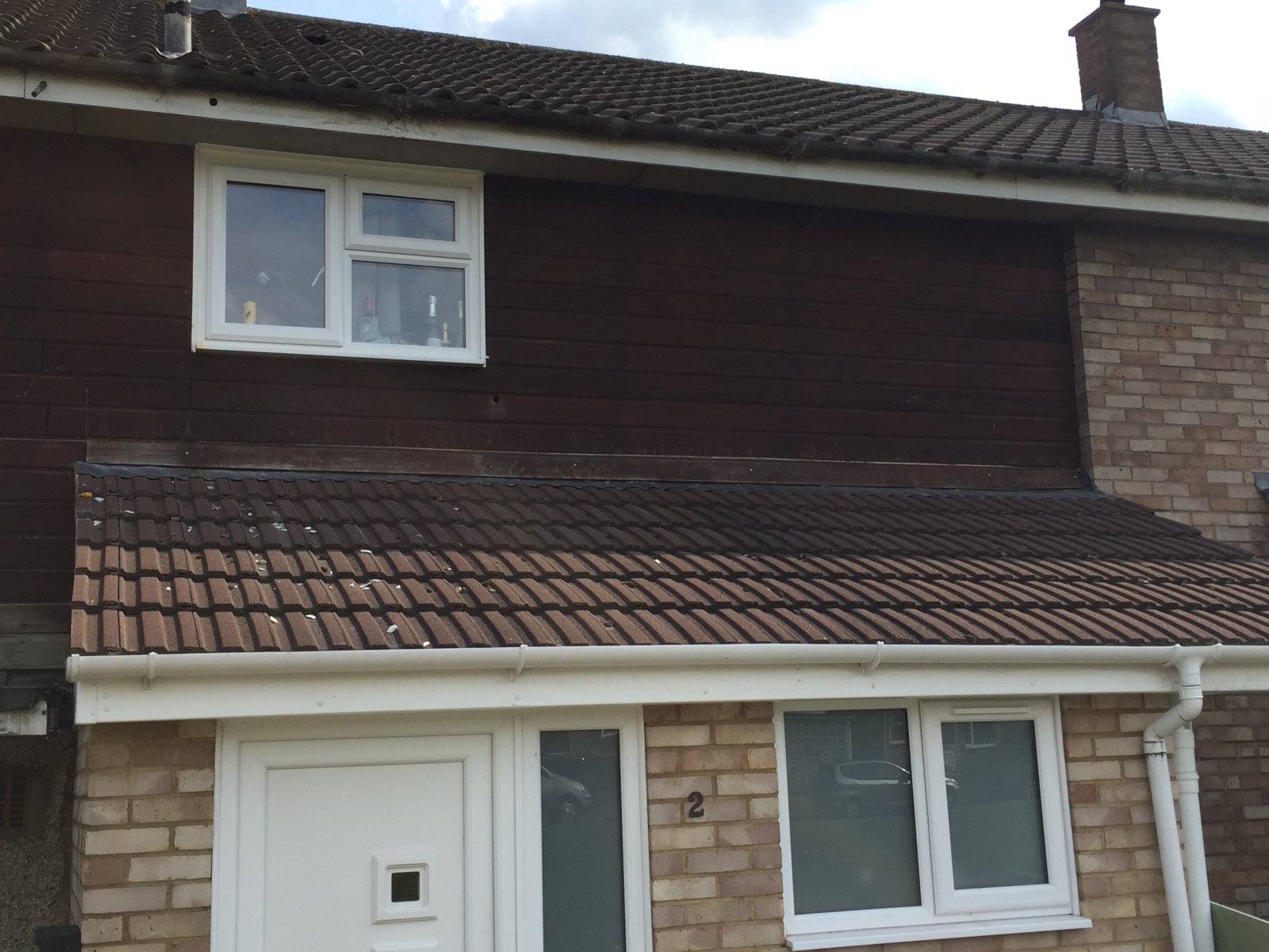

As seen in this picture, the front of my property has wooden cladding.
When we had the porch extension done last year, the builder removed the cladding row that was at the same height as the led flashing and was then unable to fit the cladding flush as it has led flashing sitting behind it.
This has been an eye sore ever since and I was wondering if I could remedy this myself. I would appreciate your advice.

Remove it.
It looks to me like he has gauged the tiles poorly so that the top course of tiles falls a little short and the width of lead he is using does not have enough upstand to dip behind the next shiplap board up. You can tell the tiles are short by the way that the very top left hand tile doesn't interfere with the cladding when really, it should. The top course should be a lot further up.

Looking at your other thread I'd say he's gone beyond max on the gauge and owes that roof another course of tiles.(y)

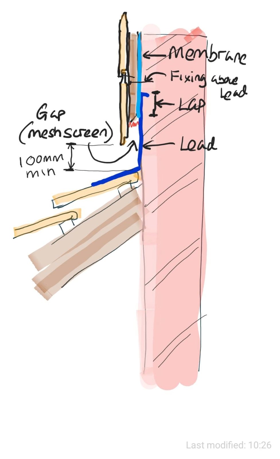

The lead should finish under the shiplap boars yes, even if that means a little kick on the board. There should be a vertical gap between the lead and the clad material.

Whatever the material, i.e. shiplap, render etc, the cladding material should not be touching the lead, rather there should be a splash gap.
If the lead is dressed correctly then there will be minimum kick on the bottom board. Your job has been made ever more difficult by an inept roofer.
