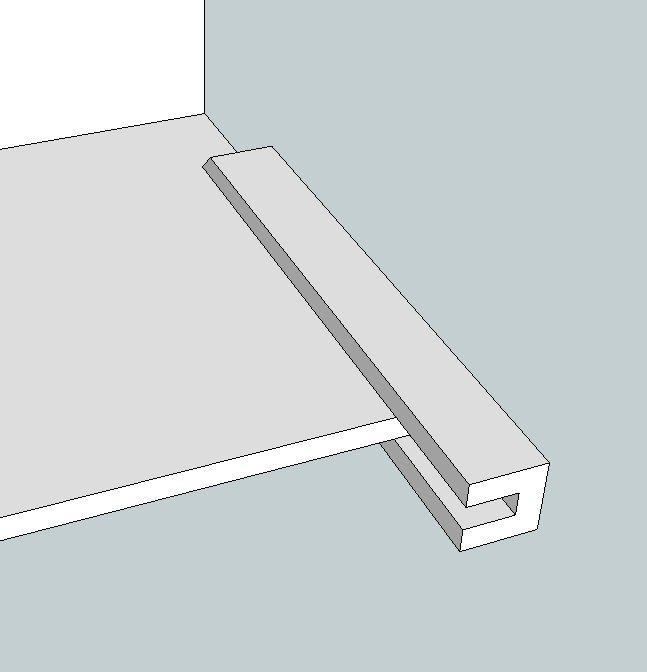

I can't (I think) pin or glue oak stripwood to the front ... too thin ... so was wondering what other options I might have? Maybe create some thicker oak strips that have a 6mm channel routed out of them and attach those?
You certainly can't pin anything that narrow, it'll either split the lipping or the shelf, or both

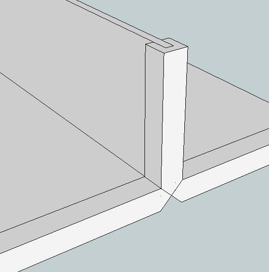

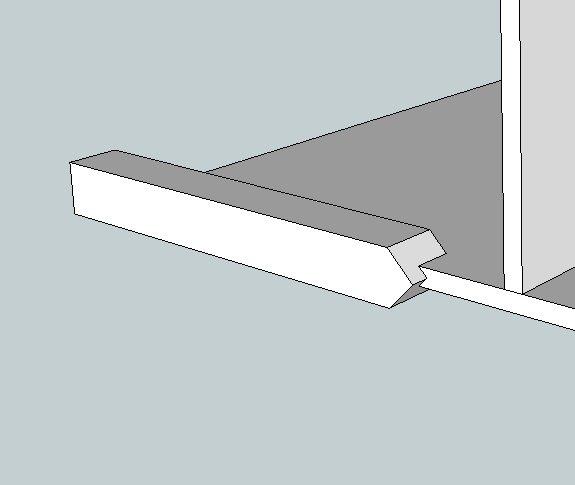

In my own case I'd probably make-up U-profile pieces of timber to slip over the edges then glue them in place. Where they meet you'd have to mitre the joins. This just needs a router and a grooving cutter
Whilst I've shown those with square shoulders in reality I'd knock the arrisses off with a block plane

Thank you! And thanks for the lovely SketchUp work ...
