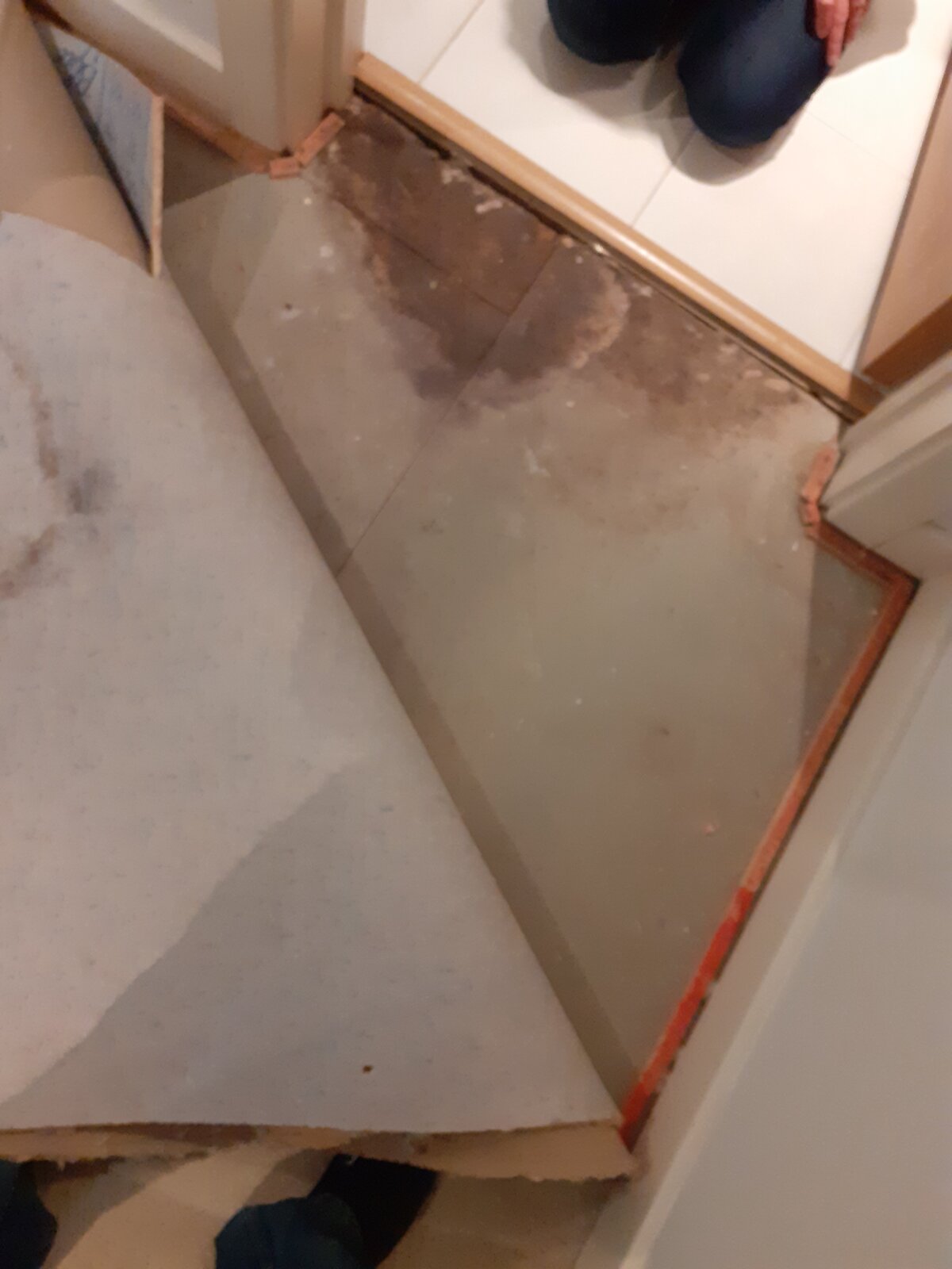

The wood I presume chipboard needs replacing, it's under the carpet. Should I replace the whole length or cut the rotten bit out with a circular saw (set to right depth).

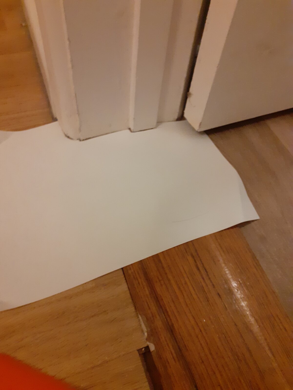

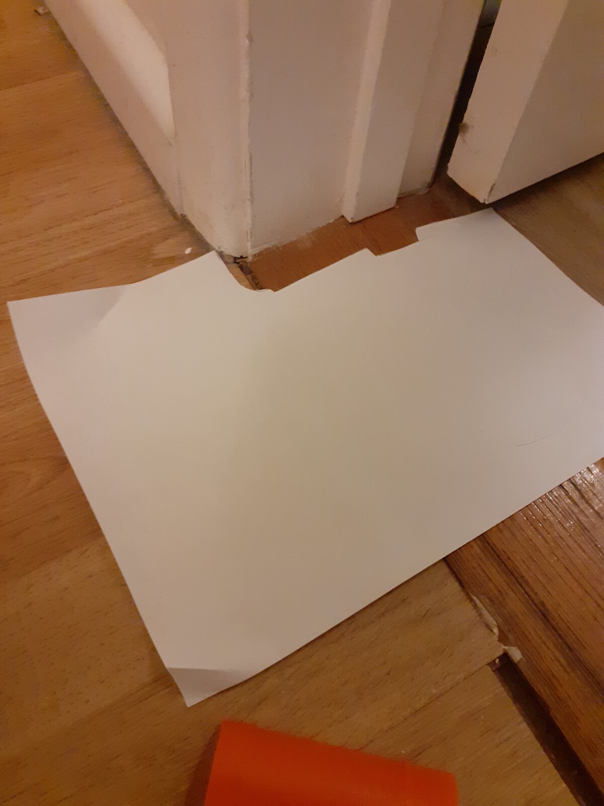

To make it sit around architrave do I scribe it I with pencil on a piece of baton?
I would lift the small bit first to check what is underneath, you do not want to go at it with a circular saw if you have Marley Thermoplastic (asbestos) tiles under there!(n)
If it is just wood floor under I would replace a small bit only, it can be secured with screws or nails rather than disturbing all the gripper rod.

I doubt asbestos. I think building is ten years old.
The wet part is falling apart so I guess just scrape or chisel that out to see what's under.

No leak. Water coming in from bathroom
Looks like sloppy use of bathroom leading to water running out of doorway.
The shower base has no depth to it and consequently the water rushes over the low entrance onto the floor then into bedroom.
Regarding floor

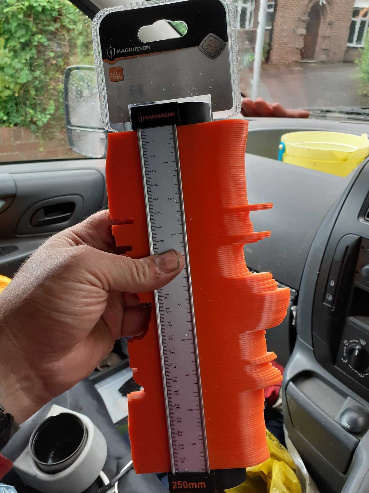

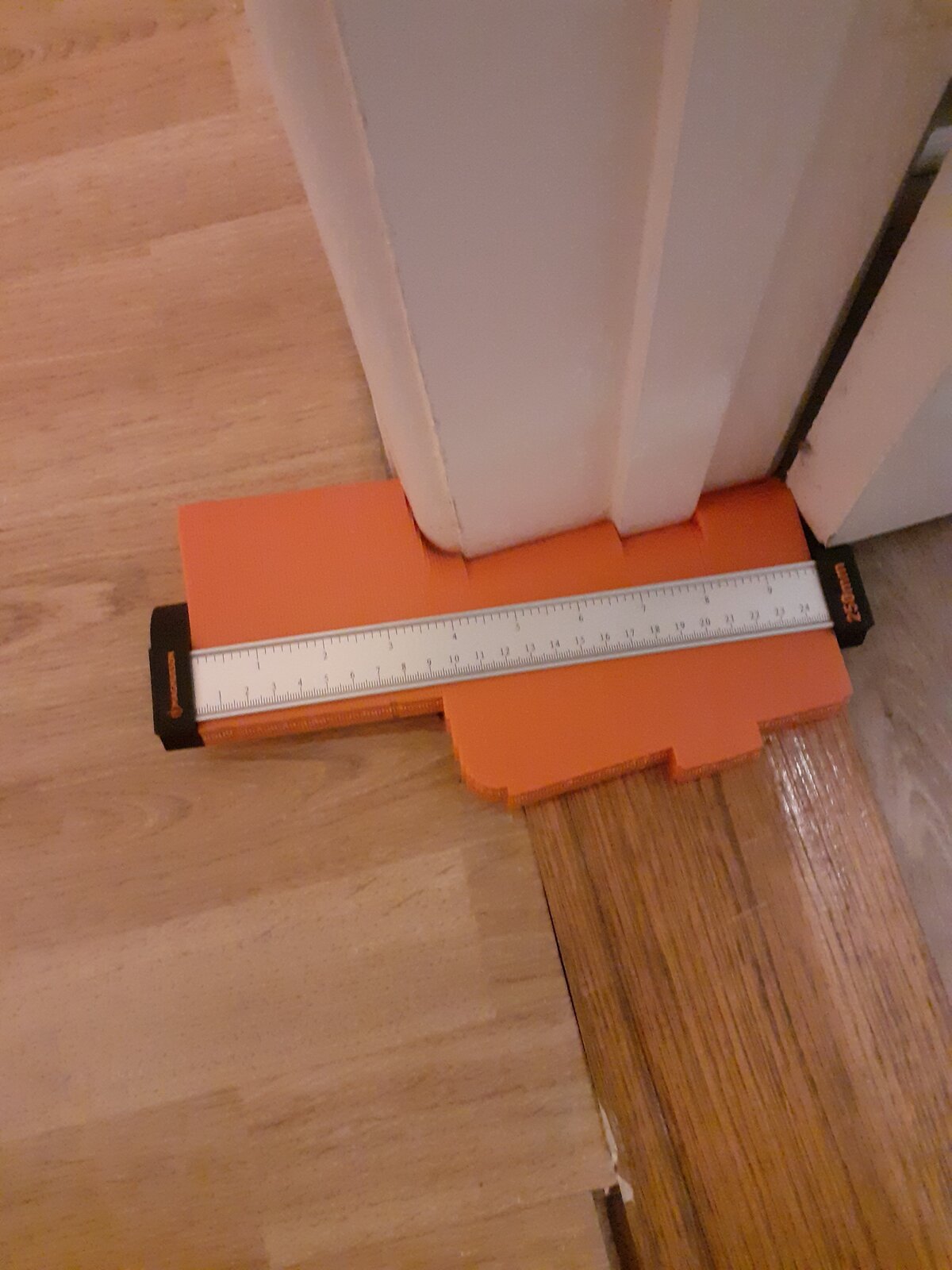

Gonna measure depth, probably 18mm chipboard will set circular saw to that depth and cut a straight line across two chipboard. Then using this scribing device to cut around architrave. I heard it each board needs to be over minimum three joists then screw down.
Main worry is pipes underneath.

Architrave is probably sitting on the boards, so you may well be able to slide it under. Then again, you might not be able to.

Either way I'll use my new toy to scribe it.
