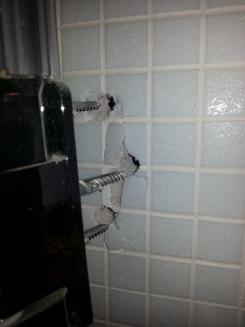

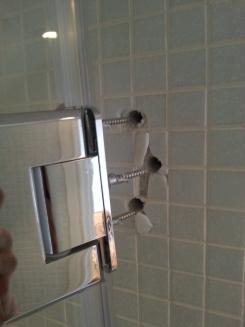

I came home to find my shower door has fallen off the wall. As you can see in the pictures it is a heavy glass door, and the wall is made of small tiles on plasterboard. It has to go back in the same place as before as it only just fits in under the sloping ceiling, but I'm not sure how to secure it in the same place where the big pulled-out holes are now..
How can I secure the door back in the same position so it will not fall again? Is there some strong filler material that I can fill the holes with and then redrill? What kind of plugs/screws should I use to get the strongest possible hold?
Any help much appreciated!
Thanks folks, much appreciated!
One thing I'm still not sure about though: Should I fill the ragged pulled-out holes first then drill new ones through the filler? Or just squirt resin in the ragged holes and put wall plugs in directly?
I.e. Right now I am thinking to do something like this:
1. fill in the ragged pulled-out holes with some kind of polyfilla,
2. Redrill holes of the right size in the same place.
3. Squirt some strong chemical resin in these new holes,
4. Hammer in good plugs i.e. fisher wall plugs
5. Wait for resin to dry (??)
6. Screw in the door hinges to the plugs (with hinges detached from the door? + with more resin between the hinge plate and the wall?)
7. Reattach door to the hinges(?)
... That sound roughly right?
Don't see how you can fill the holes as resin would just run away in the cavity.
A proper fix would be to remove tiles and plasterboard and install timber then re-instate wall and tile.
