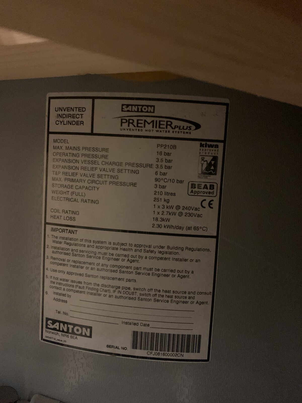

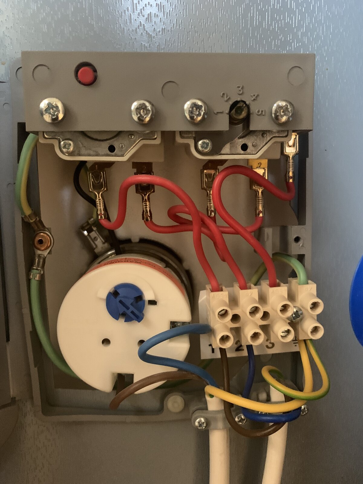

Hello. The water from my hot water taps is close to 70 C. I want to reduce this to nearer 60 C. I opened the panel on the hot water cylinder, but there are two dials. There’s one towards the top right that can be adjusted with a flat head screwdriver, and another blue dial towards the bottom left. Can somebody please tell me what each dial does? Which one controls the temperature?

There’s a couple of pictures with the cylinder details and control panel. It’s heated indirectly from a boiler downstairs.
I just wanted to lower the water temperature from taps slightly (but over 60C for legionella).

The adjustment at top right is for the stat to bring on the boiler. You might turn that a little anticlockwise.

I’ve adjusted the tap temperature now by turning the dial anticlockwise. The temperature was 68 and is now 62. Thanks for your help.

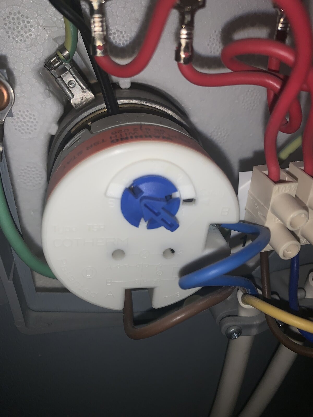

Still not sure what the blue dial pictured below is for. Might it determine how long hot water continues to be fed to the water cylinder after it has kicked in from the stat?
The blue knob is only to control the temperature the water reaches when you are heating it with electricity.
