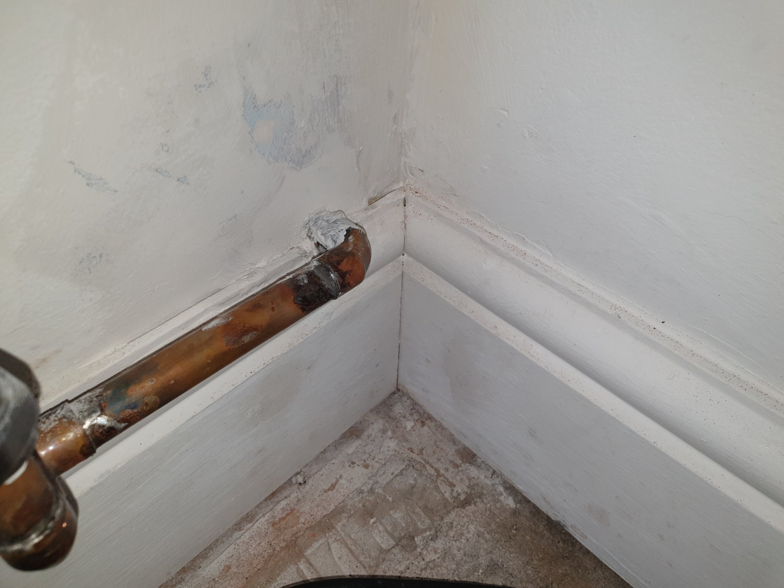

My builder's plumber accidentally removed the wrong radiator. We were due to have a new one anyway (at the time undecided) so I let him just cap it. Problem is I don't know how to get these off without cutting them.
What's the method?
Mike
Looks like Tectite Sprint and if so I don't think you can remove them without cutting them off.
+1 .... there isn't a removal tool for these that I have found, as there isn't enough space between the pipe and the fitting to push a tool in to force the grab ring teeth back. I use a dremel to cut vertically down in 2 places (could use a hacksaw) and then a small screwdriver to push the wedge up releasing the pipe.
