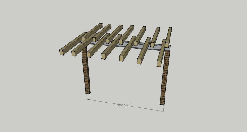

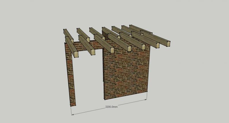

Hello All,
I'm a bit of a noob on the building forum and i just wondered if someone might advise me on the right way of how to remove a wall.
This is whats there at the moment:-
This is what I would like to happen:-
The floor above above this has just a stud wall deviding the bed room and bathroom, which doesn't even sit on top of the wall beneath, its offset about 500mm (ish)
I would think that it needs an RSJ to cover that span, but what dimension/depth would be needed?
Would i have to leave the (I think the're called) 'nibs' in place to give additional support? If so, how big do they need to be?

Size will depend on the load from the floors above, stud wall size/height, if the stud wall carries the roof above.. and the overall opening span..
But assuming its just floor and a none load bearing stud wall and maybe a bath then it should be an RSJ size rather than something beafy.
As far as nibs go well they depend on the walls adjacent and if they can support the load from the beam, if the walls are load bearing they this is not normally a problem.. consideration to overall lateral stability of the whole house is considered as well..
To get building regs youll need some calcs for the beam.. most competent builders will know a local structural engineer (hopefully a cheap one too) who can do the calcs for building regs.. this will normally involve a visit by the SE to measure up unless you can provide some solid plans for the house floor/floor

I spoke to a builder (neighbour, old hand been doing it for years, now semi-retired) who came round to have a look. He gave me an impression that it was a straight forward job, no planning permission required, just remember to double board it for fire damage prevention. I asked about stuctural calcs. He didn't seem to think that was so important and just recommended that a beam of 6"x4" section would be ample.

Occasionally the building inspector won't ask for calcs...but if they do and it fails it'll have to be replaced.

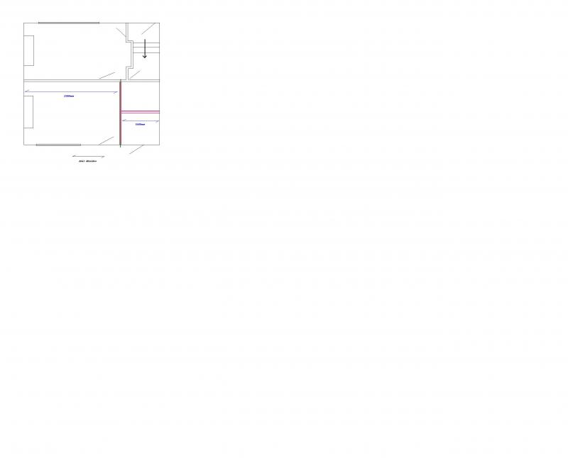

don't know what happened to this drawing? But anyway-
The wall/s to be removed, shown in purple.
Where RSJ is to sit, shown as a green line.
Span to the left, approx 2300mm
span to the right, approx 1500mm
BTW, i don't know if it makes any difference, but this is a semi and the joined house is to the left according to the sketch.
AFAICT, the stud partition above is not carrying any weight of the roof above that.
One thing i could have sketched, is the location f the bath, which is to the bottom right hand corner of the drawing
Wow you have a smaller bathroom than i do.. anyways your neighbour has given about the right size beam for those spans, assuming all info youve given to be correct.. and no roof/masonry loading.. (so if you downstand the beam to pick up a couple of brick courses may need a beafier one)
But i would also add that to comply with Building Regs any structural supporting members should be designed by a competent person and checked by BC.. I would recommend getting calcs done for this so the liability falls on anothers shoulders should anything go wrong..

Static means if you put the beam in below ceiling level, so that it ends up carrying brickwork as well as the joists above, you might need something a bit bigger.
I guess you're intending to get the beam tight to the ceiling though?

You're right, i hope to have the joists sitting direct to the rsj, no further bricks inbetween.
