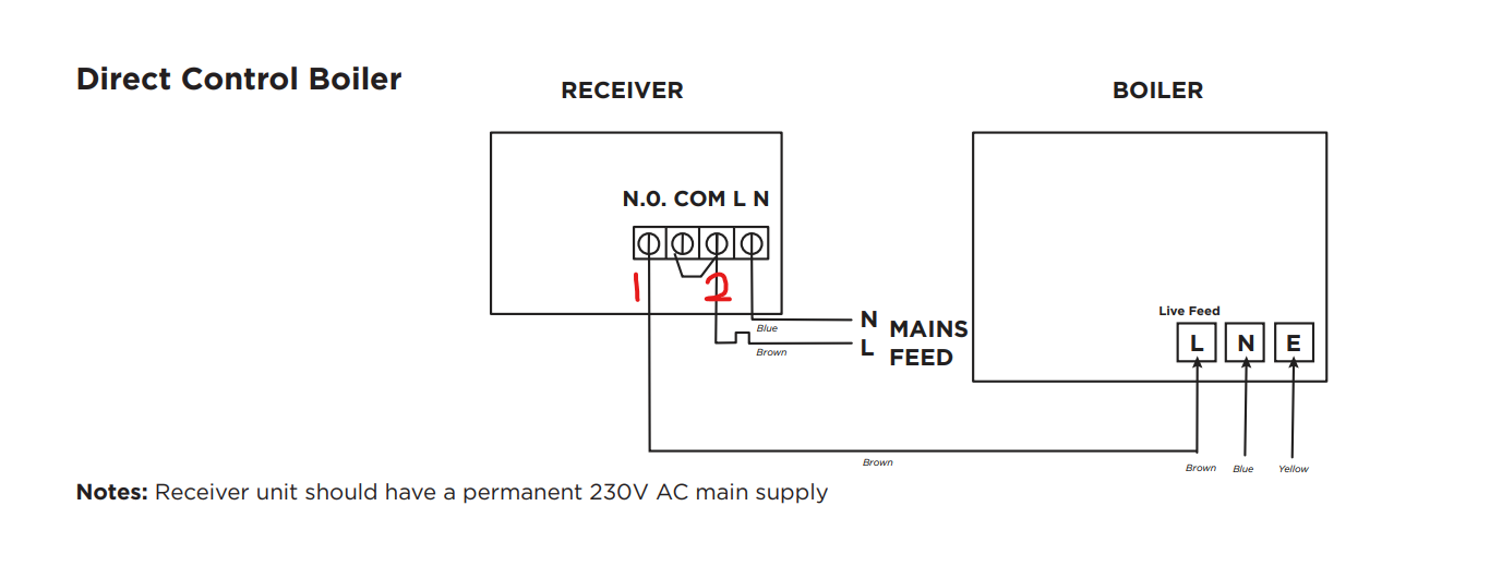

How to remove Boss thermostat from my timer
16 Nov 2022
2
Hi I need to remove my current Boss TPRSF31 reciever from my current configuration as I'm doing a self install on my Hive. The box is fine to stay on the wall I just need to know how to loop it out of the system if anyone can help?
Just join the live and switched live, which might be labelled Com and NO.
So disconnect highlighted wires 1 & 2 and join them directly together?
