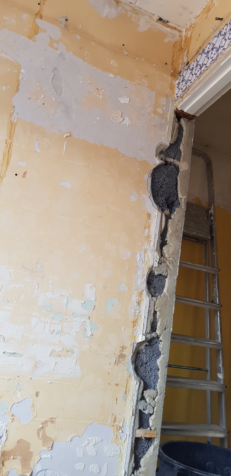

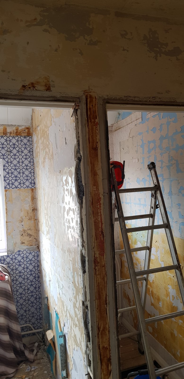

Hi, we have a wall separating our bathroom and toilet which we'd like to remove. However by doing so I'm afraid about losing support for the wall which has the doors. The house is 1950s and although the wall with the doors seems to be load bearing I can't see a lintel above the doors. I'm worried that removing the subdividing wall will mean the concrete bricks above the space between the current doors will cave. Can anyone advise?

Put a lintel in, that spans the two doors. In addition, fix two 100mm x 50mm timbers snug between the frames and tight against the new lintel.
Then knock the wall down.

I would cut away the wall from the door wall near the top then make good the door wall with a lintel as mentioned above.
The builder we got in wants to cut up until the last bit of brick (leaving a little bit) and then put in a stud frame to block the door. There's no lintel there already but the weight was resting on a wood frame. The builder is saying the stud wall will hold the weight. I am worried about how stable that little bit of brick will be

Remove some of the plaster above the doors to see if it is one lintel.
You will either have one lintel all the way across both doors, two separate lintels or just a lintel above one door.

Yes it supporting some weight from the attic. There's no lintel over either of the doors. Just the wood holding the weight that you can see in the picture

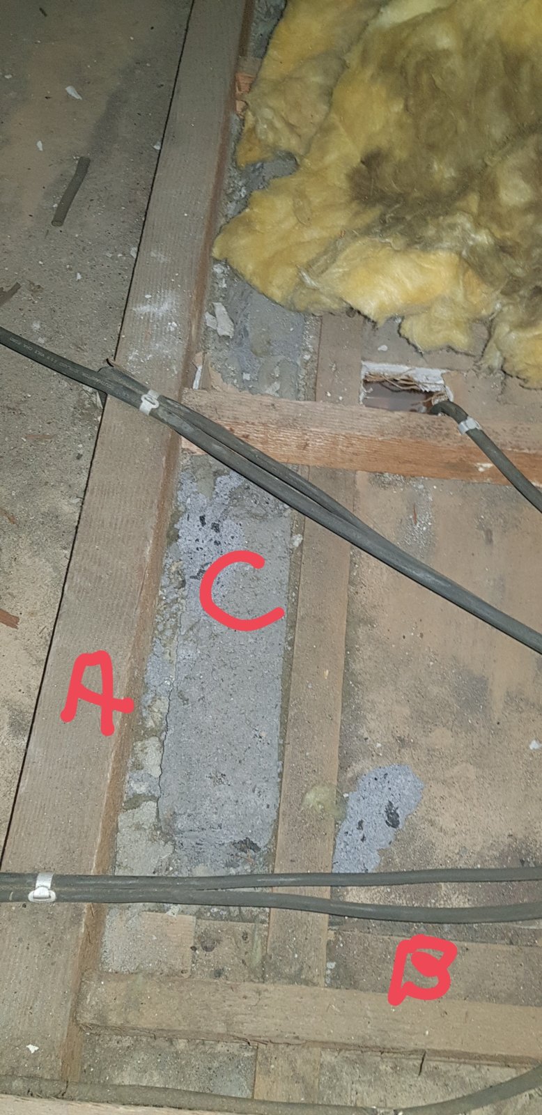

Sorry, so the load bearing wall rests directly on the floorboards (parallel) and the joists below (perpendicular) have trusses but there is no wall directly below on the ground floor. In the attic there is a joist resting on a plank of wood that sits on top of the wall (perpendicular). (See below picture). In the earliar picture you can see there are wood lintels over the doors.
The non load bearing brick wall that we want to knock down- This intersects the load bearing wall and forms the bit between the doors. This non load bearing wall sits on a plank that sits directly on the floorboards (perpendicular) with the joists below parallel. In the roof nothing is resting on this.
I attach a picture from the attic. A is the roof joist, B is the wood on top of the load bearing wall, C is the bricks from the non load bearing wall.
