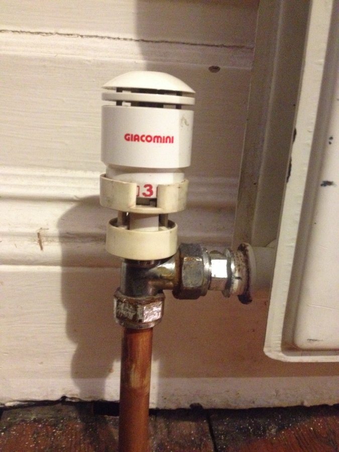

Hi,
One of my radiators is not working, completely cold while the others are blazing. I have read that this could be caused by the pin inside the valve being stuck. Unfortunately I cannot remove the old Giacomini head - does anyone know if there is a knack to doing so for this particular model? Pic attached
Pull the bottom locking ring up. Then you should be able to remove the head
