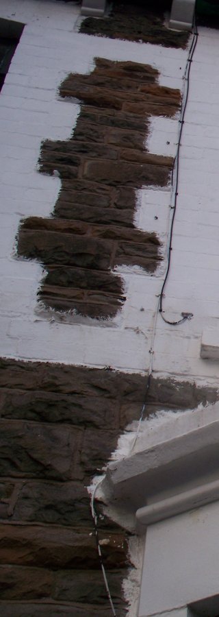

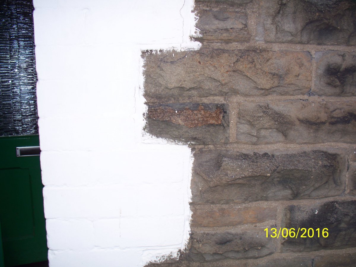

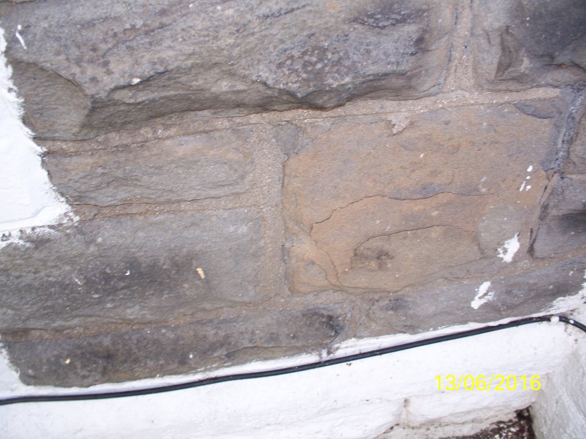

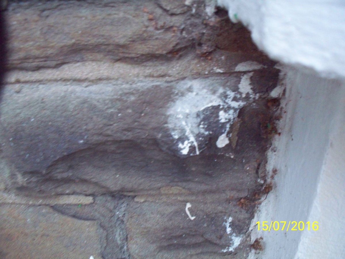

hello
to remove the white paint from the stone only[but not the brickwork],
can i use caustic soda, or other chemicals on this external wall?
and what type of stone is it? as im concerned about the alkaline or acid eating excessively into the mortar or stonework
the house is a 1920s terraced house [i did not do the 'interesting' paint job]
thanks

It's a dressed, blue/grey pennant sandstone - my house in Caerphilly is built from the same stuff, with red brick door and window surrounds.
Paint removal these days is a nightmare, but the weathered top layer of sandstone can be relatively soft and will often allow you to wire brush some of the paint away. You can even use a stone chisel to re-dress the edges where the paint has been 'applied' (I'm being polite there!), rather than stripping it.
If you do want to try stripping it, I wouldn't go with caustic soda because it can be hazardous when trying to work at height around all those intricate areas, as too can brick acid - you also have to ensure you safely rinse and remove residues. That said, the sandstone isn't really too sensitive to acid damage but you will find that, if the sections are successfully cleaned using that method, they will probably then appear a lot cleaner looking than the rest of the stone.
A liquid paint stripper with a stiff nylon bristled brush might be the better option, but it will be laborious task and will smear the paint around somewhat as you brush it off, so be prepared for a long job to get it looking good.
Sandblasting is a certain way to get rid of it, but you should get a professional company in to do that, as they will be able to use the correct medium for the job, without causing damage.
EDIT
If you can find a multi tool with some sort of rotating carbide bit (Dremel or such), that may work well on 'filing' the paint off. Over here, I can get carbide rotary rasp bits for a drill that would probably do the job well - you might find something like that would help, if available over there. (Not something I ever looked for.)

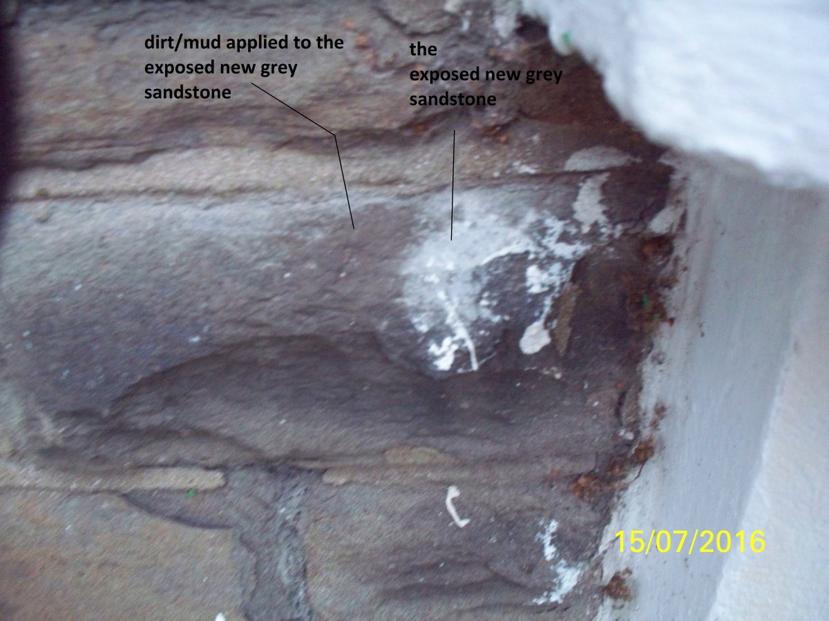

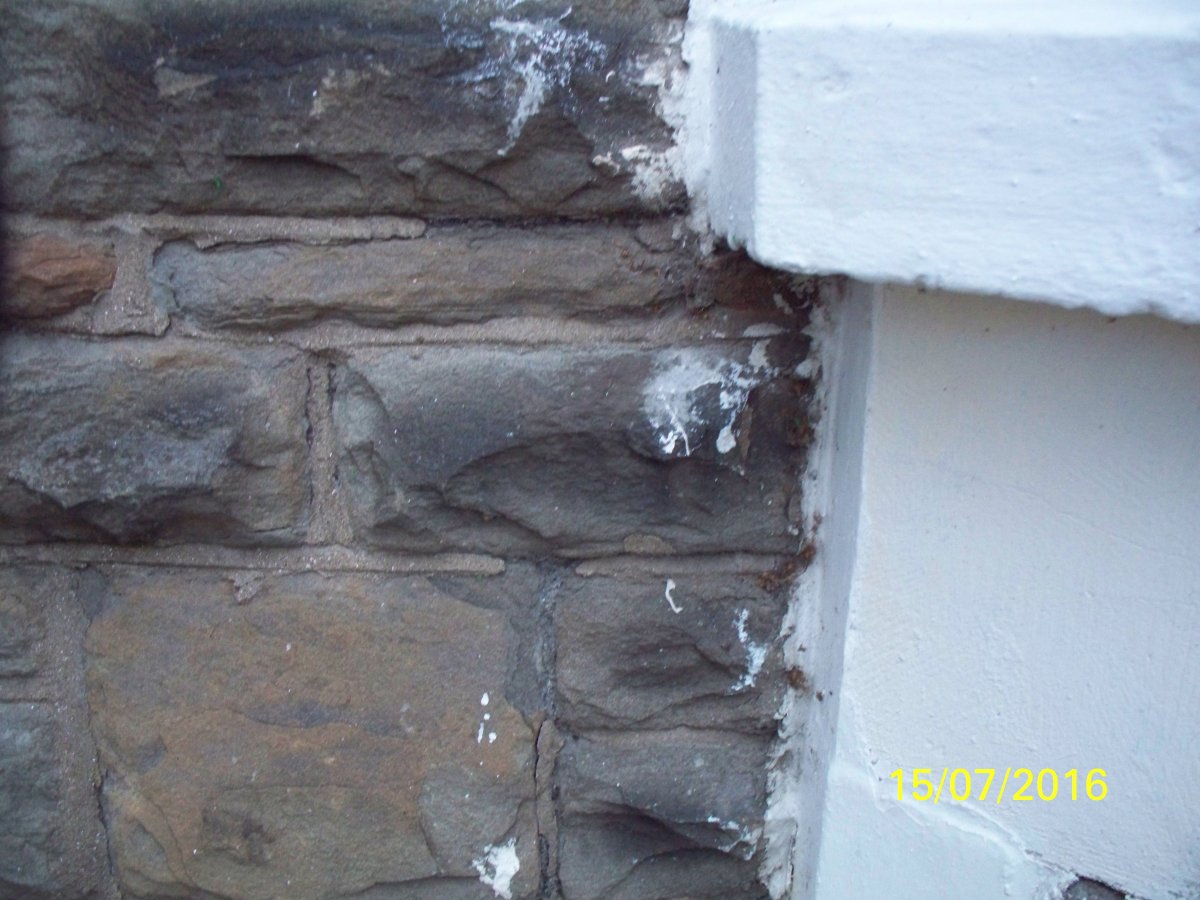

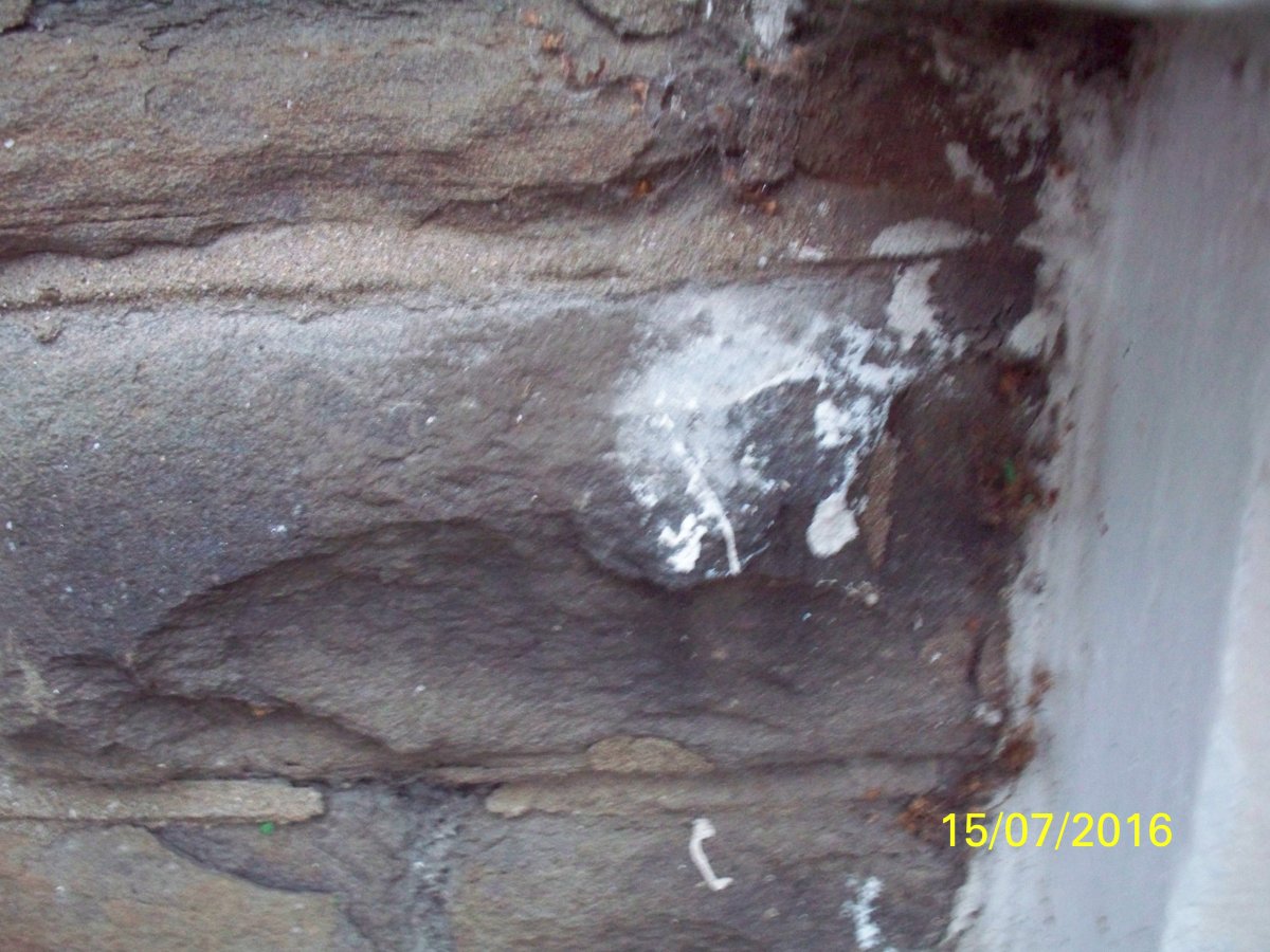

i did a test on the sandstone with a rotary-sanding drill bit on my drill.
the test worked fine, the paint came off easy. the exposed sandstone underneath appeared.
to colour-match the the exposed and weathered sandstone, i then rubbed dirt on part of the exposed area. see photo oufr1.
it seems to reasonably colour match.
my question:
1.
how do you [or others reading] colour-match exposed and weathered sandstone?
2. does the sandstone need to be sealed after being exposed to protect it[ive go Everbuild 402 pavement waterseal], or should it be left to breathe?

You don't really want to seal the stone, so I would avoid going down that road.
As for ageing it to match, you could try dabbing on a very thin layer of paste made from natural yogurt and soil with a small paintbrush. The soil will colour it slightly and the yogurt will then allow microorganisms to grow on the 'clean' areas. It is what people do to age stone flower pots, etc, and does work pretty well but I can't say that it's something I've ever done on the kind of job you have.
