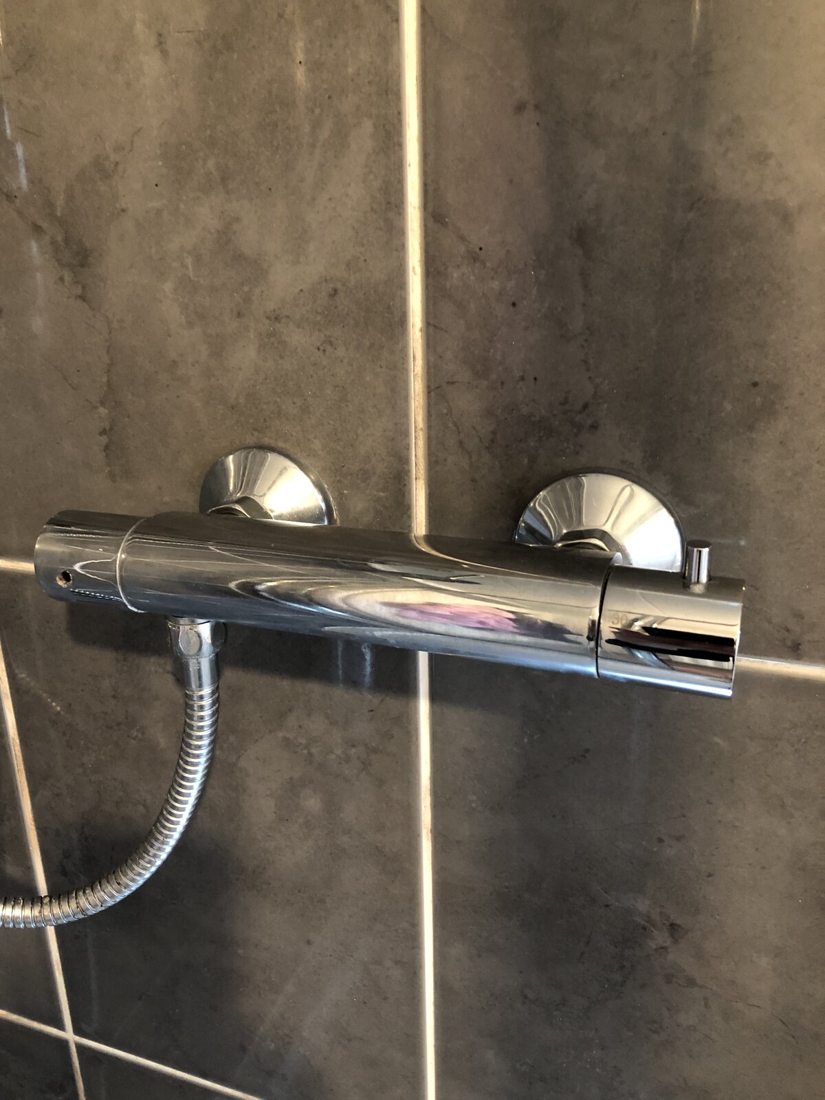

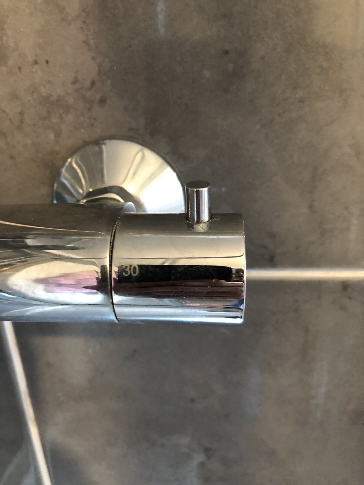

Hi There, I am having temperature problems with my Shower unit. The Shower is about 15 years old and has no makers name either on the Shower valve or the purchasing documents.

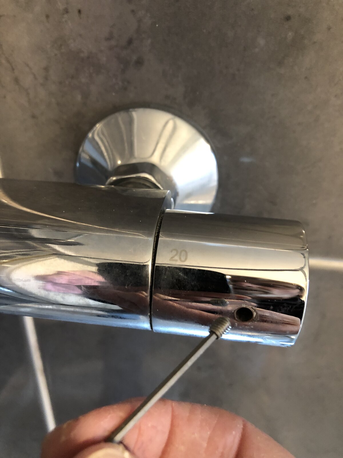

I have attempted to remove the cartridge with the aim to replace it or clean out the void.

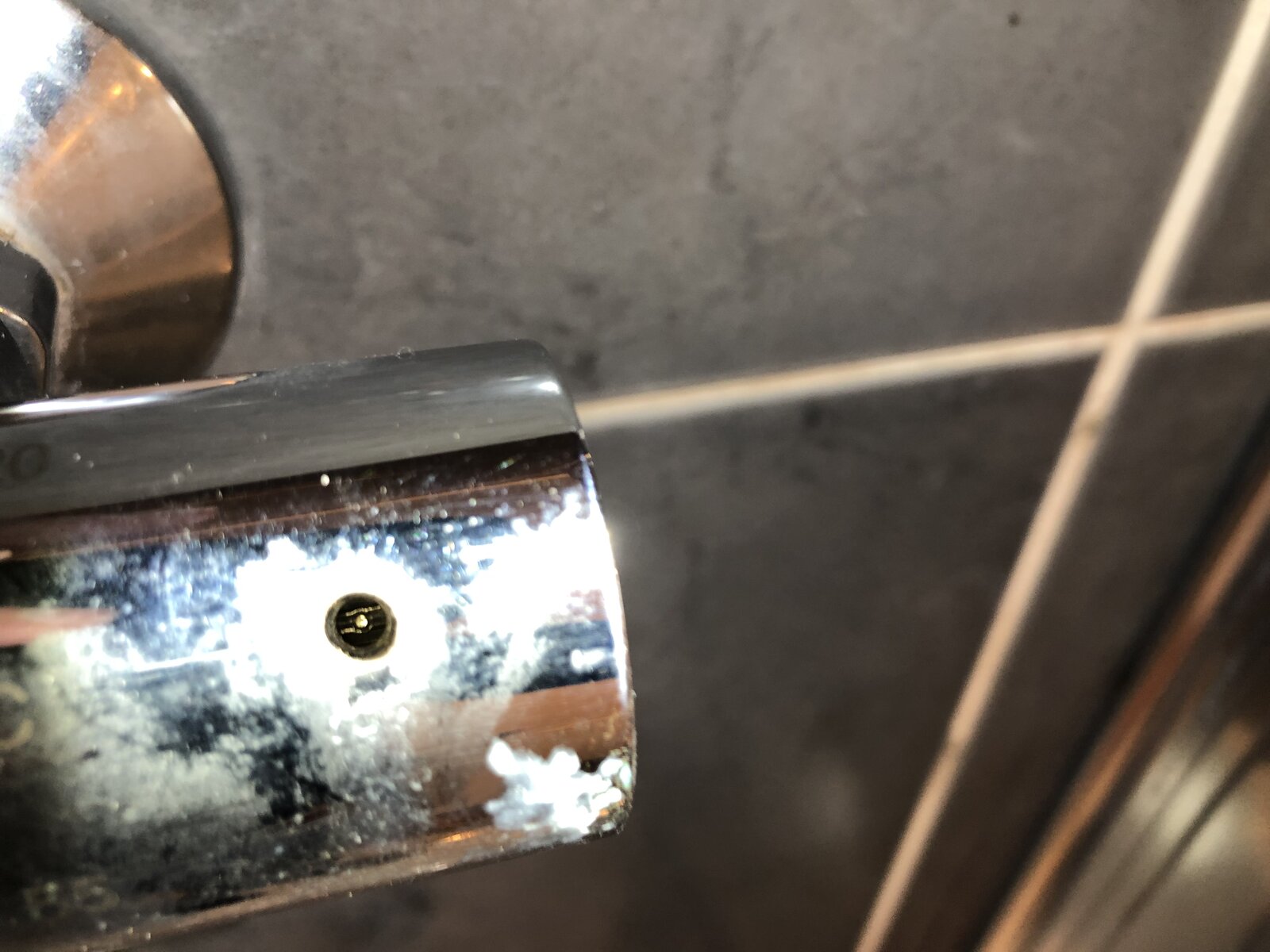

I have removed the grub screw in the hole opposite the pillar/handle on the temperature control side. I thought the adjustment handle would screw out (to reveal another grub screw) but it doesn't seem to want to move and I don't want to put undue pressure on it.
There doesn't seem to be any other hole ( e.g. on the underneath of the main body. The end bit is now sort of loose but is still being restrained.
Can anyone help me please. I have attached photos to help.
Many Thanks, Keith
