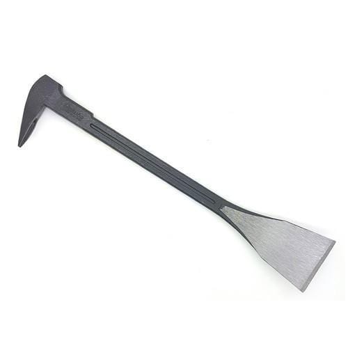

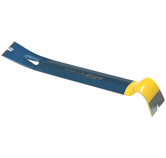

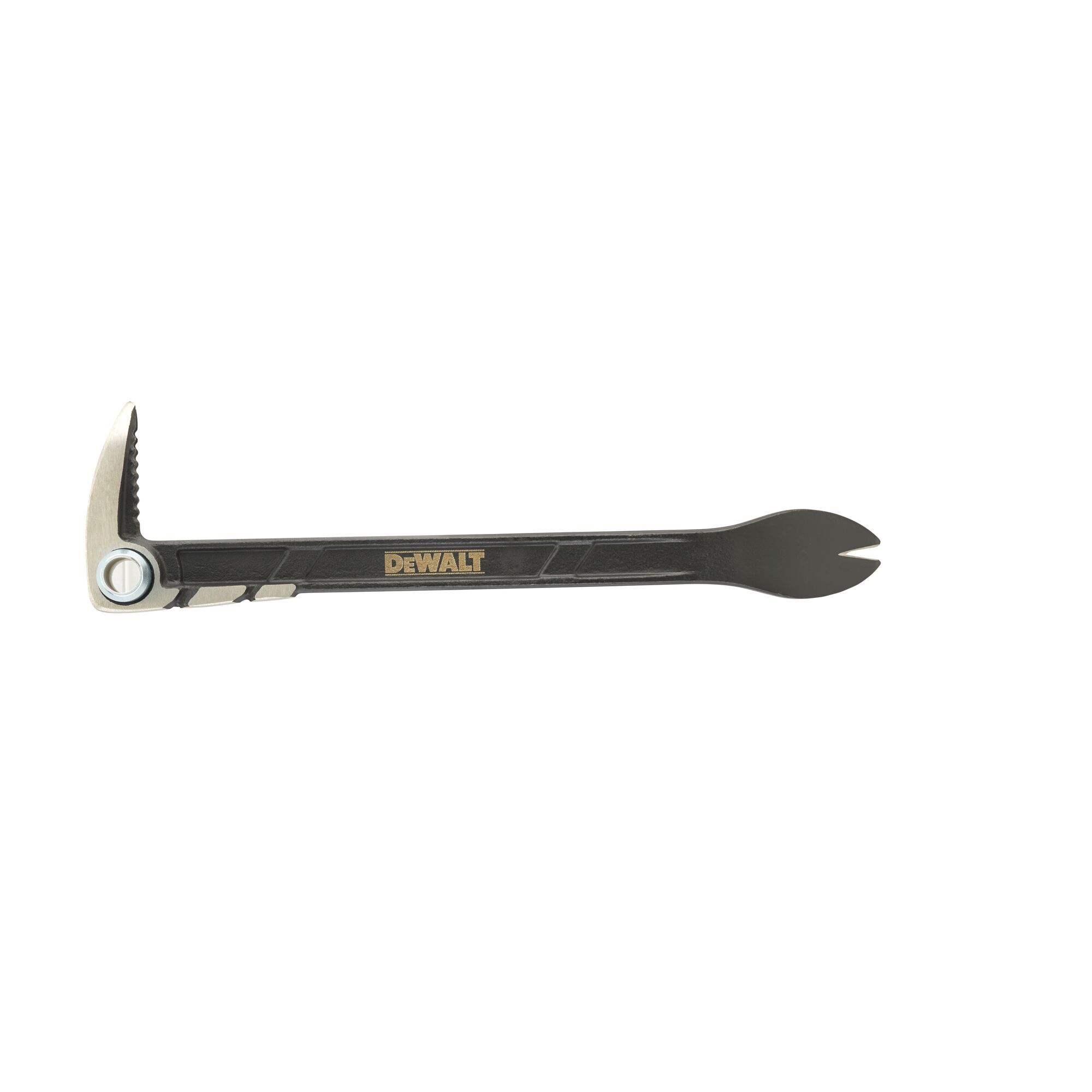

TBH rather than trying to dig out nails with a nail bar, which invariably damages the items you are trying to dismantle, and sometomes quite badly (at least if the nail heads are sunk under), I find it's better to use an old chisel or a flat bar such as this:
Or a furniture restorers bar:
Or even a beekeper's pry bar which are very thin) to separate the joint between the timber batten(s) and the plywood. If the chisel end of the bar is hammered into the joint near to a nail it is often possible to spring the joint and loosen the nails which can then be removed using a pair of carpenters nippers - or a nail bar. I mainly work on listed buildings these days and you simply wouldn't use a nail bar alone to remove nails unless the nail heads were already proud of the material. So not really a fan of those little nail barrs because I've seen the damage they can do

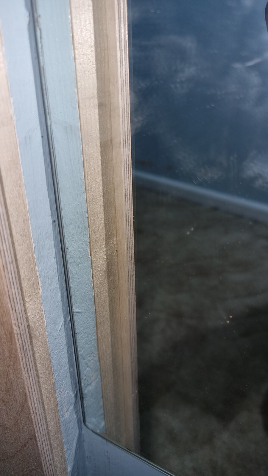

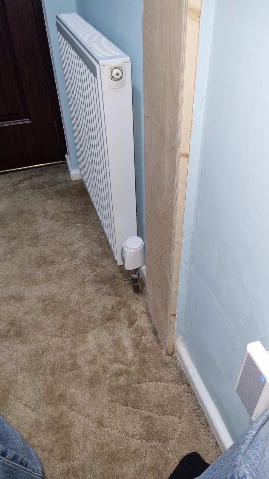

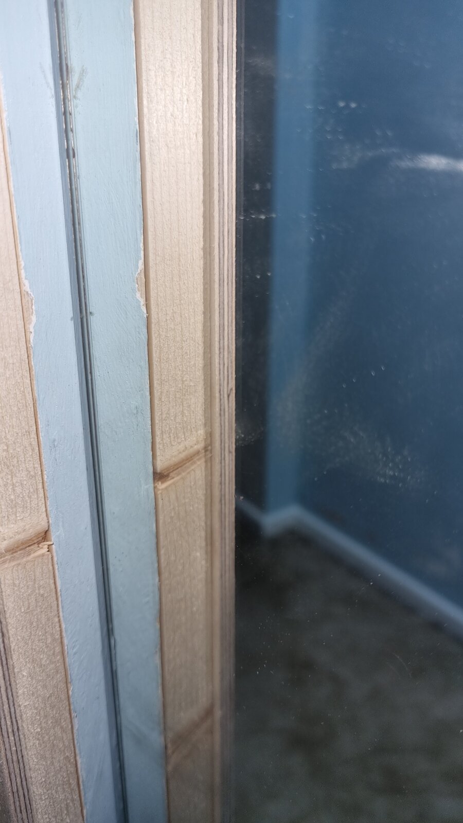

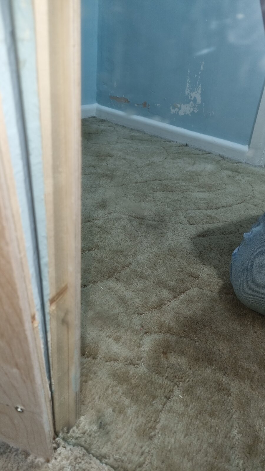

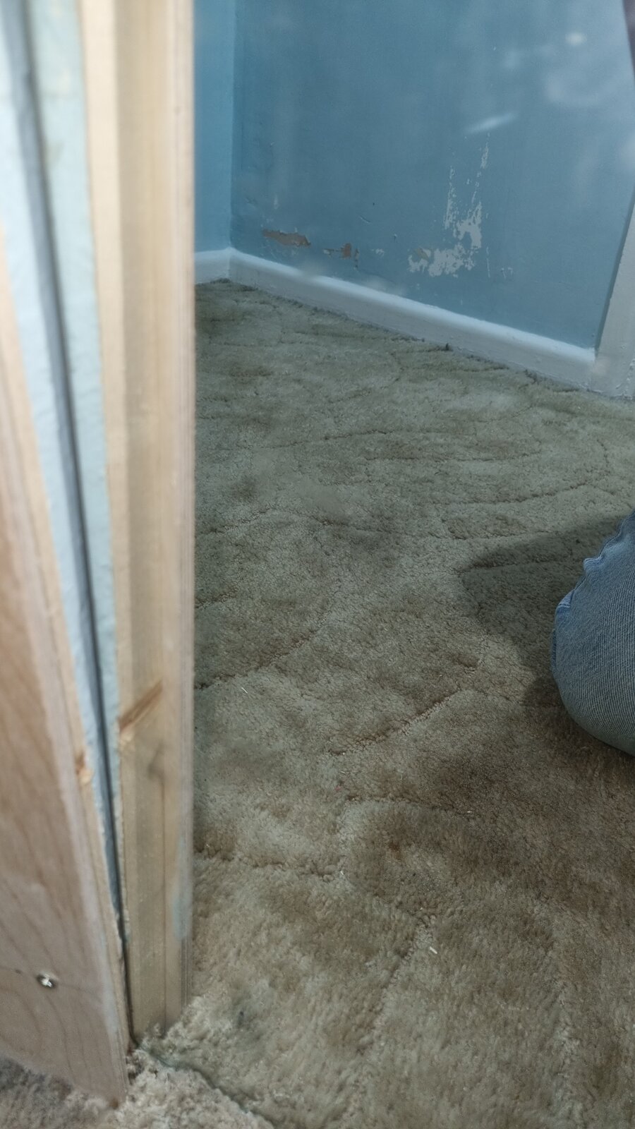

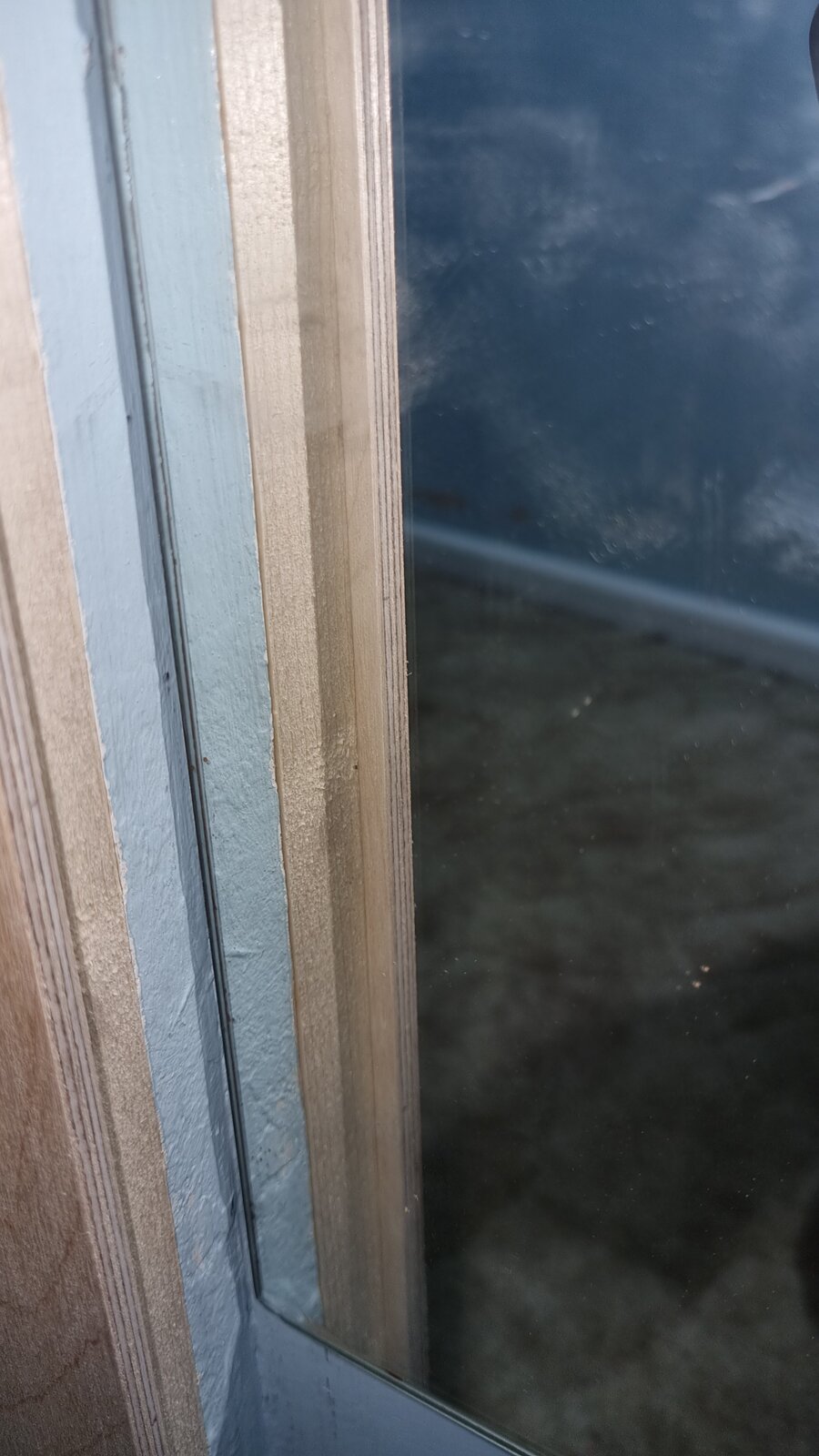

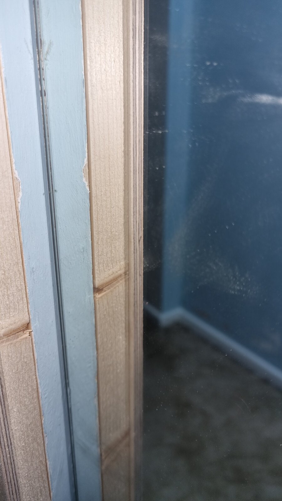

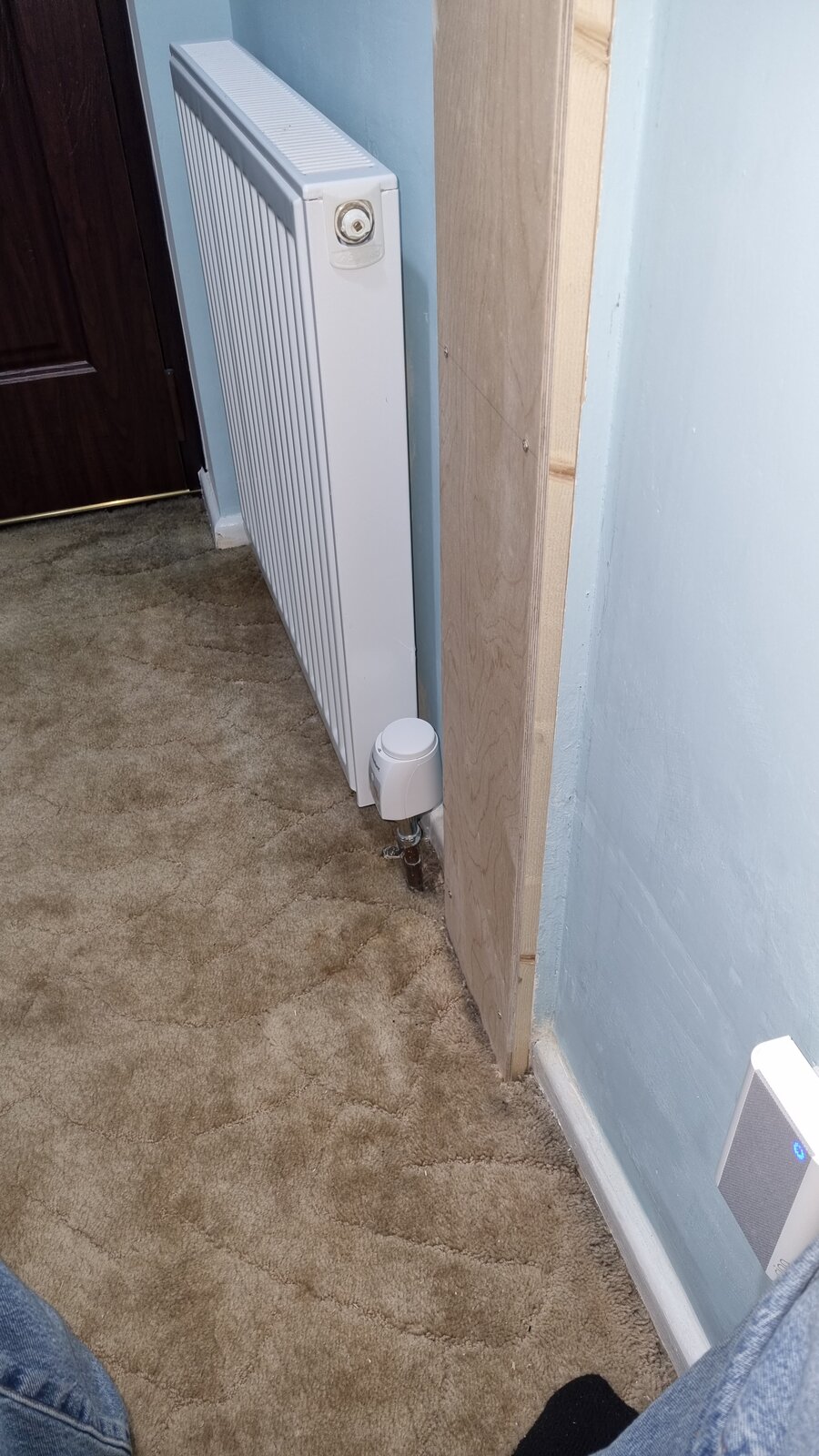

One Question I have though is how to Reduce the Width of the 6mm Plywood Cover from approximately 1m from the Bottom Down as it is slightly Wider in that section and Overhangs.
Can 6mm Plywood be Planed, or, Sanded to take off approximately 5mm?
What would be the best solution?
Thanks in advance
Kevin
Hello
I can but it will be difficult to see the Overlap as I am not able to get the Phone behind it due to lack of space.
The First Image is from the Side.
Some lateral Thinking later, the Last Three Images are taken through a Mirror, hopefully you are able to see the Overhang.
Kevin

Assuming your toolbox is at basic DIY level, i.e. you have a wood saw, but not a circ saw, planer, table saw, multi tool, jigsaw or grinder with flap wheels etc
Run a pencil up the back so a line is drawn of where you will need to trim
Unscrew the panel
Find another bit of wood you don't mind sacrificing and screw the marked panel to it through the existing screw holes so the sacrificial wood sticks out beyond the edge you wish to cut
Cut through both using a basic wood saw; the sacrificial wood will keep the saw running down the edge of the wood you're keeping
If your toolbox is a bit more extensive, then it would be quicker and easier to use eg a multi tool or jigsaw with a fine toothed blade, or a grinder with a flap wheel to sand the 5mm away to nothing. You could use it as the excuse to start upgrading your toolkit :) - mains AC versions of tools from brands like Titan (Scrwfix's own brand) are typically quite good value for money and if you find yourself wanting to do more, then invest in cordless tools later.
