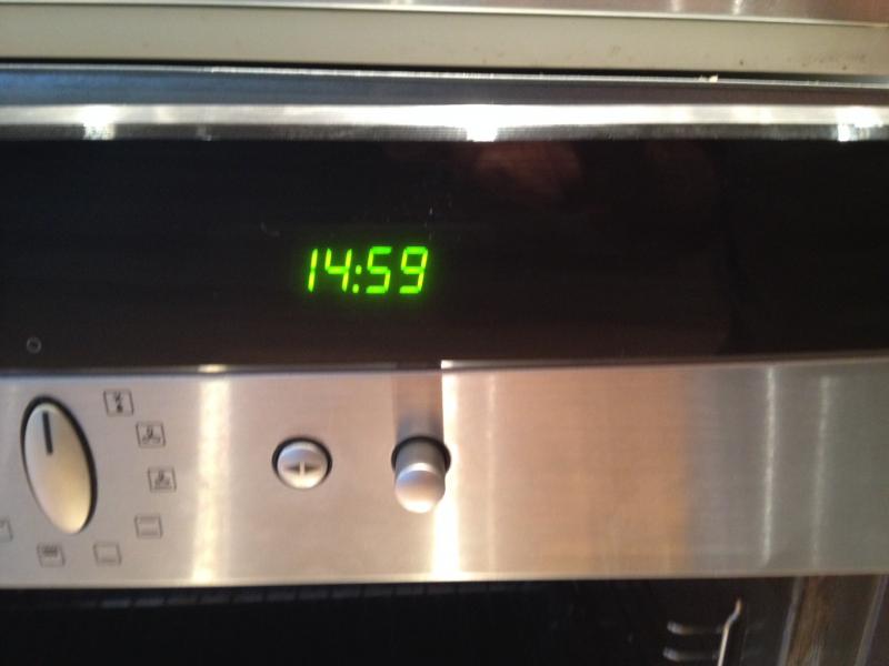

The timer spinning button on my oven is not working (right hand one on the picture below).
Unfortnately it seems impossible to pinch and take it out in order to replace so I took the oven out and removed the panel but it looks like the button is attached to the circuit board and i'm not sure how to remove it.
Neff are selling these spinning button seperately so there must be a way to replace it without replacing the whole board.
Pictures attached to explain this issue better, any thought is welcome
If the button is bust then it needs to be desoldered from the PCB and a new one soldered in its place.
IMO there is no need to replace the whole board just for a button but it depends upon your ability to desolder/solder or find someone who can (and I mean do it well, not some cowboy with a 50w 32.50 iron).
Hummm that rules myself out :)
But the replacement one doesn't come with the back pins so I wouldn't have thought that what you are suggesting would be required...
