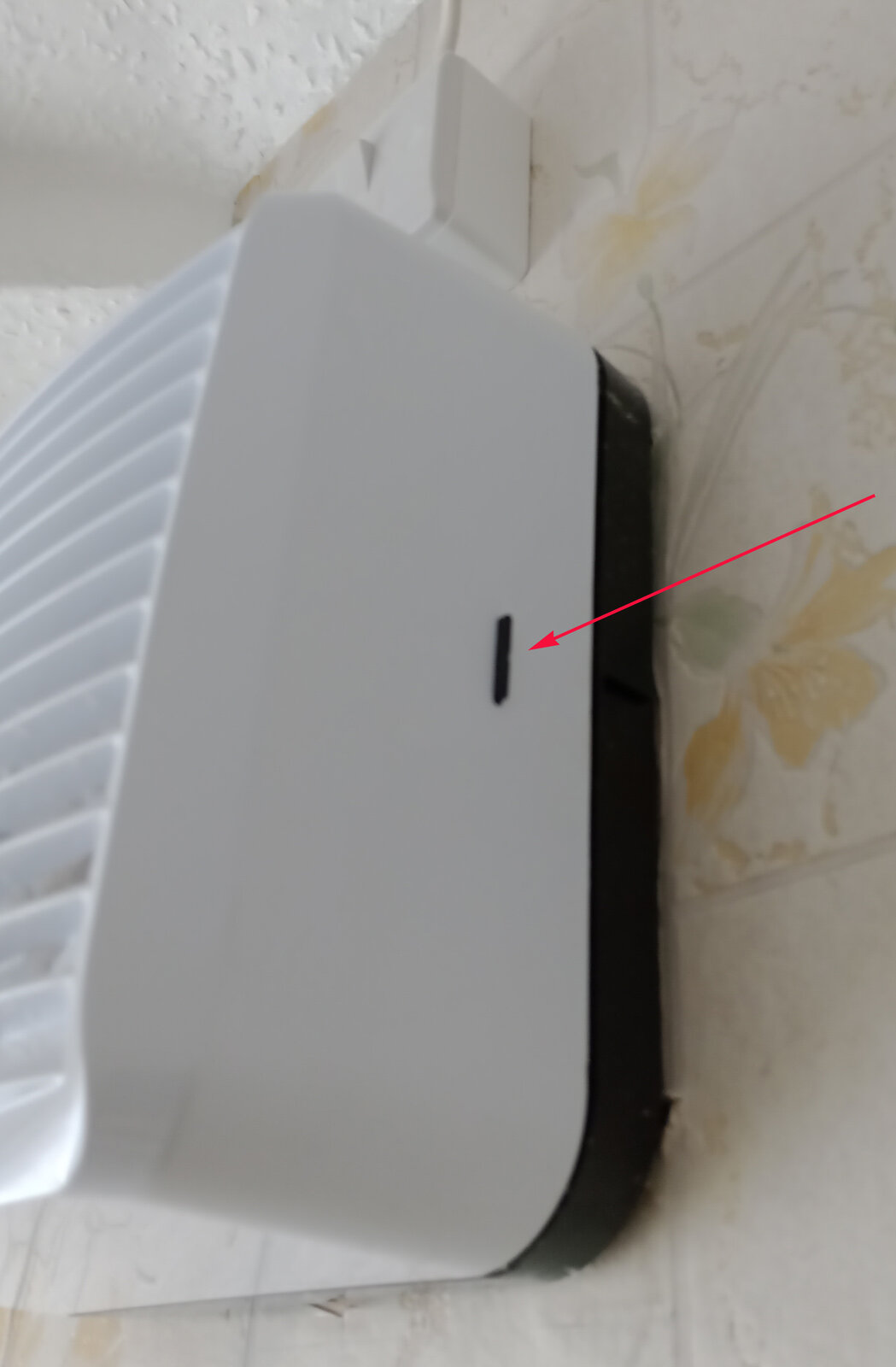

Hello: I know, in a theoretical way, to remove the cover of this fan (it is an "Expelair GXC6EC kitchen fan with pull-cord"). However, to actually do it is proving impossible for me. In the photograph I posted here, the spring-loaded pressure buttons can be seen clearly, and anyone might think, "What's the problem? Just press them in — on both sides. Keep them pressed, and pull the cover off, stupid!"
Well, to get at the fan (which is fairly high up the kitchen wall) I must use a step-ladder and stand on nearly the top step, which is rather precarious for a two-handed job. Even if pressing catches worked as they are surely intended to, there is a risk of the cover coming off suddenly, and me going backwards off the step-ladder (I am in my nineties and reasonably fit, but my balance is not as good as it used to be). My fear arises because I tried, more than once, to press these two catches in and release the cover. I pressed them in, but the cover simply would not come off. At first, this may have been because I pressed so hard that my fingers touched the sides of the cover, and pressed those in also. However, no matter how carefully I pressed, the cover would not budge. So, is there anything else that should be done, that I have not done?
In the bathroom of our house is another fan, exactly like the one in the kitchen. I tried pressing the catches on the sides of this fan too, but even the catches seemed not to budge. I can't think why they should be different from the ones on the kitchen fan.
So, the problem remains: how to safely (in view of being up a ladder) get the cover off? All and any replies would be appreciated.

Perhaps you need to push a flat bladed implement ( screwdriver) into those slots, Luke?
For heavens sake, stay lucky and get someone to give you a hand!!

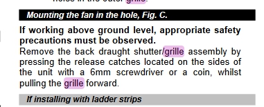

That's the right way to go John, from the manual:

Thanks for that, fellas (this includes Burnerman). However, I don't see how it's possible to press on both catches AND pull the cover off at the same time. (There is only one pair of hands available.) With regard to getting help, circumstances would make this very difficult, unless I paid a tradesman. However, I certainly will take great care. Perhaps one catch at a time would allow it to be moved forward (slightly) on one side, then one the other. I shall try that.

Normally with these pesky type of things you can either do one at a time as you say or kind of use your palms to pull on the grille whilst using your fingers for the coin/screwdriver etc.
Maybe you could push a lolly stick or something into the slots, which will allow the cover to release from the bottom?

Sometimes you can pop one side, then shove something between the body and wall before attacking the other side.
It shouldn’t suddenly pop off.

It might be a bit sticky with grease.
They are awkward rather than requiring a severe tug.
