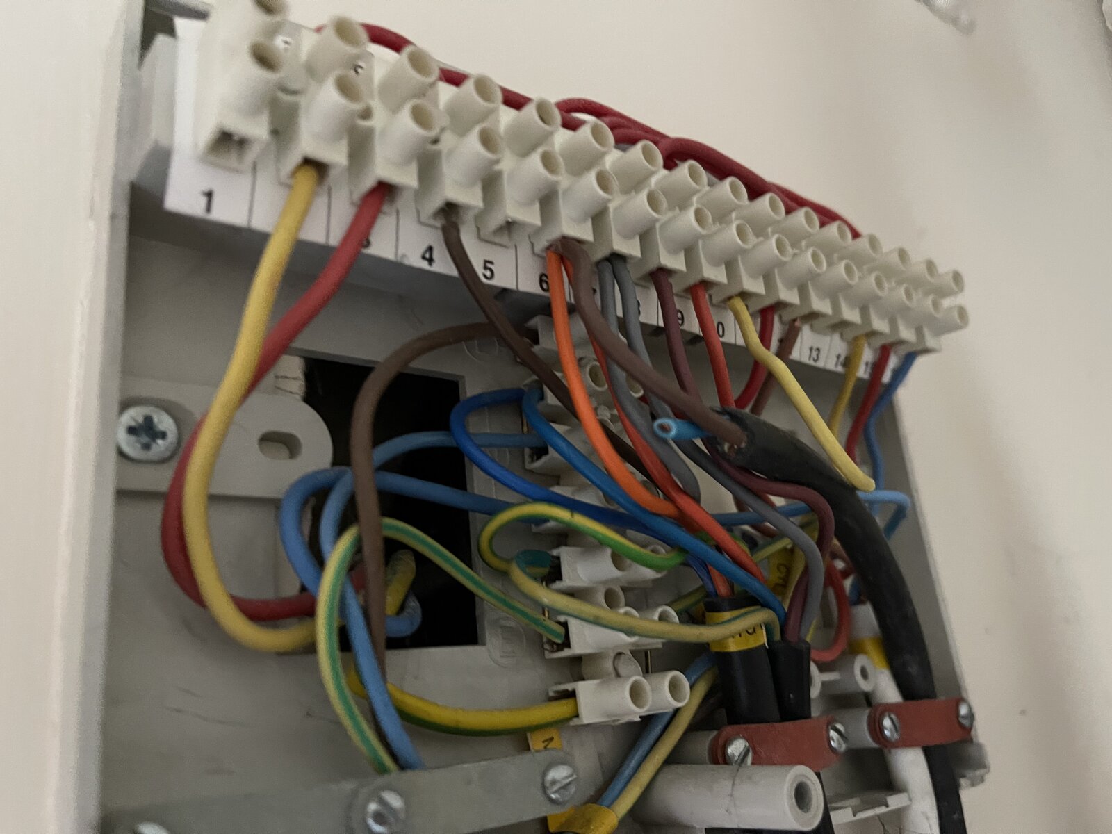

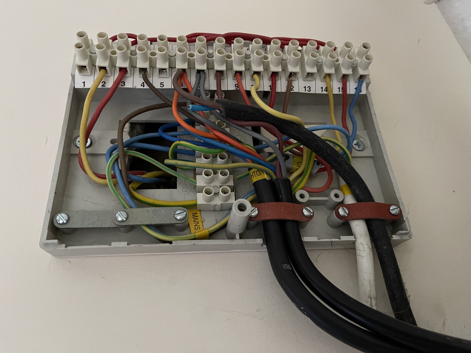

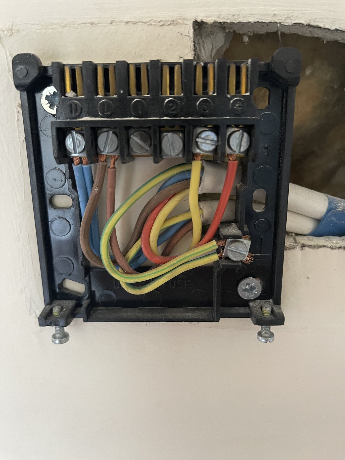

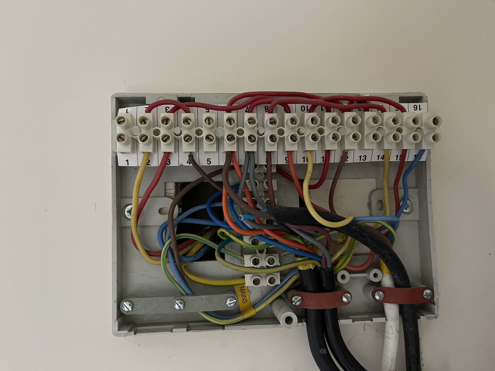

Hi

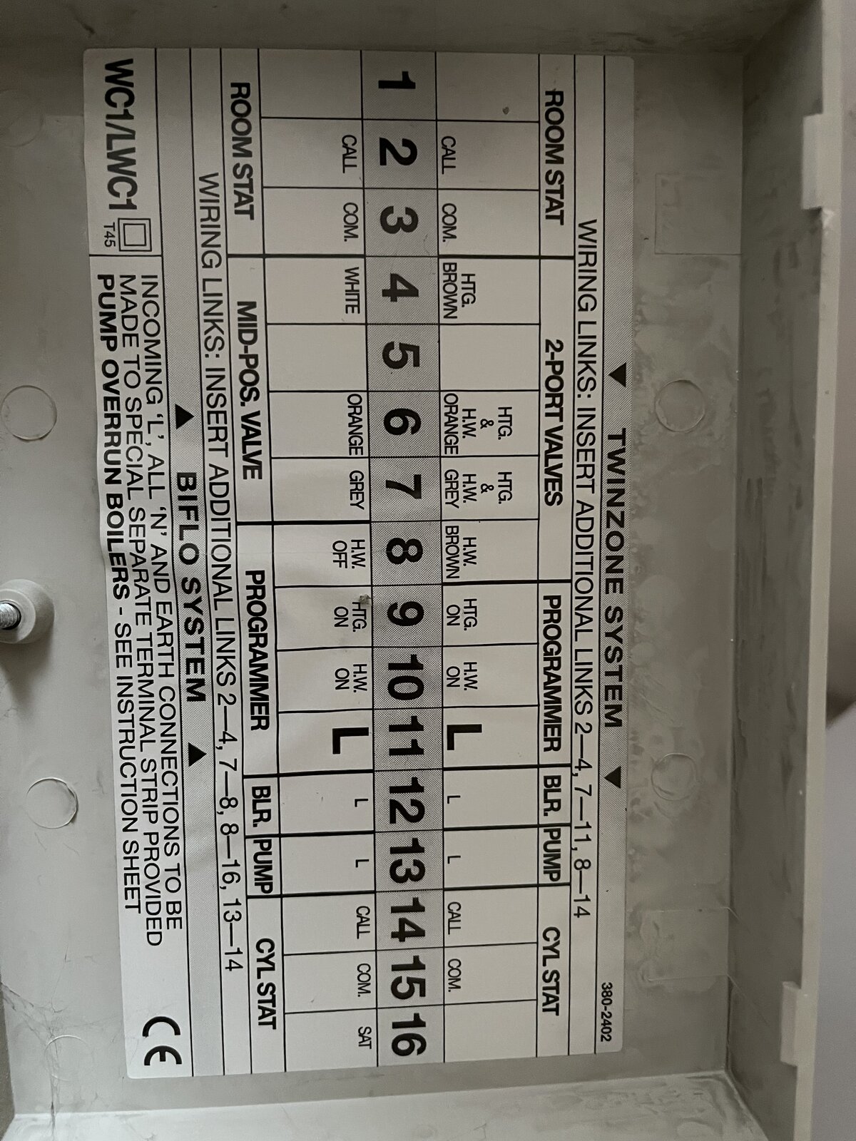

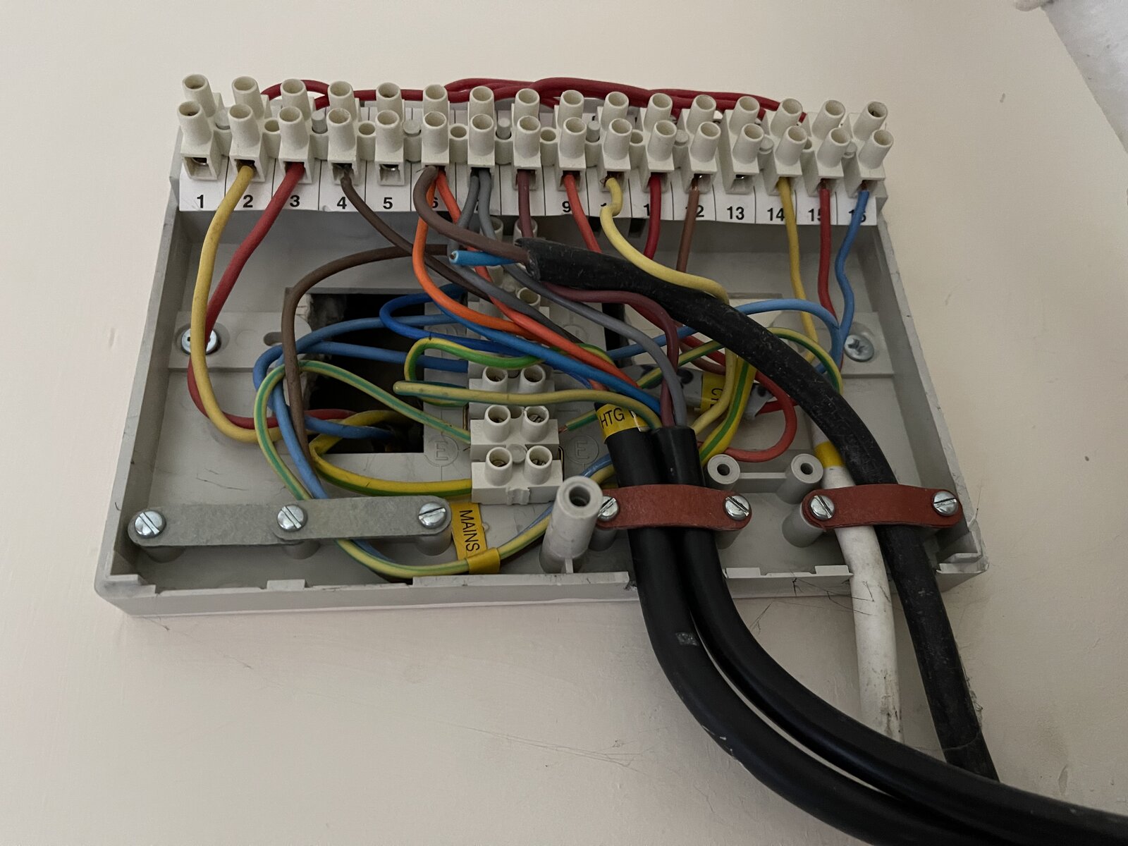

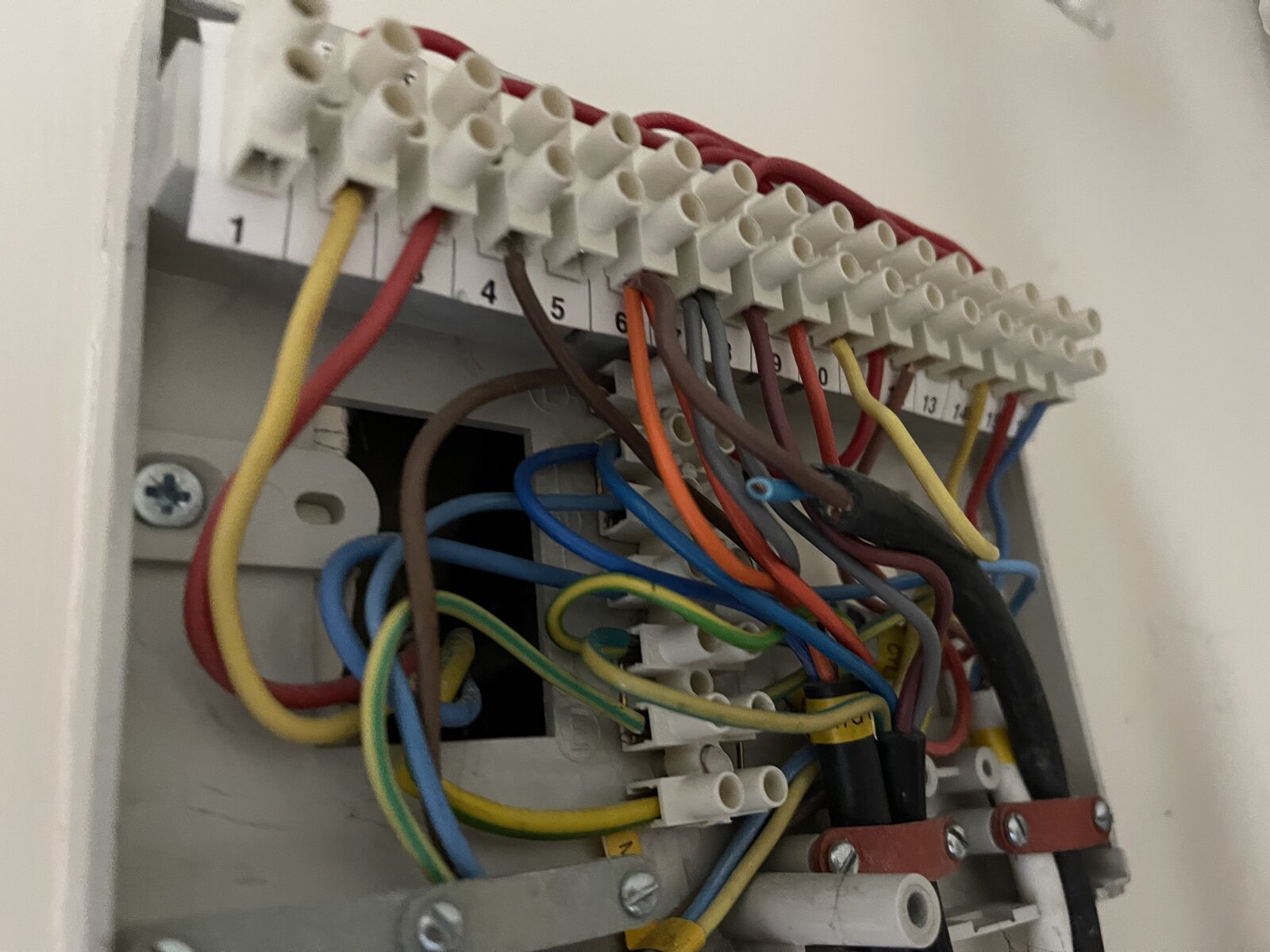

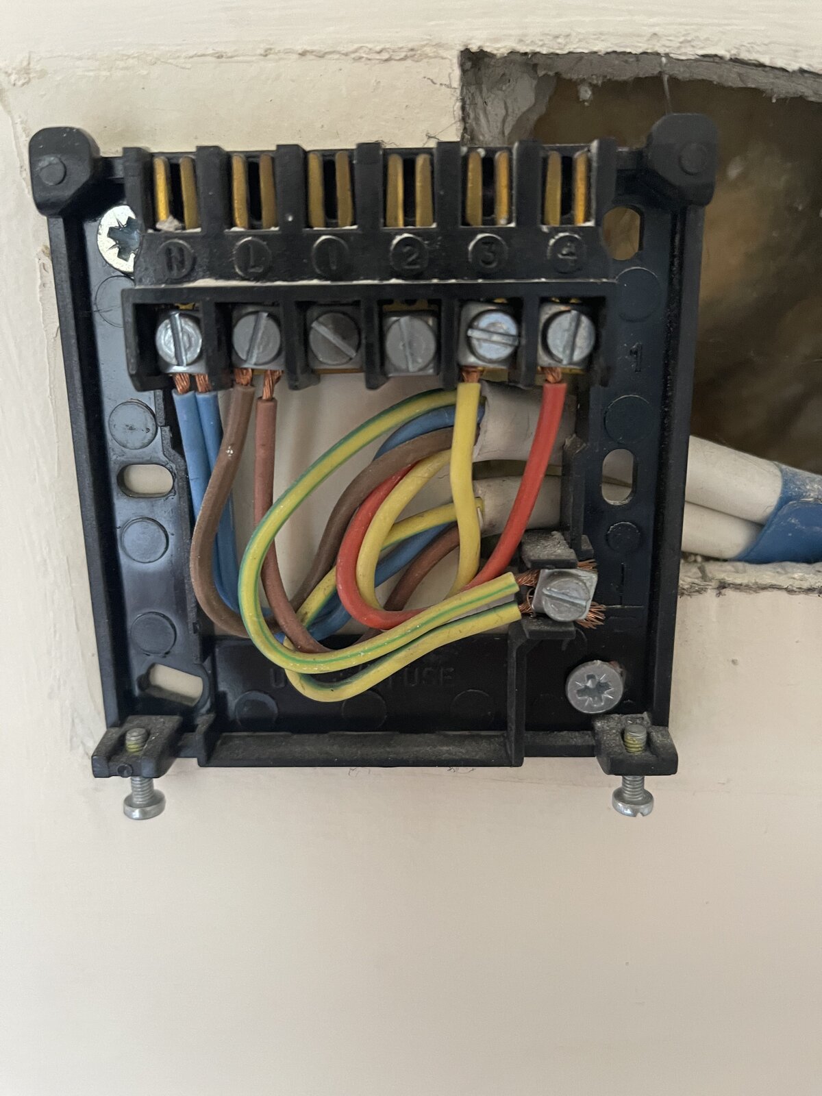

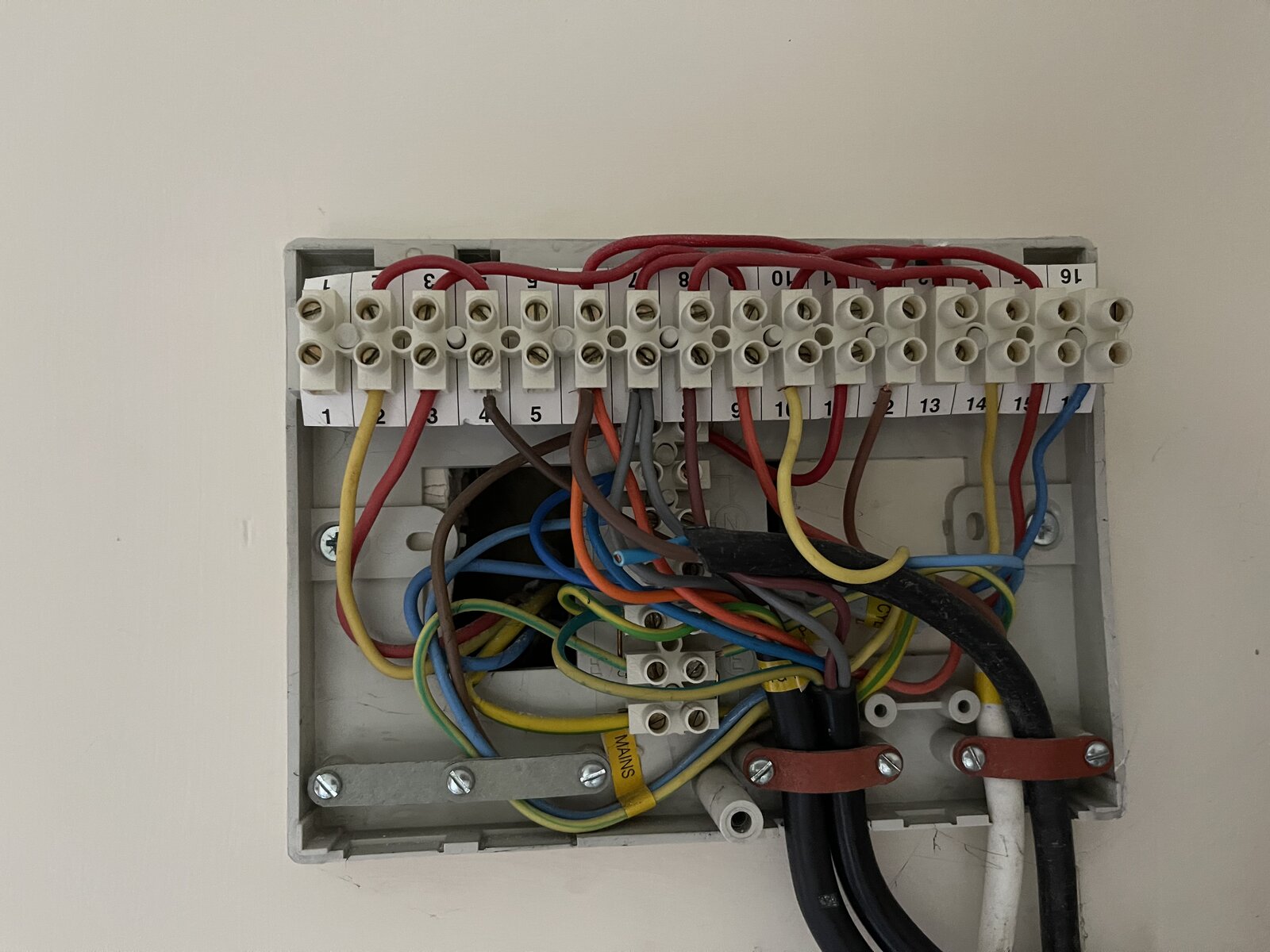

I have an existing Drayton wall thermostat , which I need to remove as I have a Hive thermostat to install. There are the 3 wires coming from the backplate of the thermostat.
live goes to bottom of 3 in the wiring centre, wire 3 on thermostat goes to bottom of 2 in wiring centre.
The top number 2 wire in wiring centre goes into the top of number 4 wire in top of wiring centre
The top number of 3 wire goes to the top of 9 in the wiring centre.
9 is heating on
my question is do I simply remove the thermostat wires and bridge 9 to 4 across the top in the wiring centre?

Yes join the brown of the valve to the programmer call for heating.

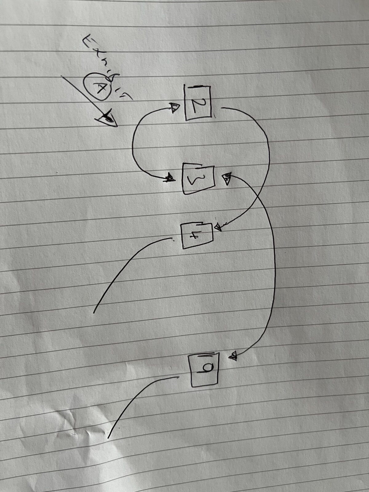

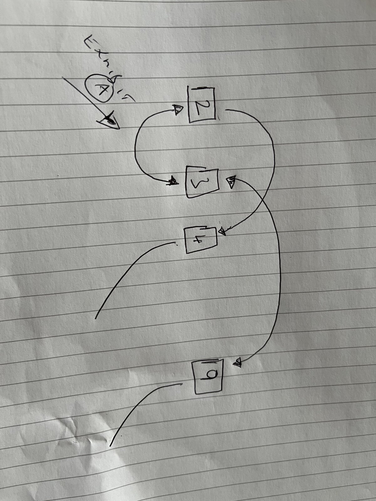

Hi ,sorry I’ve been away! so I’ve shown in the drawing what I’ll do , basically Exhibit A connect 2 and 3 with small cable , correct? :) last time I post a question - the next post will be a success story!
@CHRIS19876 - having revisited this’ll, I’ve realised, yes you should remove the bottom wires, otherwise they will be live the other end.
Yes, looks ok to me.
