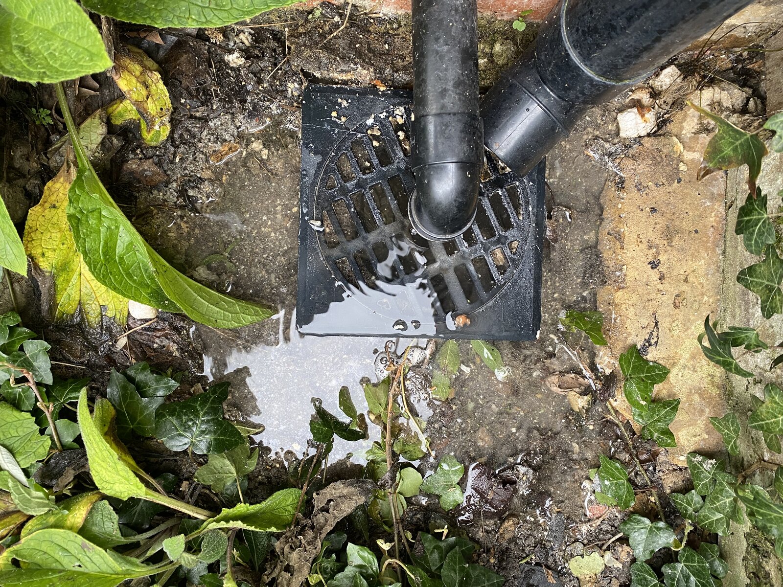

I have a blocked external drain, but can’t work out how to remove the drain grill. It seems to be built in to the rest of the cover. I am hoping that one of you will have come across a similar model and will know. Please see below:

Sorry here is the photo

The circular centre will lift out so you may just need something that can hook under the ribs and preferably twist it as you lift it.
I don't recognise it, but it should pry up. I don't see any retaining screws.
The broken, patched and sunken concrete surround suggests that the old drain in the ground is cracked or broken.
