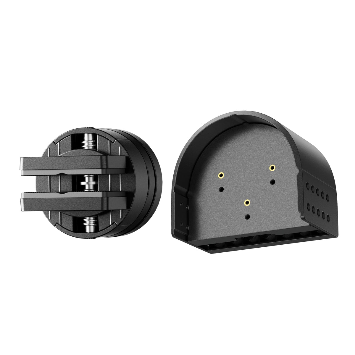

Hi I ended up buying a new cylinder (Yale) - with 6 keys was about £50. Hopefully I'll be able to sell the avocet and recoup some of it.
Not for Nuki but for anyone with switchbot I think this adapter would work but might stick ot quite a lot:
