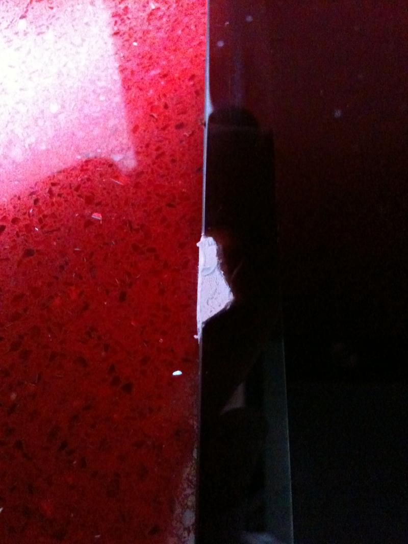

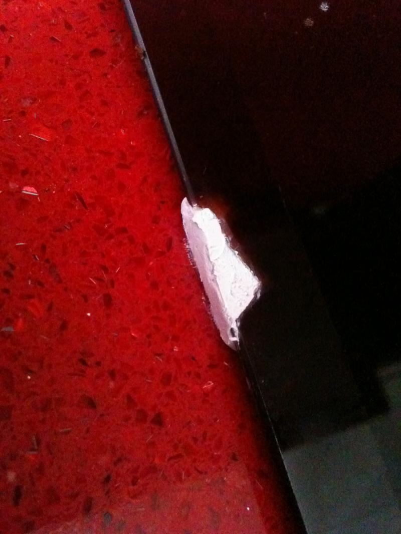

Hi all,
There is a chip out of my hob top. I'm not sure what the hob top is made of, I presume it's glass (or a type of glass / ceramic).
It's really sharp where the chip is and I recently cut my hand quite badly as I cleaned the over top. I wondered if anyone knows of any 'resin' or some other substance (preferably black) that I could fill the gap with to at least take away the sharp edges.
Does anyone know of anything I could use for this or has anyone got any "out of the box" ideas for this.
Many thanks
John ;)
(please see attached piccies)
John you could use an Araldite resin glue (or similar). Try and get some black pigment, possibly a cement dye and mix that in to colour the araldite (you will only need a pinch of pigment). Let it cure and lightly sand until smooth. (You could also try using a small amount of black shoe polish to colour - try a sample first to see if it cures ok - please let me know if it works if you try this method).
Without the colourant araldite looks like a murky green colour (it looks a bit snotty!). You may be able to live with this for such a small area?

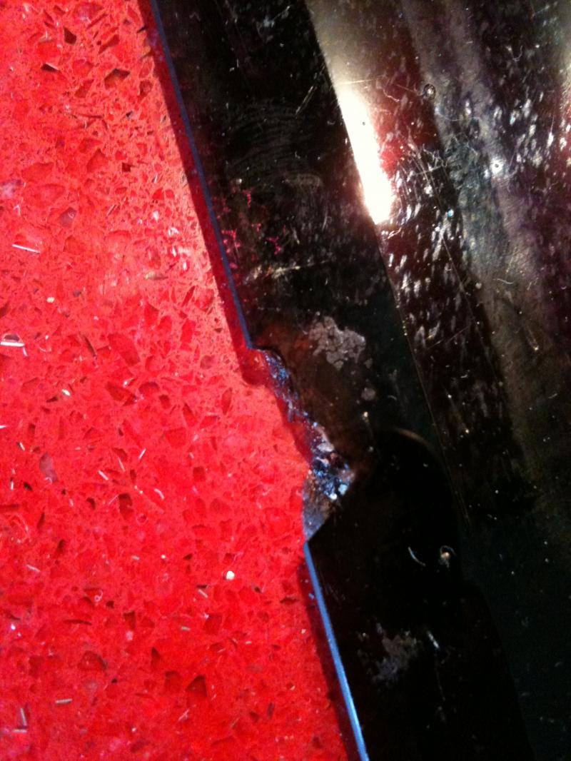

So, I've fill in the gap and, when it cures, I'm going to give it a little bit of a sanding and then paint it.
I've attached pics in the hope this thread might help others out in the future with the same problem.

Putty should be shaped with wet hand while still pliable to get a perfect finish before it cures, does not sand as well.
A lot of good suggestions there Johnny. The product you found is similar to Araldite (an epoxy resin).
My reasoning for adding a colourant is it would be permanent and integral, and would not eventually rub off through the harsh cleaning process that cookers are subject to over time.
However that is not really an issue with your approach, because you will have plenty of paint left over to touch up with as and when necessary.
The photos show you are doing a good job of it.
