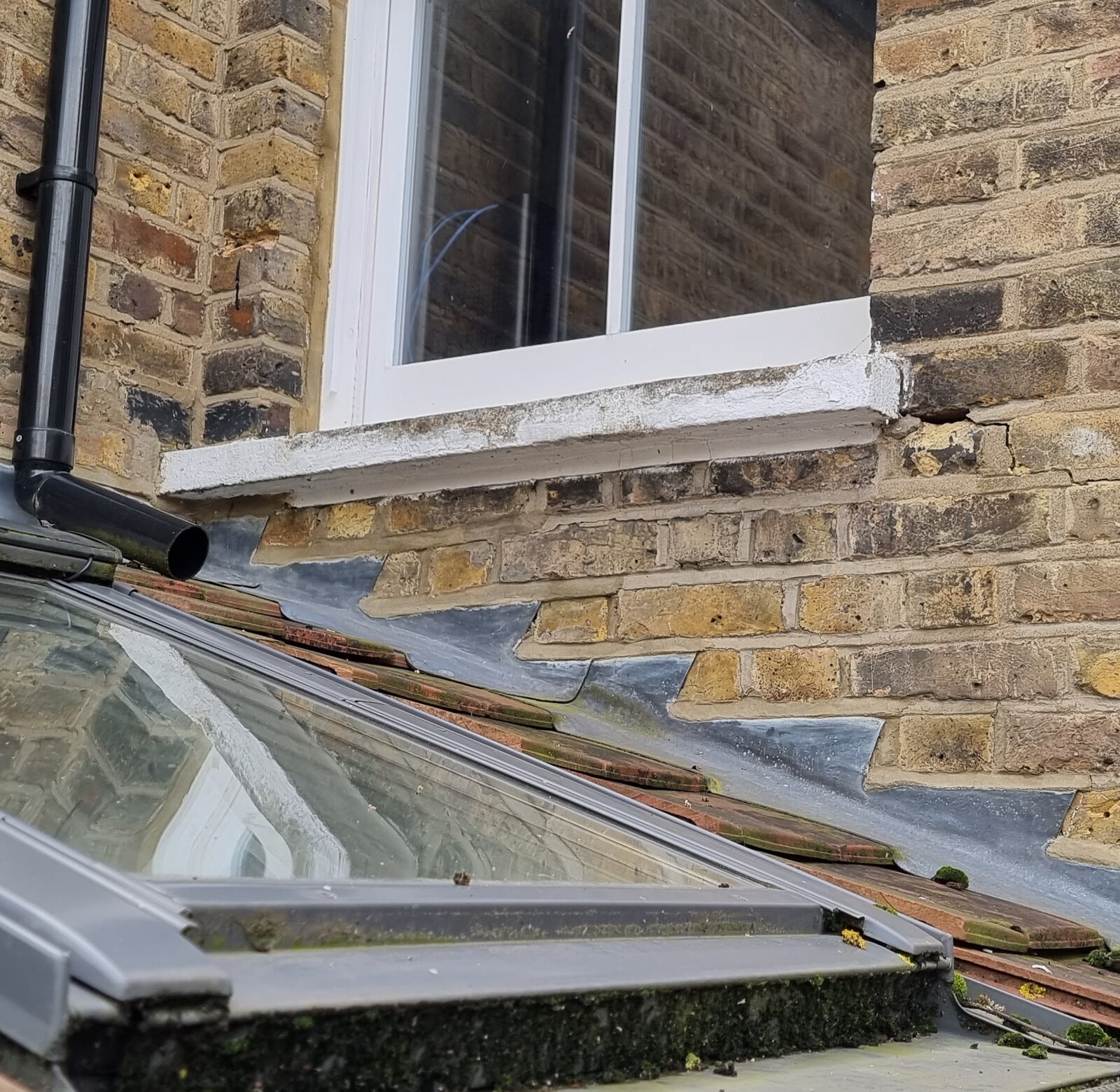

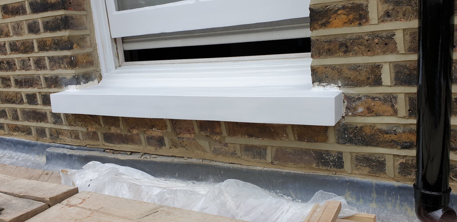

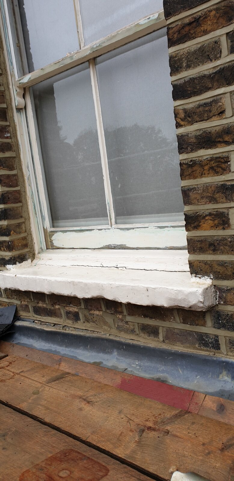

The window sills outside my windows have deteriorated. One is cracked the others seem in one piece (and have possibly become porous). It was painted with masonary paint but that has peeled off. I'd like to repair it rather than replace it.
Here is how I thought of doing it: chisle off any loose bits. PVA on the sill. Make a form and apply a cement mix and smooth over.
Is this the right way of repairing it? Is a cement + pva mix the right material to use (if so whats the minimum thikness)? If not, whats a better material?

Your proposals wont work.
You say window sills but only show one sill?
You mention "porous" - is damp showing inside the house?
More detailed pics might help - pics that show the cracks and from under the sills the drip channels (these channels have to be clear of paint or debris.
FWIW: the flashing is wrong for those tiles but if it works then its working.
The re-pointing seems to be mostly a sand & cement pointing
mix (it should have been a sand&lime mix), and its very poorly done and failing, its almost smeared on and lacks depth of raking out.
The downspout could have been arranged far better to carry on below the sill to discharge in the gutter.

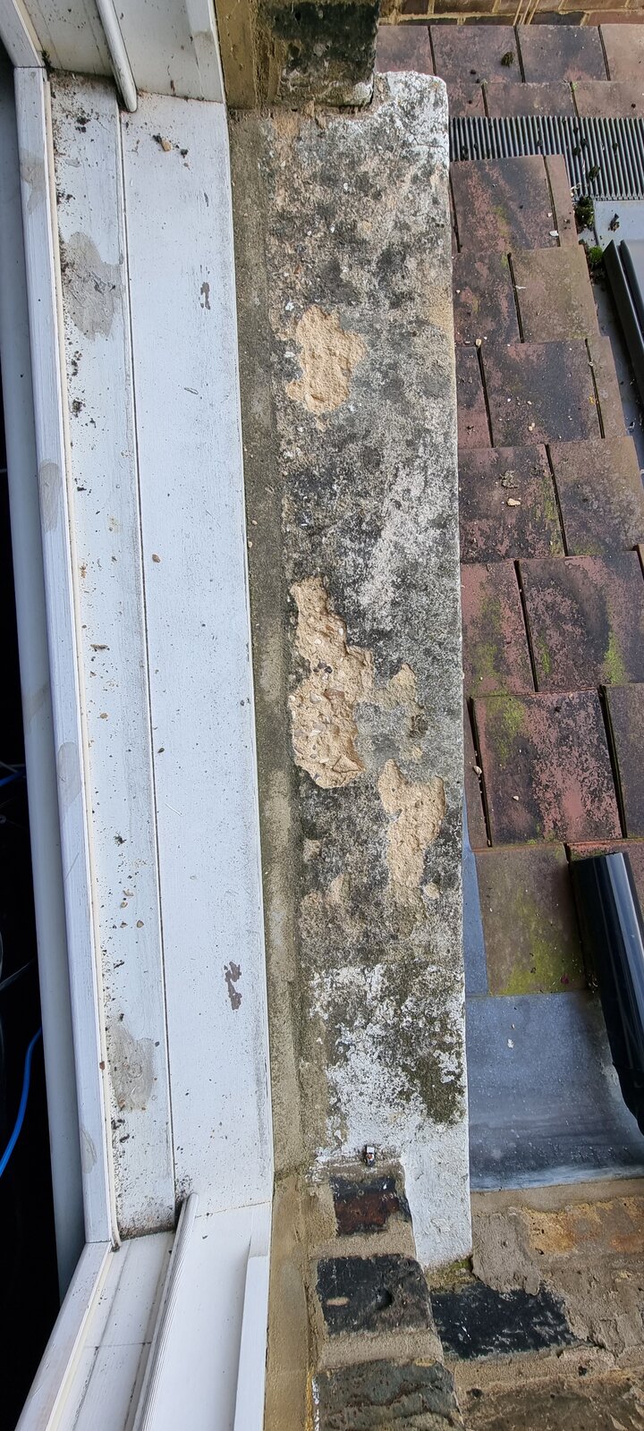

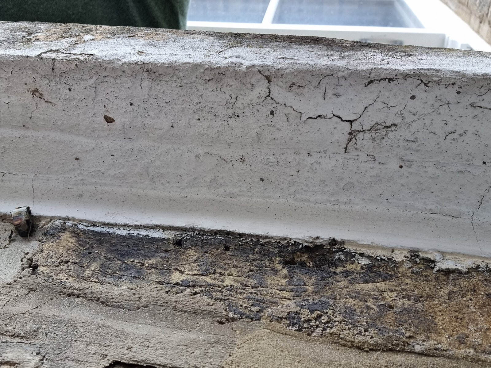

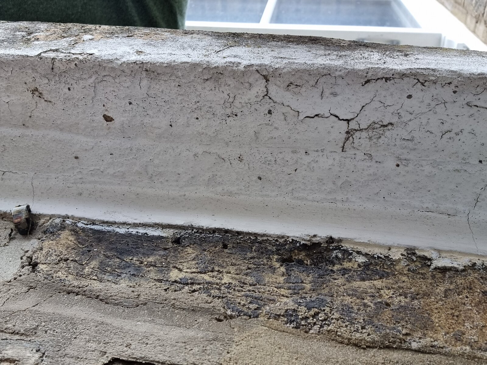

I would like to start with this sill because three is a damp patch inside under the window. Here are pics of the top and underside and top of the sill. There is a drip channel but it's full of paint. There is a gap between the sill and the brickwork that I will need to fill.
Can it be fixed?

Your best bet would be to clean off the top of the sill and use a metal tool to open the channel up - then take fresh, carefully focused pics of what you've just done?
A selfie on a stick will show more of whatever is directly below the sill and the flashing for the roof?

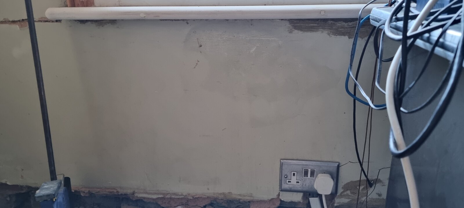

A pic or two from inside showing the signs of damp will also help?
The gap and crack in the brickwork need attention.
"Flat tiles" like yours need soakers and stepped flashing - it could be that the interior damp is coming from the incorrect flashing - you would need to lift the flashing to search for water tracking under it.
The RWP discharge doesn't help - the general idea is to keep down spout water off the roof not to discharge it onto the roof, esp. at a vulnerable, flashed abutment.
Closely examine both sides of that wall ground floor and first floor for any damp signs.

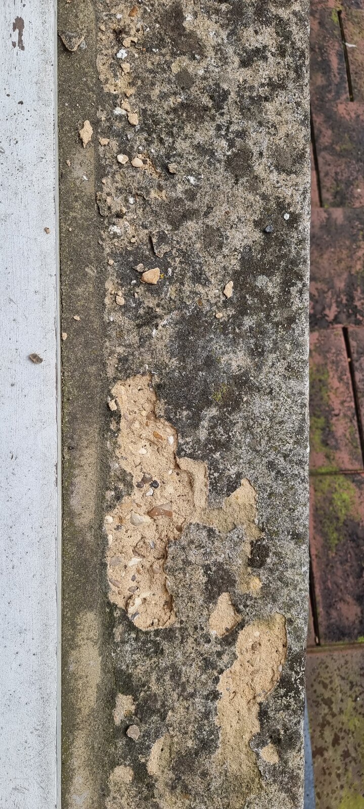

There's a little bit of damp just under the window but hard to see in pic, see attached. I also cleaned up the tip of the sill and took a pic.
It is very possible that the water is coming in through the lead flushing but it's like to be made worse by the downpipe that is chucking lots of water on the tiled roof just outside the window.

Damp patches are caused by the dodgy down pipe flushing rain against brickwork. Nothing to do with a damaged sill .

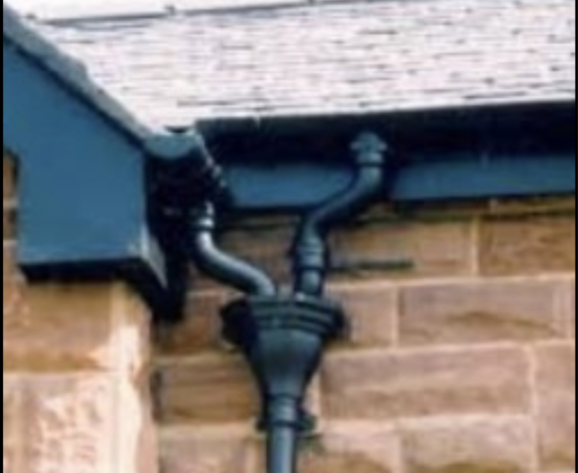

I'll get the downpipe extended as you suggested. Can you explain a bit more about which hopper I need and how I would fit it onto my existing guttering?
I'd also like to repair the sill even if foe aesthetics. What's a durable way of fixing it so it doesn't look so tatty?
Here is an example of how a hopper is used to collect from two down pipes at differing levels. You need one under the top guttering and a second below you lower roof .

Your pics are still not properly focused so not much good - however, working with whats there:
the interior shows damp penetration just below the window board, and dark smudgy areas on the panel of plaster below the window board.
Why have the skirtings been removed?
The sill has had attempts at sealing it: the underside has been sealed with what looks like cartridge sealant, and the top of the sill has a fillet of sand and cement.
When you finally clean off the shelling from the sill replace the S&C fillet with sealant.
I mentioned in post #2 what needed doing with the down spout, and now you are talking about hoppers - why? You say you cant go on the roof so any plumber will instantly know how to turn the corner & run the down spout to the lower gutter.
FWIW: the only place where down spout water could affect the brickwork is if it penetrated under the flashing.
The brickwork above the flashing is not being affected by the down spout.
A hopper typically is not needed at gutter outlets.

Sorry but these are the best pics I can provide. When zoom in at the bird's eye image of the sill I can see the individual grains of sand and cement where managed to remove the top layer.

How much of the S&C fillet do I need to clean off? How would I know that I have gone far enough?
I use (lots) of 2 pack filler to tidy up window sills. It does require a lot of sanding, refilling and re-sanding but you do get very crisp edges and a very smooth finish.
To get the underside of the sill flat, I wrap some polythene around a length of timber and clamp it to the underside of the sill. The polythene can be pulled away after the filler has hardened.
I start by removing any loose paint and then sand it with 40+ grit sandpaper. Dust off and apply a coat of dilute SBR. When dry, I start applying the two pack filler on the top face. Once cured, I sand that back after about 30 mins (in the middle of summer). Then work on the front face. Sand that back and refill the top, sand and then back to the front face. repeating the above as required
I would guess the the filling and sanding is up to 4 hours per sill, depending on the original state of it.
Most of the houses that I work don't have concrete sills. If a victorian sill has cracks, I use an angle grinder to create a channel in the front face and one in the top of the sill. I then insert helifix bars and use two part anchor fixing resin to hold them in place. If there are lots of cracks in the brick work, those will need helifix bars every 3 courses of brick.
