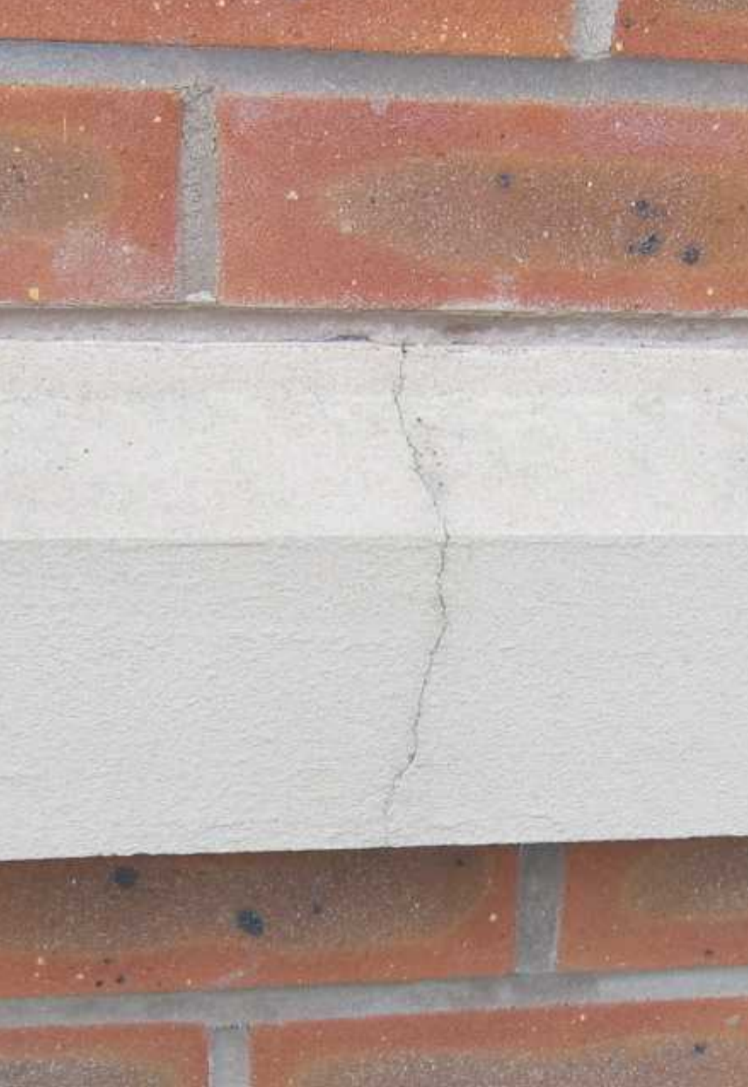

I have this decorative sill with a crack down the middle. It's a newish house so I assume it's made from coloured concrete or similar.
I'm unsure what product to use to fill it to stop water ingress. I might repaint the sill with Sandtex masonry paint in the future but for now I'd just like to fill it.
Sandtex do a filler but it's white which will stand out like a sore thumb. I guess another option is clear silicone, but I'm not sure how well that would adhere.
Please let me know what you think!

I doub't you will have any success with fillers and certainly not anything that lies on the surface like silicone. I'm pretty sure everything you'll try will either stick out like a sore thumb or be too minimal to have a lasting effect. Thick paint is your best bet.

When I bought the house a couple of years ago the surveyor pointed out this crack, and whilst most likely not serious, he said it should be repaired to stop water ingress. It has gotten slightly wider than in the photo I posted here, due to the freeze-thaw action over the last couple of years.

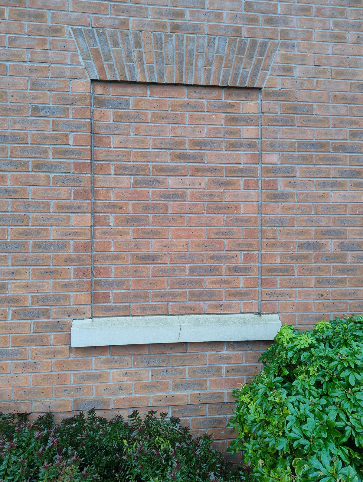

Could you take a less zoomed in photo showing the whole sill?

Here's a photo showing the whole sill.

I'd say there's zero chance of structural issues.
Honestly I'd spend £10 on some fertiliser, pour it on that bush to encourage it to grow and hide it. But there is a near horizontal surface so there's some potential for a tiny amount of water to get in.
Filler and paint would work, paint it all, not just over the crack but don't paint the others to match. In as close a colour as you can get.
Rake it out with something first, turn the crack into a v-shaped valley. Hopefully it's done all the moving it wants to so won't crack again.
Hopefully the bush will grow as the paint falls off!
