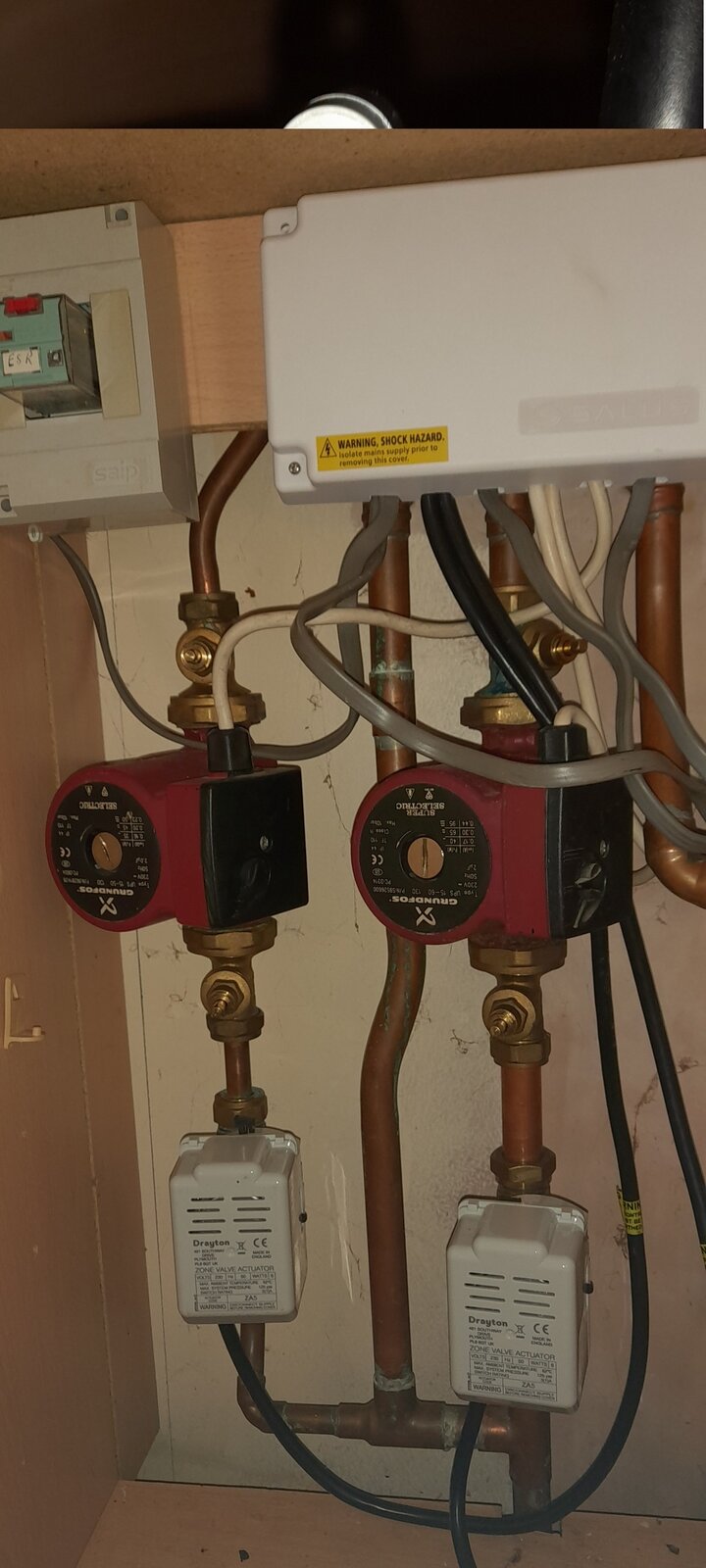

but on removing the head, can't see how the head comes apart, I tapped in on the cupboard floor and the V3 switch opened and it is now working, but clearly will need the switch changing, the valve
only £50, but wired into a wiring centre where I am going to struggle to reach, other option is cut cable and fit a 5 pin plug and socket.
Plastic cover, not steel, and can see captive nuts, but not how to access any screws. Drayton rather than Honeywell. The valves stop the water flowing in reverse direction should only one pump be activated, it is a C Plan, but house and flat, so I can run the house without the flat. The micro switch sticking means the pump runs against a closed circuit, the boiler not a problem, it heats the DHW.

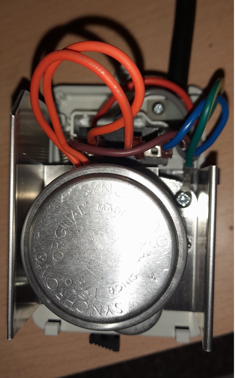

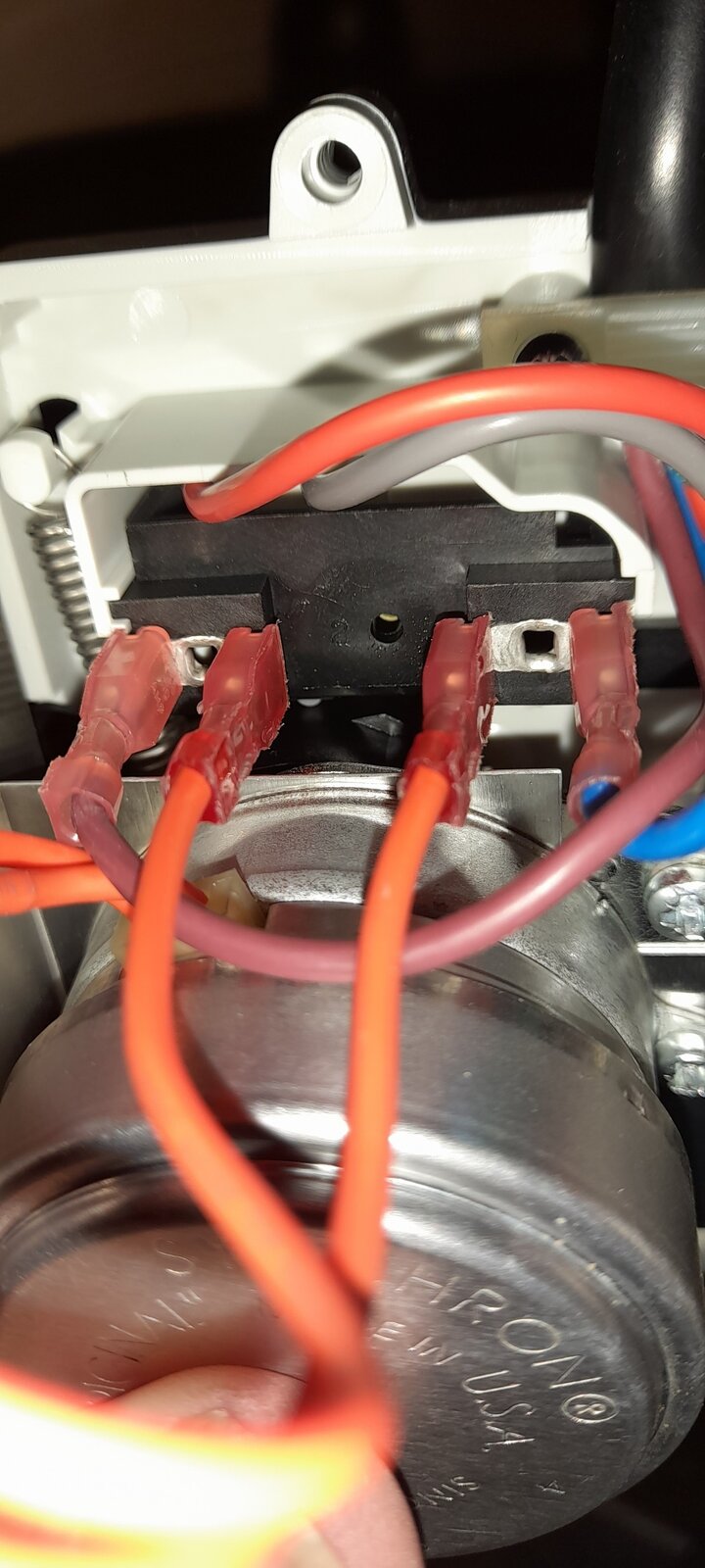

Looked at it again today, Motorised valve inside 2.jpg got cover off, easy when you know how, Motorised valve inside 1.jpg don't think changing micro switch is really an option. Working again, but clearly needs changing, the valve easy to reach, Motorised valve overview 3.jpg but the wiring centre where connected is another story, think it is time to call my son, and ask for help. Knowing how to do it, is not the same as doing it at my age.
Thought I could latch the valve open, so if it does stick, pump not pushing against closed valve, but as soon as valve activated the latch drops out. Only 4 years old, had expected them to last better than that.
Can't even see the micro switch, there is a terminal board on top of it, and without a spare not worth playing, at least my heating works as it is.
