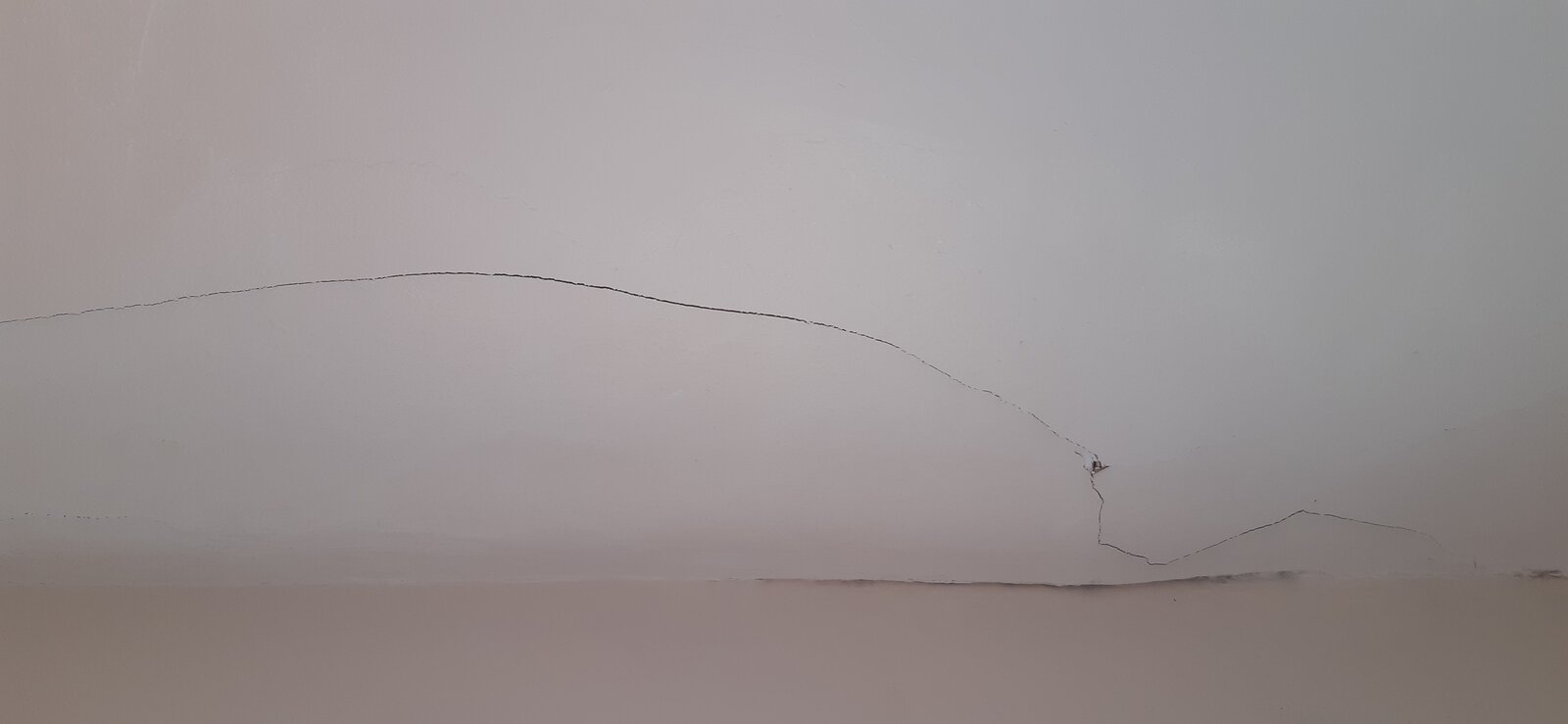

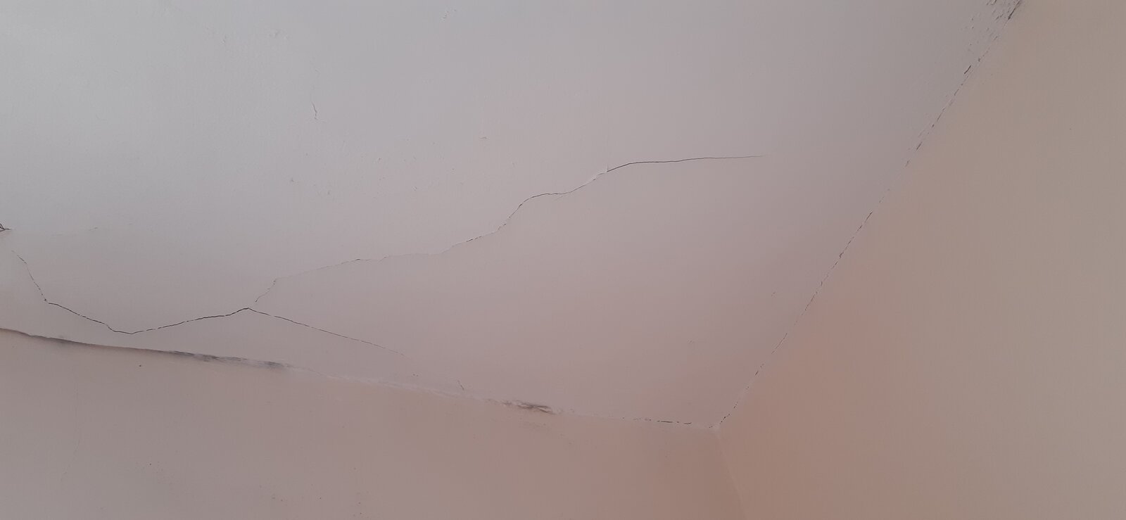

Actually looking at the cracked ceiling from the flat below I'm wondering if it's too far gone to repair.
If you have rotted laths they need to be removed, along with the plaster they are (just about) supporting. The source of the leak/water ingress needs to be identified and fixed. It is then better to just patch in some plasterboard onto the joists and then skim over that. Other than highly ornate, historically significant plasterwork (e.g. with ceiling roses or special cornices), badly damaged lath and plaster is generally not considered worth the effort of keeping in my experience (and replacing laths is a dirty, carp job)
