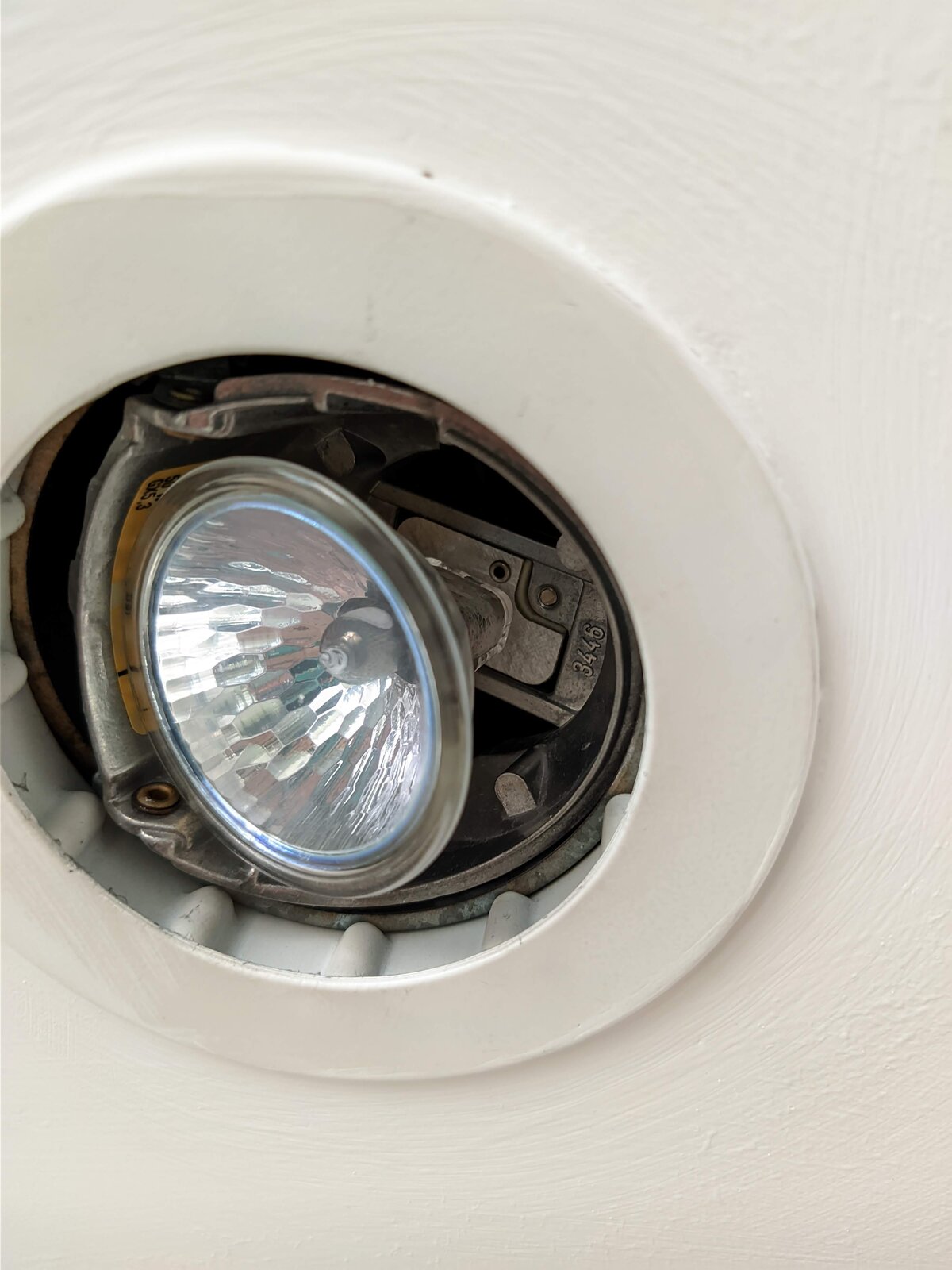

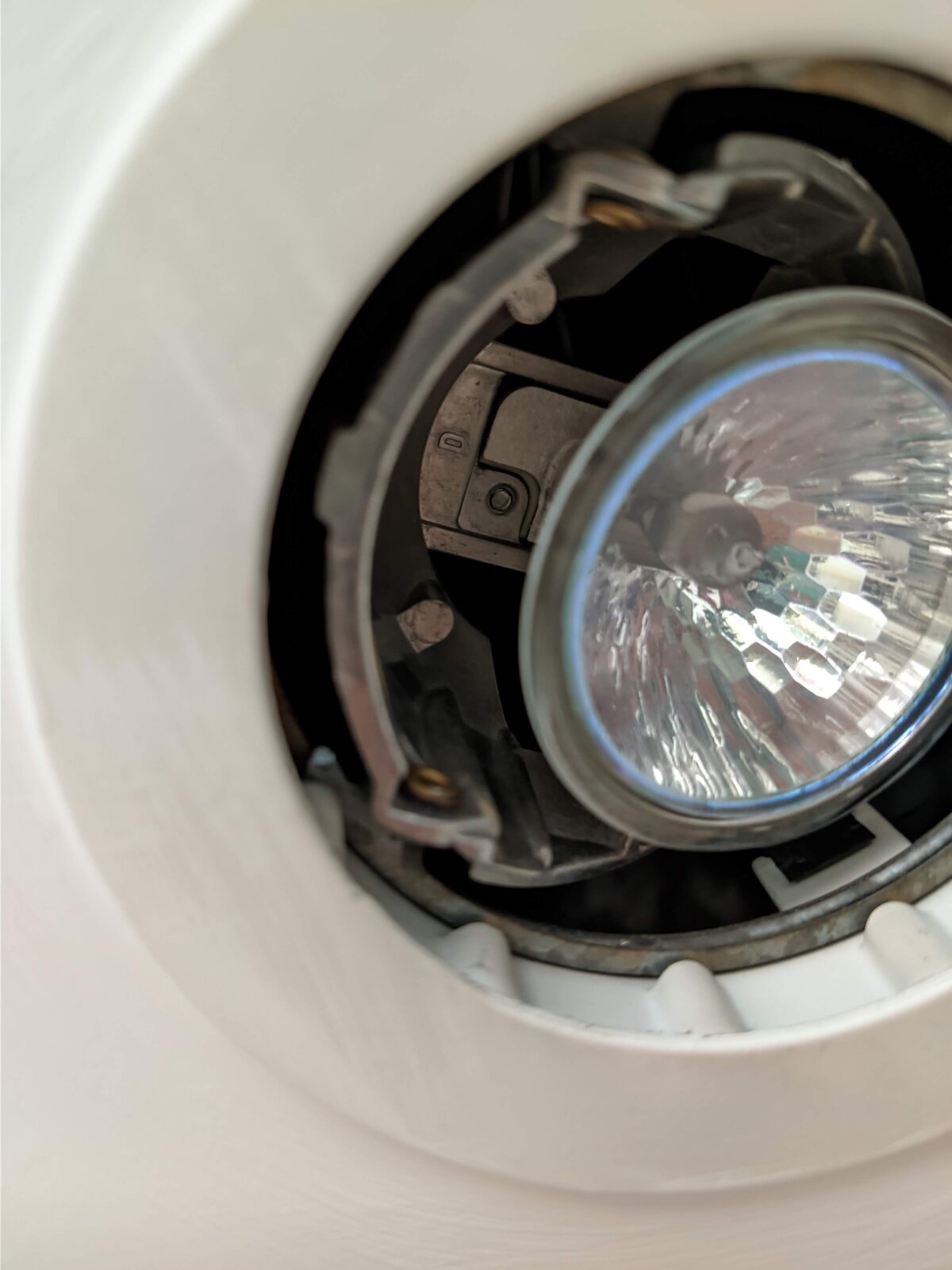

How to replace these GU10 bulb?
18 Jul 2021
7
Hi, this must be some old fitting type.. anyone had experience with this?
the round bit, that is painted to the ceiling. Score around it to break the bond, then pull down.
There will be 2 spring clips. Don't trap your fingers !
