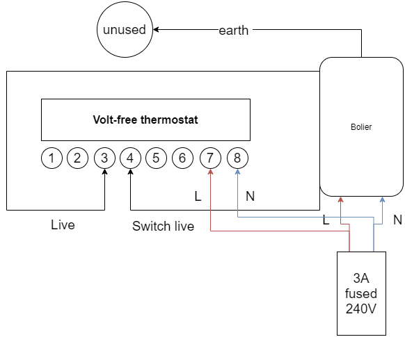

Hello,
I am trying to replace an old Honeywell T6360 main wired thermostat with a volt-free smart thermostat.
I have an worcester bosch greenstar 30i boiler

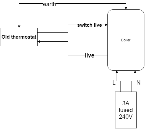

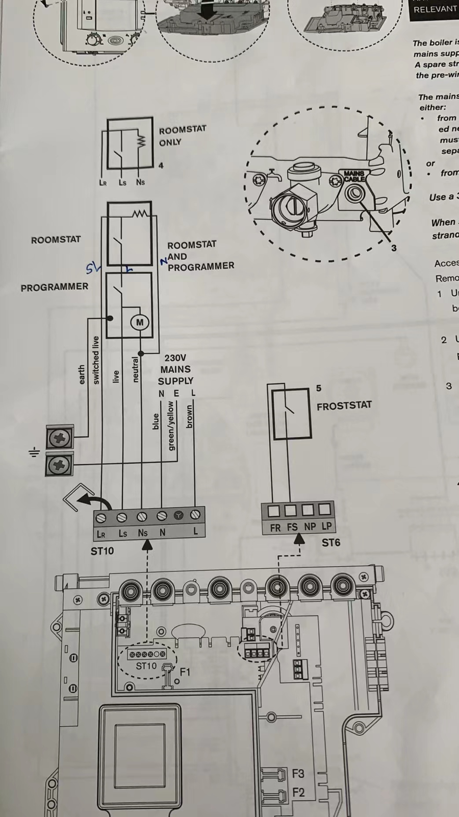

The current thermostat is wired up as shown in attached photos. From my measurements and bolier digram, I believe the wires I have now are "1-red-Live", "3-blue-switch live" and "Green-earth"
My understanding is that the thermostat is currently set up so that it operates as simple main voltage switch (as shown in below schematic).

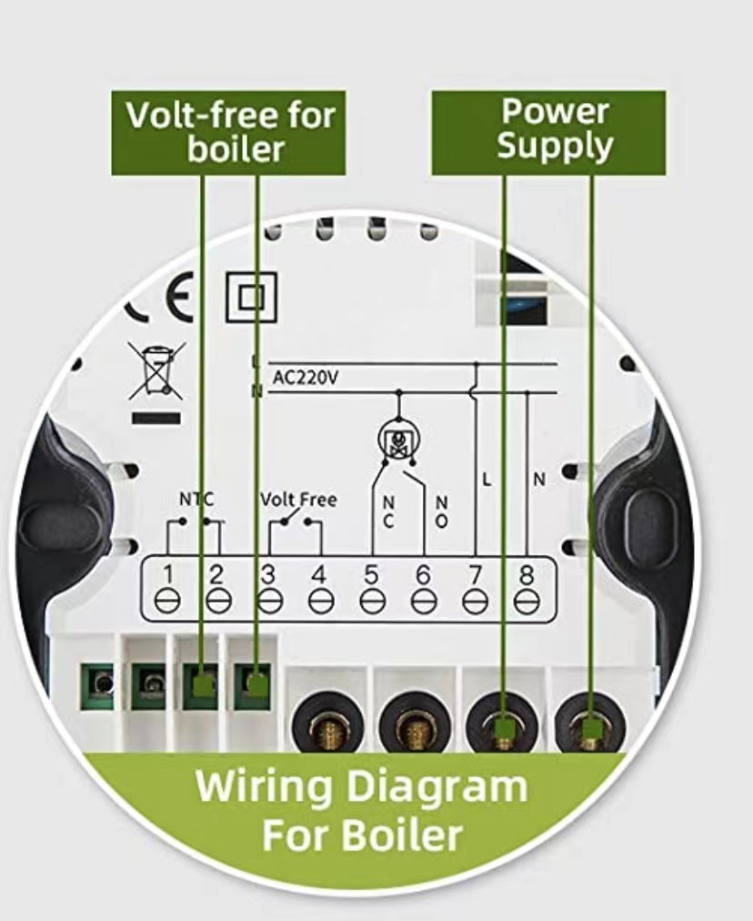

...and so, in order to replace the current thermostat with the volt-free thermostat, I would have to creat or add a 240V connection to the neutral and live terminals (as shown schematic below), which would then power the new thermostat. I am planning to get this new 240V from fused termail which could be turned on and off with boiler.
I will connect the old "1-red-live" and "3-blue-switch live" to volt-free terminal which are 3 and 4. Therefore the new circuit connection for using volt-free thermostat will be:
I did some search said the volt-free contacts could work with 240V. Am I right?
I would be grateful for anyone's comments on any of the above, and/or any advice as to how best to go about this installation. Thanks

Yes your understanding is correct, you do need to supply a permanent live and permanent neutral, then you can use either the volt free contacts or 5 & 6 which are common and normally open (a bit like how your Honeywell works now), and also suitable for mains voltage.
Volt free means you apply the voltage to those contacts, usually 24v up to 240v.
