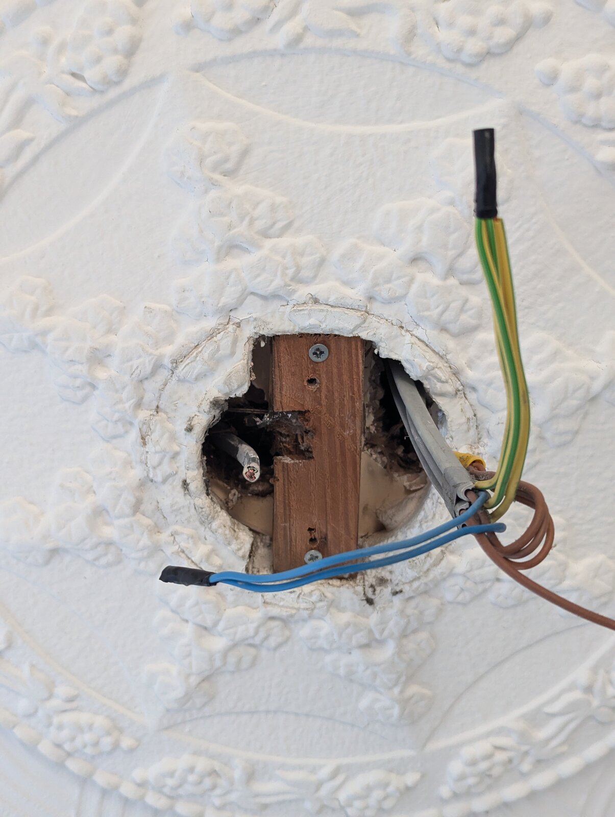

I am in the process of turning the box room into my son's bedroom.
I removed an eyesore of a ceiling fan to replace it with a more child friendly light fixture and I have discovered an old red/black wire that has been cut.
I am reluctant to install the new light until I know whether that cut wire is dead or still live but, I am unsure if testing is something I can safely do or if I will need an electrician with his safety gloves and rubber mat.

You'll need an item that's called a multimeter. That will confirm if it's live or not.

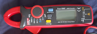

Personally I would use my clamp on multimeter set to non contact volts as a start point. But what you use depends on what you have, I suspect house has been rewired and the red black is the old wiring.
Seems no earth wire, so likely pre 1966, so likely dead, but how to test depends on what you have.

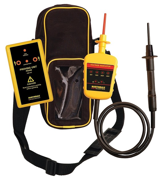

The official way is with a tester like this Voltage tester and proving unit.jpgit comes as two parts, the tester which has no selector switch or battery, so can't be on wrong range or have a discharged or poor battery connection, and a proving unit which will test that it will work with 50 volts and 400 volts, 50 volts being the point when we call it extra low voltage so considered safe, and 400 volts being when the last light on the tester will light.
You would also need to compare with a known earth source, lucky you have that.
However, that is a lot of messing around, so I would be satisfied with the non-contact tester, like this 1719209688058.png for example, it has a sensor in the jaws, and will show a voltage without contact in 4 stages between your hand and the jaws tip. These
do the same but single stage, and not as robust, and at the price of £23 against £35 I would pay the extra to have all the other features, however my meter can be turned to the wrong range, and both require batteries so can't officially be used to prove dead.
I find the non-contact voltage is handy to see on a power failure if the DNO fuse has ruptured, as it allows testing without drawing the fuse and breaking the seal, however one has to consider can one ever "PROVE" dead, as so easy for a switch, or some automated unit like a PIR to be off when testing, but turn on later. Including a total supply failure when testing.
Even with the proving unit, I have been supplied with versions which only test at 400 volts, which is a bit useless, as it is not proving the tester will work with 50 volts, above which it is considered dangerous. And the non-contact testers only work will AC, however unlikely to find dangerous DC voltages in the home.
