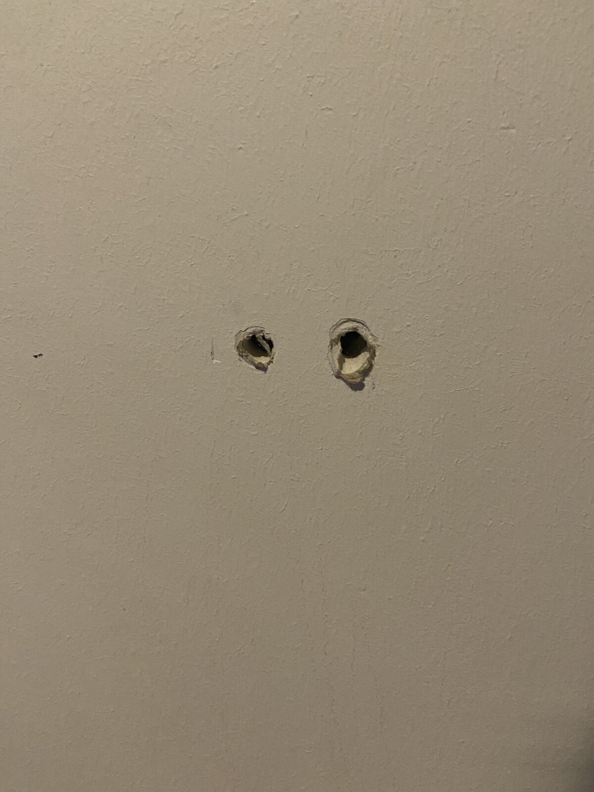

We put wall plugs in to screw in to put curtain hooks in and they crumbled and fell out of the wall. We’ve tried all sorts and have holes dotted around the home. We’ve used command strips to put up pictures but some of them have fallen off.

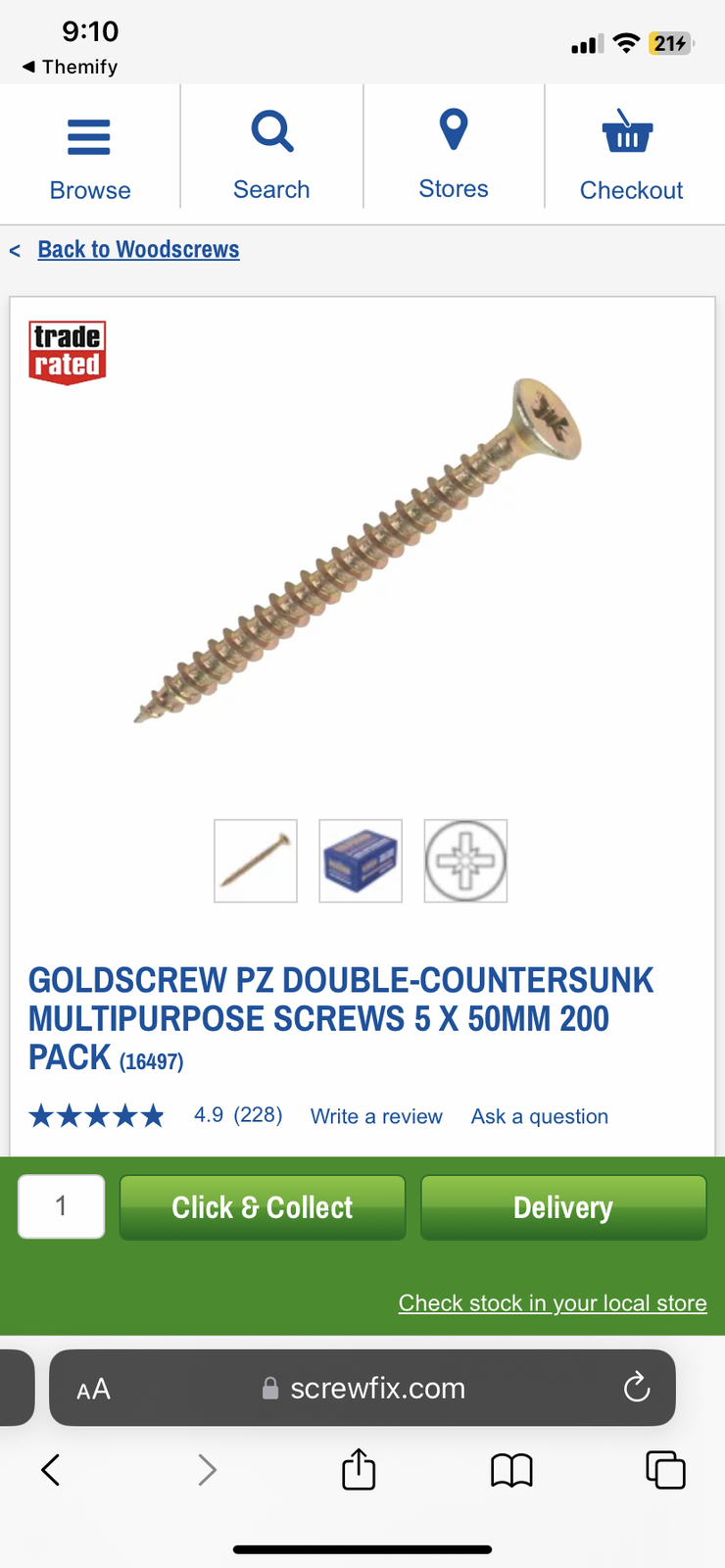

Then you have go find, and drill into, the timber studs. You need woodscrews, not wallplugs, for this.
So when I type in to screwfix wood screws these ones come up, should they be okay?

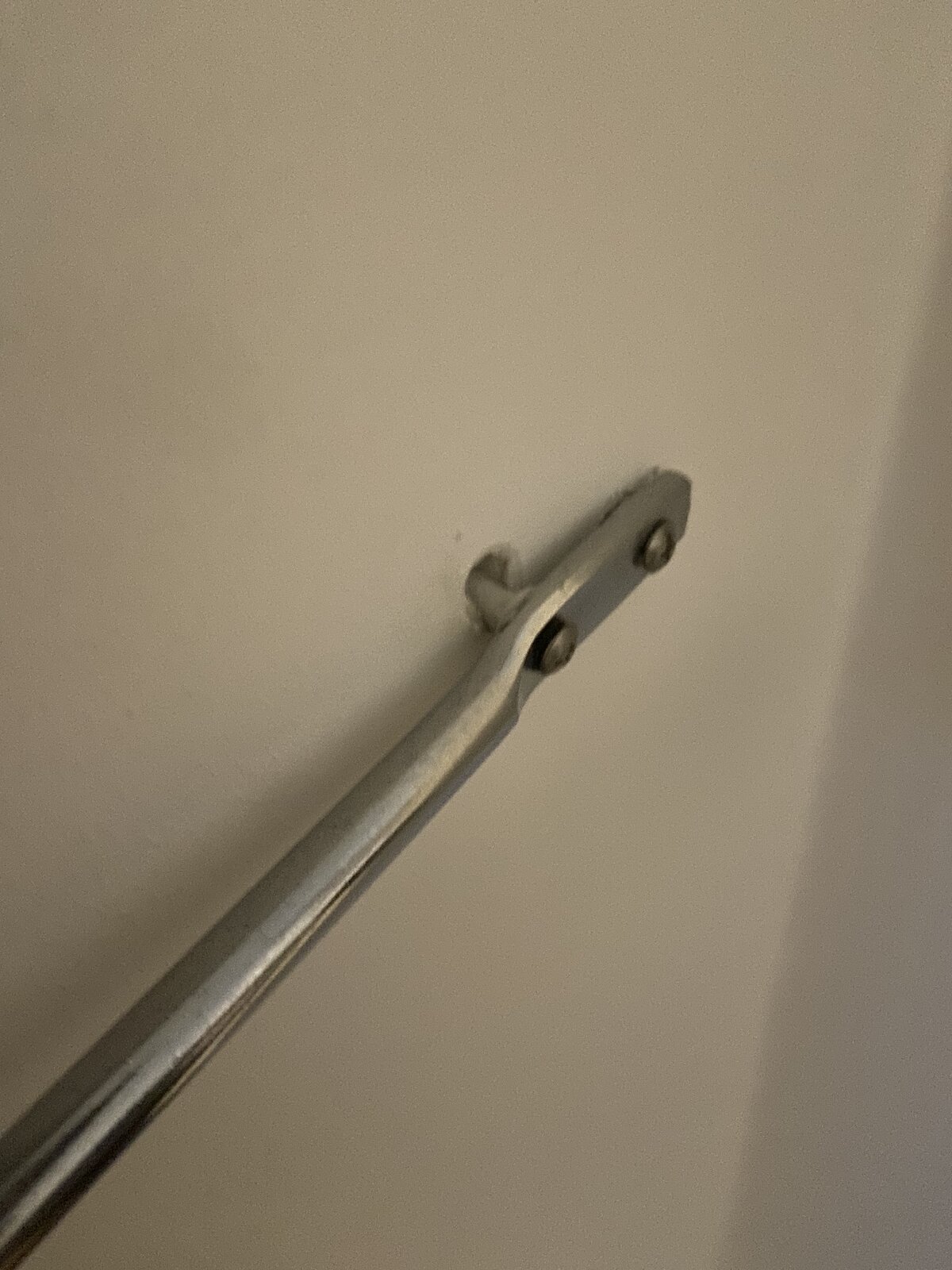

Also, the curtain hooks that the wall has crumbled should I be using a woodscrew there too? it’s next to patio doors

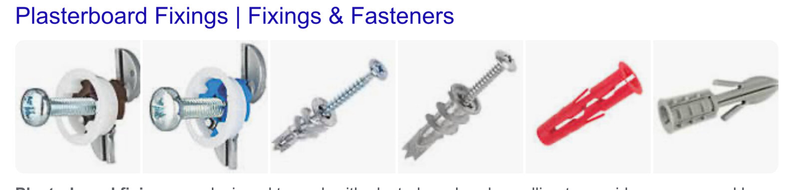

There are a number of fixings available for plasterboard, which you use depends on what you find behind the plasterboard, a thin screwdriver can be pushed thru the board where you wish to fix, if it hits fresh air then there are many types of fixing and depending on what you are fitting (and it’s weight) effects the type of fixing required.
Just a few of the fittings available.

True and I have used them but they will not take a lot of weight such as a radiator which should be fixed to the timber studs.
