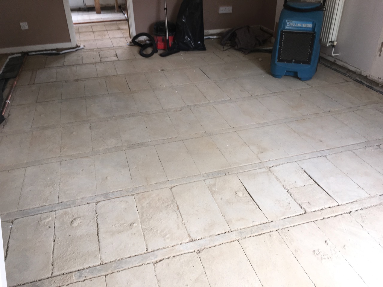

Hi,
I had a water leak which meant my existing chipboard floor was removed, along with the insolation and DPM over the beam and block floor. The chipboard wasn't screwed in the concrete and was always a little bouncy.
When this is replaced by my insurer should I expect them to screw the chipboard / plywood down (Although wouldn't this then go through the DPM). or just leave it floating again?
Thx
Mark
I've done a little more research and I'm planning on doing this:
  • Flexible adhesive Tiles or floorboards
  • 18 mm TG plywood glue and joints (less flex that chipboard I've read)
  • 20 mm TF70 kingspan or 20 mm Optim-R kingspan (There is not enough space for thicker insulation)
  • DPM
  • Beam and block flooring
Any suggestions for making the floor more secure ? (I don't have the depth for screed).

I've attached a photos of the BB floor. If I jump up and down I can feel it bouncing slightly (I've not introduced it). I'm now thinking maybe engineered wood will be best throughout. I've ordered some samples.
I've read weber floor flex is a good floor screed (and dries quickly) so tempted to get this put down first as I'm sure the floor isn't level.
So something like this:
  • Engineered wood (20mm)
  • Flexible Adhesive
  • Vapour Control Layer
  • 22 mm TG plywood
  • insulation 20mm
  • DPM
  • weber floor flex (10mm)

it's a suspended floor if you jump up and down there will be some movement, but to all intents and purposes that's not where your movement will come from. It's your floor over insulation that gives the flex. I reckon that floor is decent enough to just ditch the SLC and do as you suggest from the DPM up, if your going to go with the glued down engineered.
Ps; chapters seems to have mentioned porcelain/ceramic style tiles a few times, but I don't think they're the kind of tiles mark306 meant..
Mark, I don't see much point in going crazy insulating your floor's topside; you don't have underfloor heating, and a floor is not a huge heat loss path. Adding insulation won't mean you walk into a room in bare feet and think "mmm this floor feels nice n toasty!"
If you're after a floor with little flex, look at building it out of limited compressibility layers that are glued or screwed down. If the block and beam floor undulates a lot as you pass over the beams, consider an underlay that is available in variable thickness, laying in strips to even things out. An engineered wood floor can go straight onto it. I'm also not sure I see he value in your dpm or vcl layers.. a beam and block floor wouldn't be sat on the ground, but will likely have a ventilated airspace underneath, so what is the dpm for?
Ps; if you're concerned about the slight flex a concrete beam will exhibit when you jump up and down on it, I think you might need a bigger problem!
