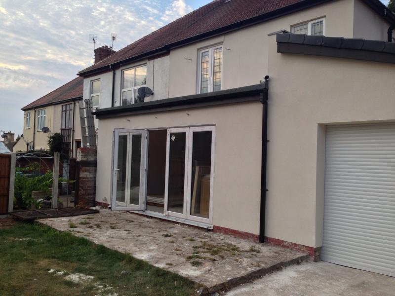

Afternoon all, hope you are well. I am considering putting a hand rail on the flat roof at the back of the house but unsure how I would secure it safely. It will be "L" shaped so secured to the wall at each end. But at 3m x 6m I would also need to secure it to the flat roof at some point but I have no idea how to do it without worry about penetrations causing the roof to leak.
It is a standard felt covered ply. The design of the fascia and guttering below it means the rail could not secure to the front of the brickwork below.
Any ideas or advice from people with experience would be hugely welcome - pics ain't great but give an idea.
Thanks, Mark.

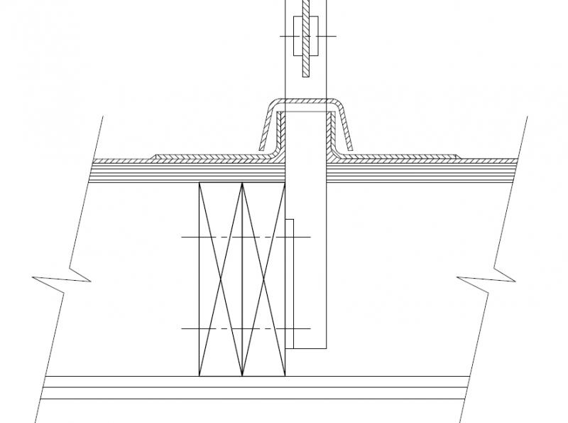

You don't fix the base plate to the deck and hope for the best the whole structure of the flat roof needs to be up to it so if the structure has been designed for the job then you need to be fitting the handrail to the roof during construction not after the final roof finish has already been applied.
Anyway, structural headaches aside, waterproofing is easy and the least of your worries. I'm very surprised you managed to get PP for it.
Have a read through this fella: //www.diynot.com/forums/building/fitting-hand-rails-to-a-flat-roof.370058/#2819748
The principle is simple, you just dress the membrane or felt or whatever the roof is up the balusters and add a cowl to stop the worst:

Agreed. This is where my foresight has fallen short. When we rebuilt the roof I had it calculated and built to be compliant in regards to people accessing it. But at the time I didn't have a thought towards securing a railing. To be honest all the work went on only a few months ago and I wasn't planning on fitting any railings any time soon (years), but the plan has come together quicker than I'd have hoped and now I'm seeing what I can do short of taking the roof back up!
