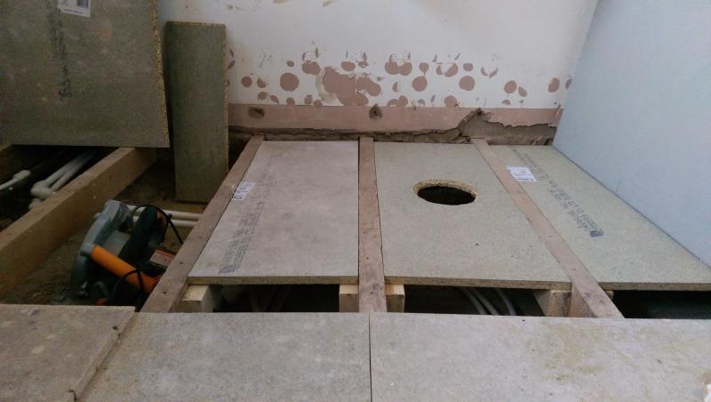

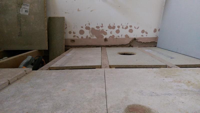

Hi all, another "challenge" has come about - i'm nearing completion of our bathroom and will soon be laying the flooring.
But, whilst fitting the shower tray (wetroom type) i noticed that one of the joists - sods law one under the shower tray - is slightly higher than the others.

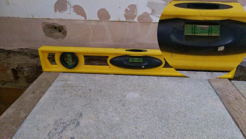

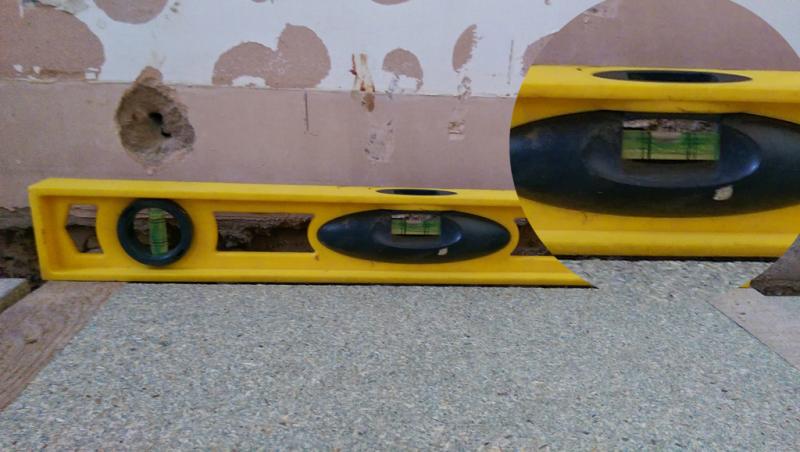

I thought that it might have become like that since i lifted and replaced the floorboards, but holding a spirit level up against the wall where the joists meet the end beam (the one running perpendicular to the joists that they are bolted on to) it looks like it has been laid like that.
So, how can I fix it, obviously that's gonna cause major issues with the wetroom, and as we're tiling it needs to be perfectly flat right?
Plane the top of the high joist or pack the tops of the others to the same level.
As above. An elec plane or a Jack plane would shift that in minutes.

The other problem is, when you stand on it, it does push down, although not enough for it to be level with the others.
So, is there a way I can keep it down, at least until I install the shower tray and begin tiling?
Perhaps bolting it into the concrete below?
Well seeing as insulation helps to retain heat then yes it would be worth it IMO. Getting out of shower and standing on freezing cold tiles in bare feet is hardly desirable.
You mean the joist bows? Or the joist is not well secured? Any movement under a shower tray and a tiled floor is very bad indeed.
Well, I don't think it bows as such, i think it's just crowned, and lowers slightly when you stand on it. But only as far as the sleeper walls (under the floorboards) allow. So it's not as though it'll lower past the other joists.
For reference you can plane a little off *one* face of a joist without compromising its grade.
5mm <100mm
10mm >100mm
As above.
Movement below a tiled floor is storing up potential trouble.
OP, you should plane the joist level, or compress it level with the other joists, and screw on a sistered length of 3/4" ply ripping.
Whatever, dont cover a loose joist.
