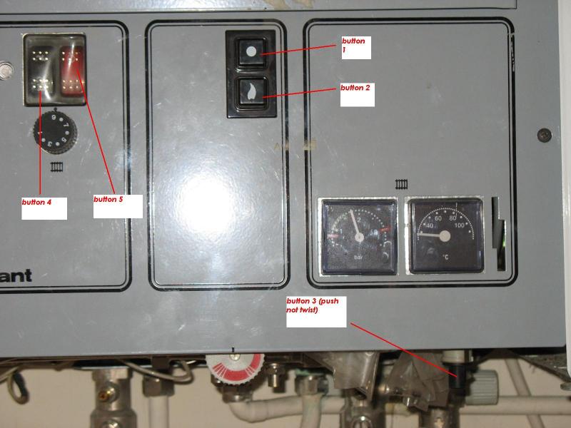

how to start vaillant
push in & hold the square button with the flame on it.
under the boiler on the right hand side is the ignition.push this or twist it (depending which sort it is) to produce the spark. you will no doubt have to do this repeatedly until the pilot catches.
once alight keep holding the square button in for perhaps 20 sec. then gently release it. the pilot should stay alight.
you may have to repeat this process several times.
if it does not work call in someone qualified to repair it.
The above instruction is to light the pilot light.
However, if thats working then you need to select HW on the programmer.

thank you so much for your good answer.
I have marked the buttons that could be used.
Can you give me detailed process? thanks a lot.
what's the the square button? button 1? or button 2?
what's the use of button 4 and button 5?
THATS BUTTON 2 !
THATS BUTTON 3 !
Push or twist it (depending which sort it is) to produce the spark. you will no doubt have to do this repeatedly until the pilot catches.
THATS BUTTON 2 !
THATS BUTTON 3 !
thank you, my dear friend, I will try it at noon, if it will work successfully or not, I will tell you, friends.

I am just wondering how Agile wires up combi`s why would you have to select HW on the programmer .
