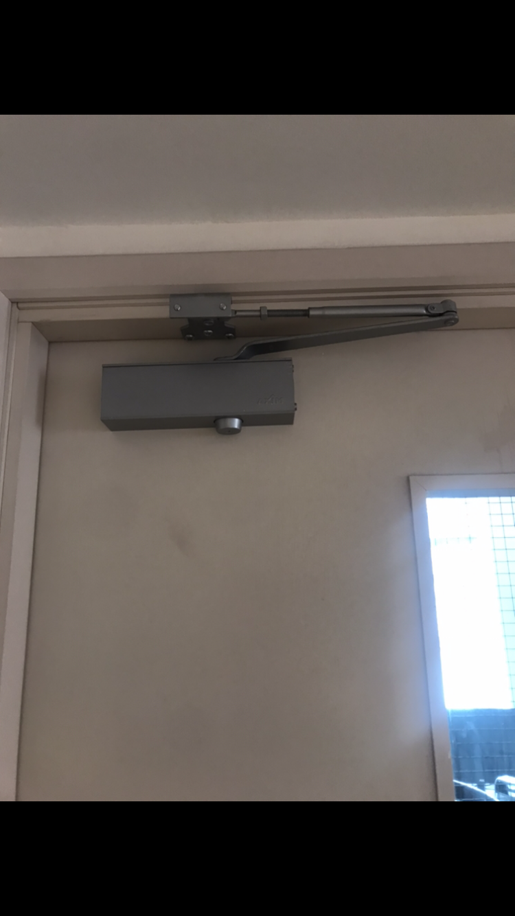

Hi
Pls see door closer on attached pic. It’s for my office door.
How can I stop it from slamming shut, is there something I can adjust for a softer close?

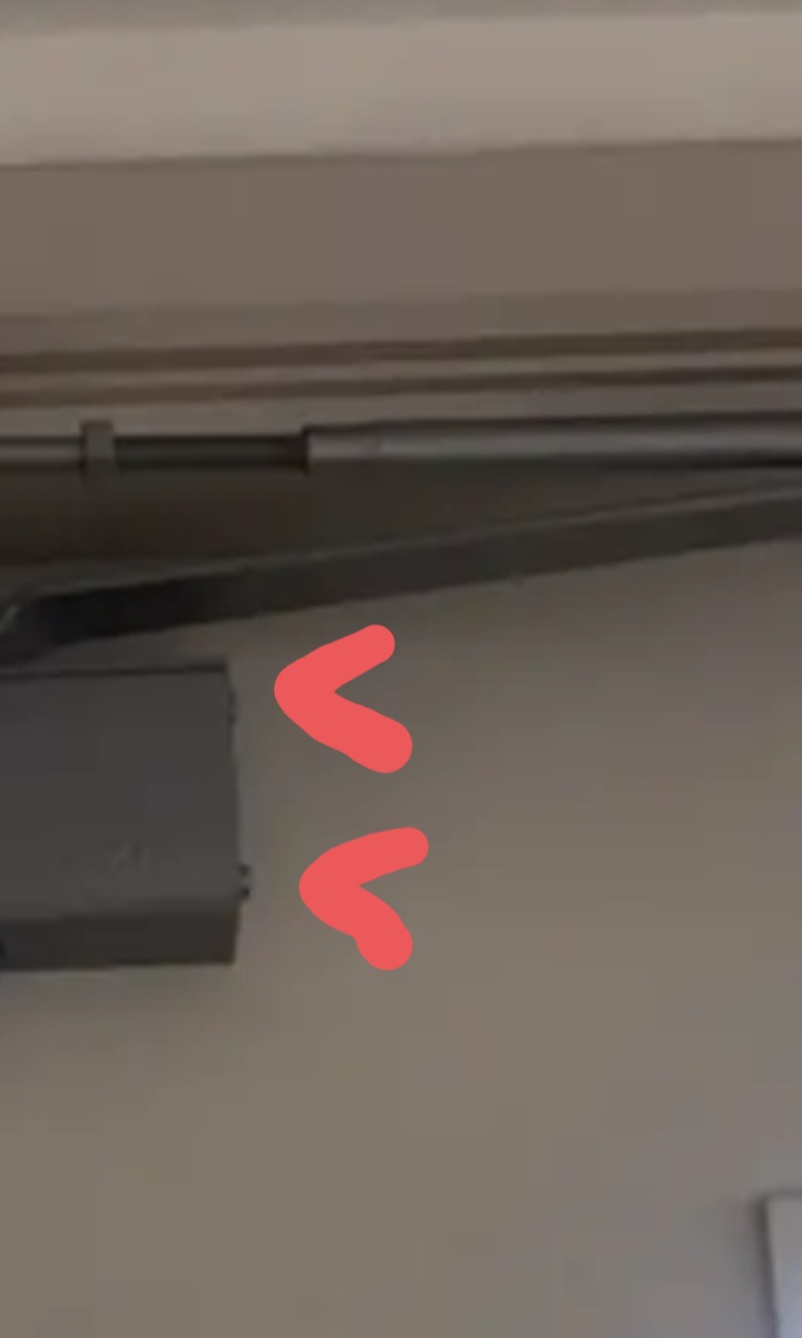

It looks as if your adjusters may be here?
They are usually adjustable with an Allen key.
One will adjust the closing speed, one will adjust the final 'slam'.
Usually, a clockwise turn on the adjuster would reduce the oil flow through the closer and the motion would slow - anyway, have a play with small adjustments and see what happens!
