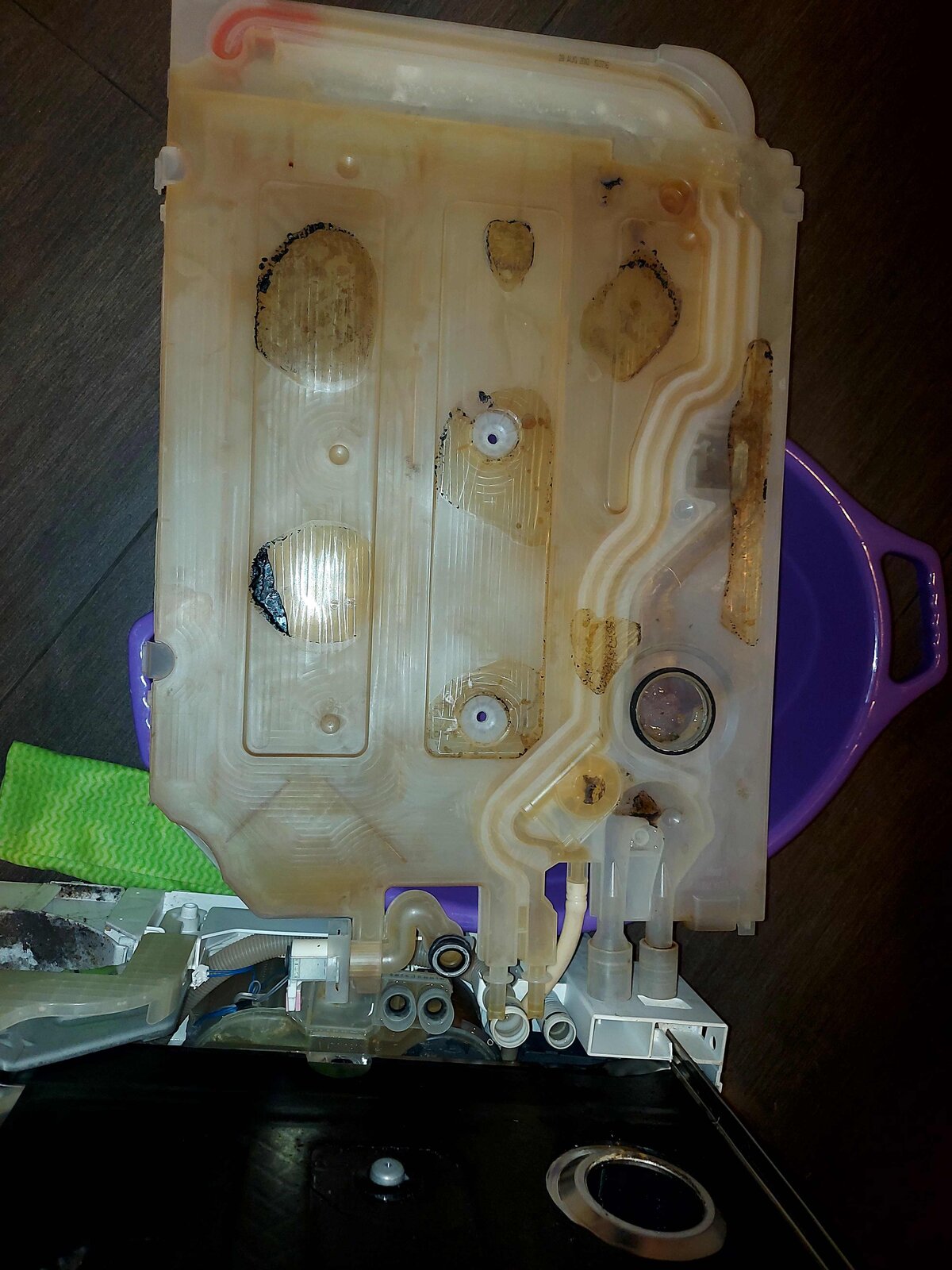

Hi everyone. I have a Bosch Super Silence model that has been leaking on the inside through the left side wall (through the large plastic screw or whatever it's called).
Symptoms:
- water leaks in and accumulates while the dishwasher is not in use. In one day, the water level is enough to spill on the floor.
- the plastic tank / heat exchanger / matrix in the photo slowly fills up to the top and then the leaking starts inside the dishwasher.
Any ideas how to stop the leakage?

Replace the solenoid valve, at the water input connection, which is passing water. Until then, isolate the supply, when not in use..
