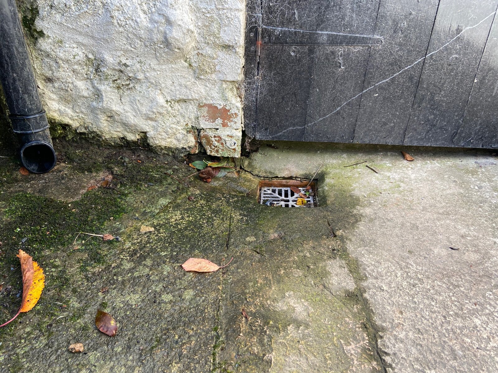

I have a storm drain at the bottom of the garden path which collects a large amount of rainwater and directs it into an adjacent stream. Unfortunately since it's only a 6x6" grate it covers over with leaves frequently during the autumn and all the storm water then floods my shed.
It's all set in concrete so it's a bigger job to get improved than I can do at the moment.

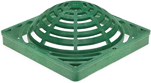

What I would ideally like is an atrium grate (as attached) which effectively raises the drain level but nothing seems to be available in the UK.

Dome grate from flat roof?
Thanks, that's the kind of thing I need but they tend to be round and the wrong size to fit on the existing drain hole. It has to be something you can stand on too. I will keep looking for the atrium grate and see what I can come up with.

A domed structure would surely stop the door in the background from opening?

Wire mesh isn't ideal because it's right next to the shed door and will end up getting stood on. Nevertheless, this is what I've ended up doing. I've just ordered a regular domed leaf guard which is stronger than mesh but probably not strong enough to stand on. It'll do for now. The shed door is about 6" higher than the base of the drain but as you can maybe see from the picture the water gets quite deep here during heavy rain.

The stream is about 10ft away and gulley is trapped but I have a similar drain further up the path who's trap is blocked and seems impossible to clear (just a sharp u-bend with a deep baffle in it, so very awkward to clear), so I'm trying to avoid so many leaves going into this one. I will try the domed wire mesh option as an add-on to the drain.
Thank you everyone for your help!
