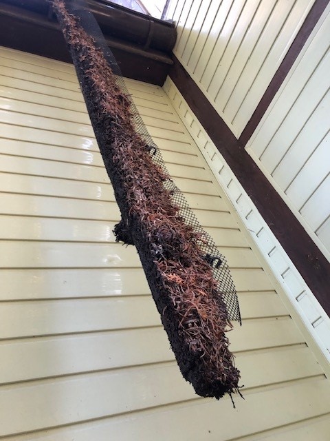

The brushes, covers, mesh whatever just does not work. Think about it, the leaves just clog it up by rotting on the top of them.
I don't know of any success stories, only tales of woe.
I know of someone who specified hundreds of meters of Hedgehog stuff on a big refurb project, and there were problems with it as soon as the scaffold came down. It all had to come back out again. Its the worst con ever.

Dont install leaf guards OP, you will only give yourself further problems.
Cutting back all overhanging or nearby foliage is about the best remedial measure for leaf blocked gutters and roof moss.
