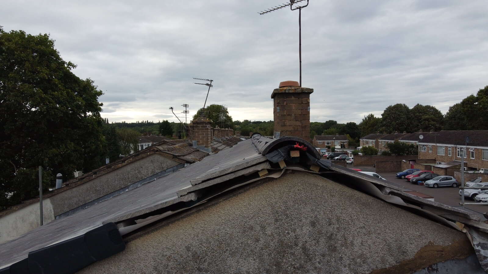

I am checking for rats entry point in my roof as they get in during the winter
I’ve found a large gap to the adjacent house which I plan to fill with wire wool and expanding foam

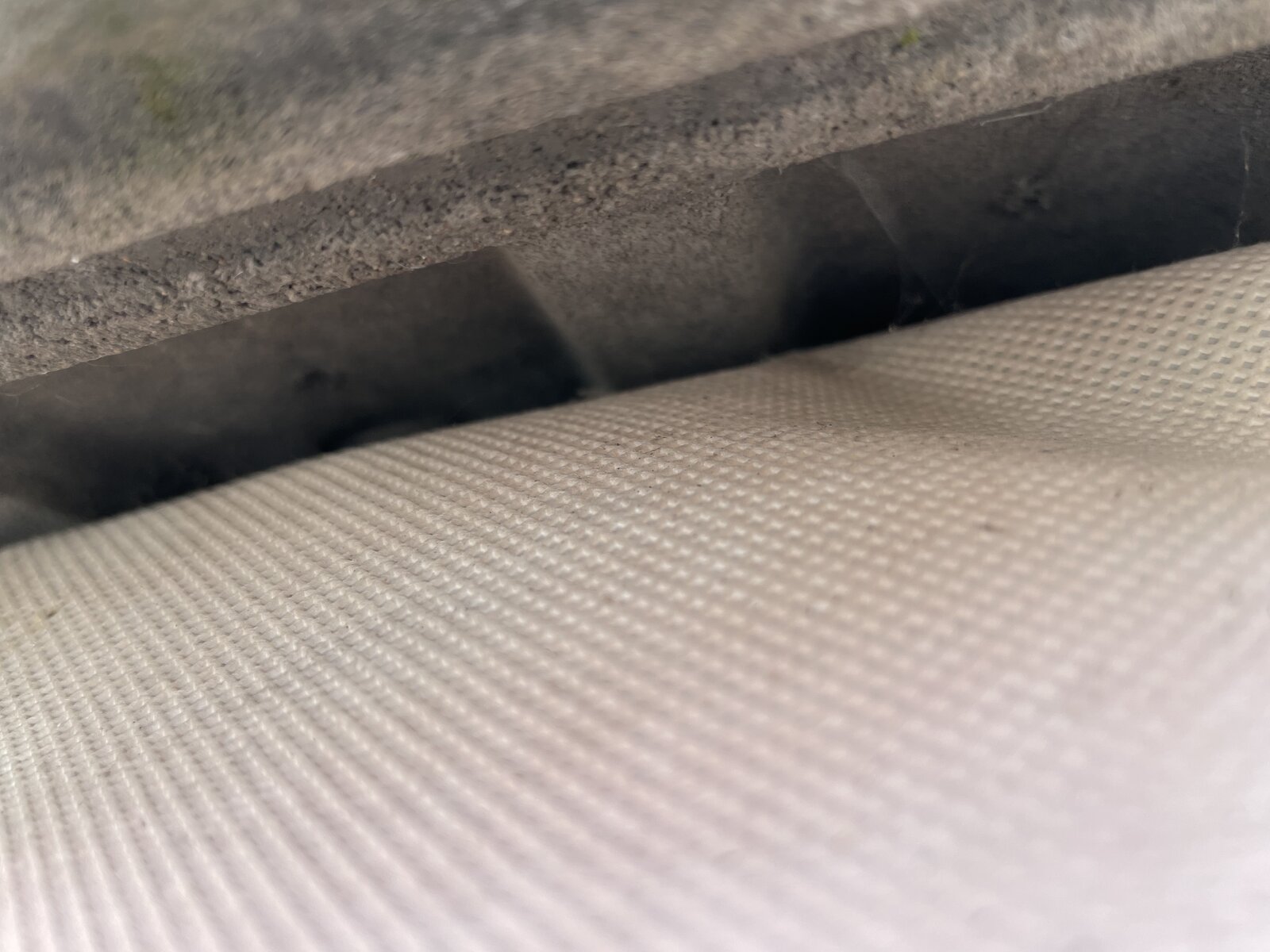

I also noticed there are gaps below the tiles (see second picture), I can fit my finger in there; is it worth closing them? If so, how?

I have seen people fold over wire mesh and push that that in to the gaps. The mesh will allow airflow.

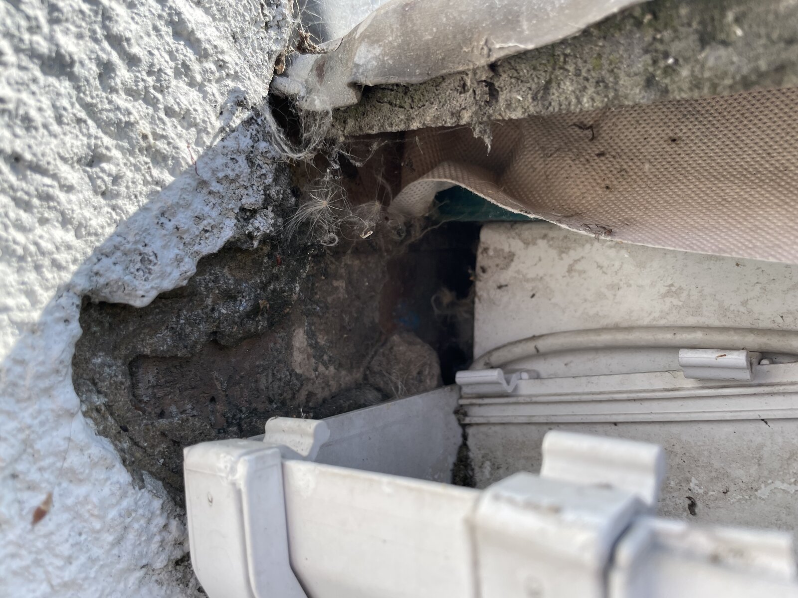

After having had a look I found they are more likely to be getting through the front of the dry verge and then from the side where each tile overlaps the next one
Picture without plastic dry verge taken during reroof

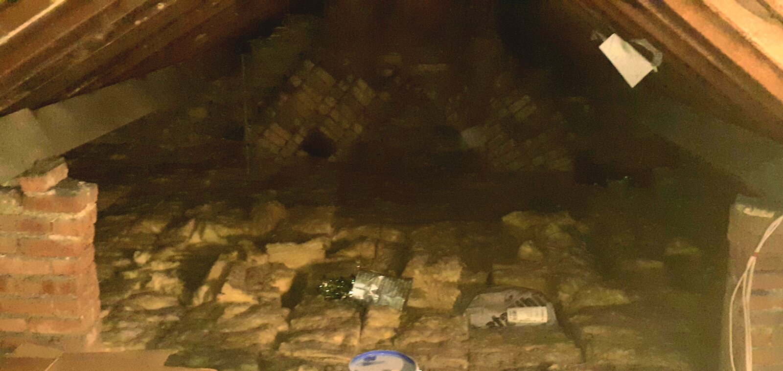

It is very common in my area!
A lot of the terraces have open lofts.
Not the best photo, but this is my loft fully open to next doors, and if the light was better, you could see past the chimney and right down the terrace!
I have now got a firewall up, but am still trying to block every orifice that a rat can get through!

Yeah this was my point. If the OP needs to stop rats getting into their loft (via gaps in the roof) then they need to ensure the adjoining property doesn't also have gaps in the roof, otherwise the pesky rats might find a way through unless party wall is 100% intact with zero gaps. Mind you, they wouldn't have any issues at your place :)
The party wall looks 100% intact; I am a bit more worried by the fact that the external wall cavity provides a route for rats from one property to the other one; I obviously can't see it but is the top of the cavity of an external wall supposed to be open or closed where it meets the roof tiles next to gutters?

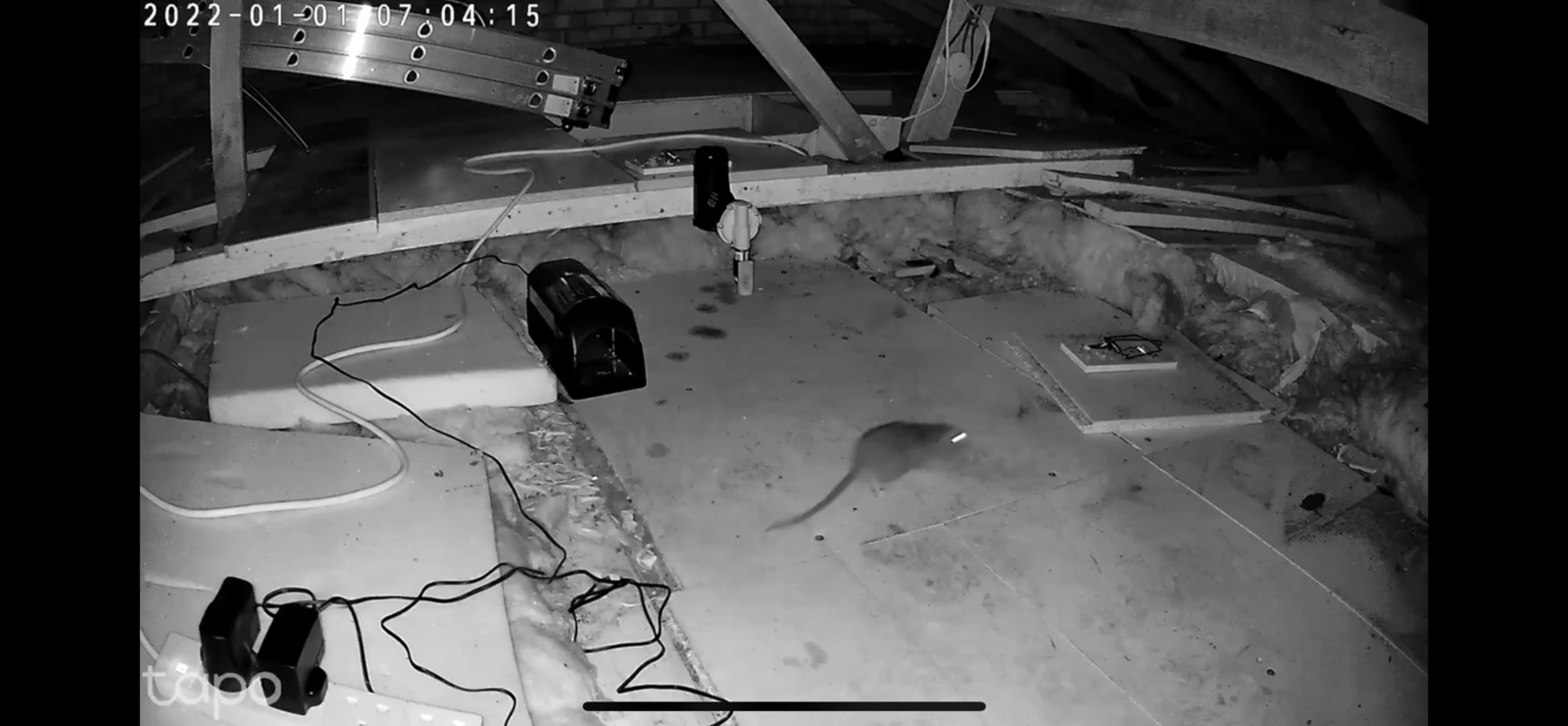

Blimey that sure ain’t a squirrel .. ! Have you rang pest control yet ?
We had a problem with rats climbing up next doors cavity wall and eventually getting into our loft.
The party wall was not "rat tight" between the properties.
They can also climb up fall pipes and enter throught the roof via guttering.
Best bet is bait stations and poison the fxxkers, that's ultimately what worked for us.
