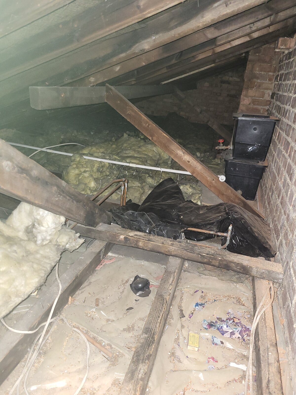

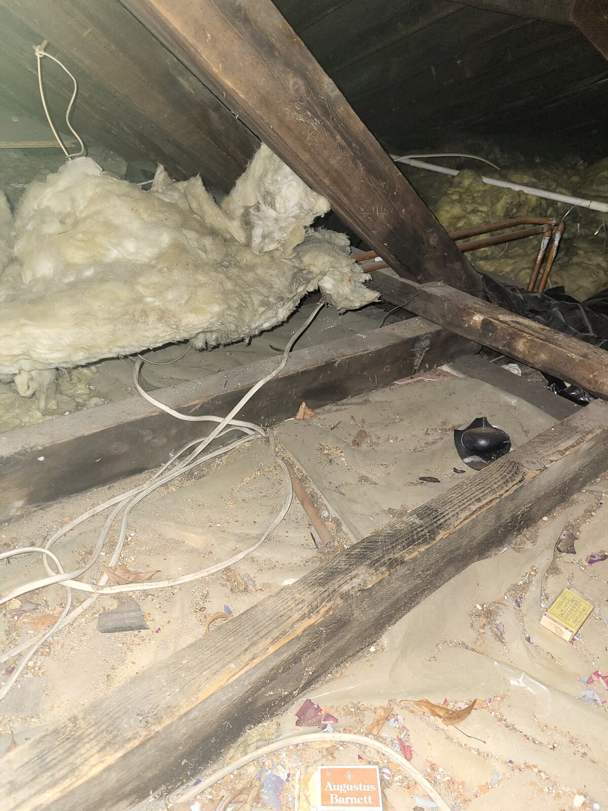

Hello, I'm just wondering how to tell if the joists in your loft are strong enough, whether just for storage or to use as a regular room?
I'm partly asking because we would like to eventually board the loft void above the rear part of our Edwardian house to use for storage, after insulating better (pictures attached, matchbox for scale!)! It used to have two small water tanks up there, and our plumber has scrambled about without falling through.

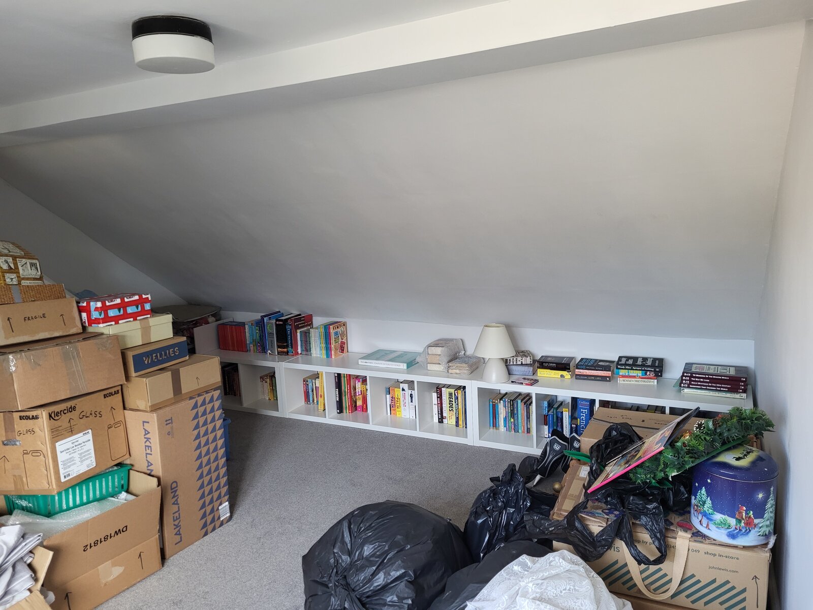

However bonus query - our loft conversion above the main part of the house is also playing on my mind a bit - this was done c.1989 (we moved in last year), with carpeted chipboard-type flooring (a bit creaky). The room stops before it reaches the chimney so sits within the footprint of the house if that makes sense - about 4.1x4.1m minus the stairwell in one corner.
As we know the previous owner who did the conversion neglected/bodged a few other things, I'm just wondering if we should trust that all correct measures were taken to ensure the floor was strong enough... We are storing a lot of books up there and want to put in a spare bed for guests.

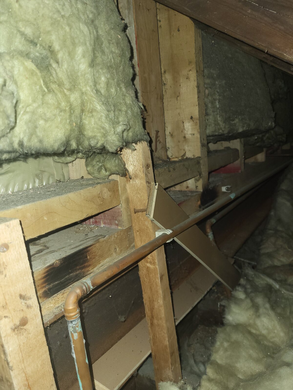

Our window installer did comment that he thought the conversion had been very well done for that era (mainly because the new dormer had been entirely clad in lead). The floor sits more than a foot above the ceilings below (no issues showing on those as far as I can tell). The last picture attached shows the back of the dormer window wall visible from remaining loft void, about level with the floor in the loft room.
Anyway I'd like to find out whether everyone would take it on trust that everything was done properly if there weren't any signs of issues, and if I'm worrying unnecessarily that the books will bring the ceiling down on us one night?!

Is that an rsj I can see in one of the pictures? Have you got any skylights?
Measure the unsupported length of the joists (usually the distance between walls but you might have a supporting RSJ)
Measure the depth and width of the joists, and the spacing between centres
Post the numbers on here and somebody will probably know in an instant, but you can look up tables if you want
Include photos of the joist ends and how they are fixed.
Building regulations approval should confirm that the basic structure met the required standard.
The existing joists are unlikely to be suitable for anything other than access/Christmas decorations.

I can't believe I didn't notice the RSJ before - that's reassuring to see! The dormer window is directly above this RSJ, whereas we have the bookshelves on the opposite side where the roof slopes down - should the RSJ be sufficient to support the whole floor? There wouldn't be another on the other side would there?
