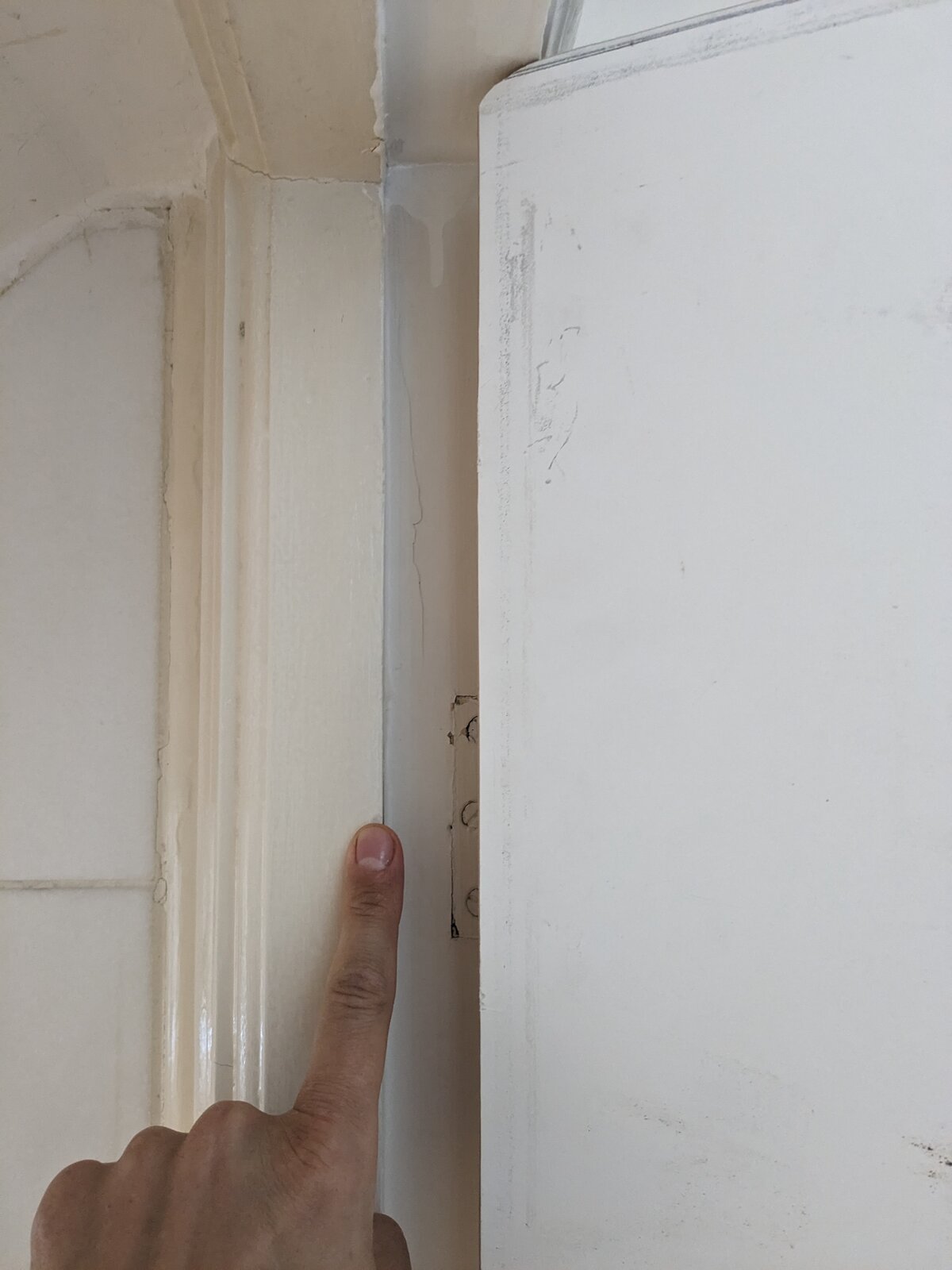

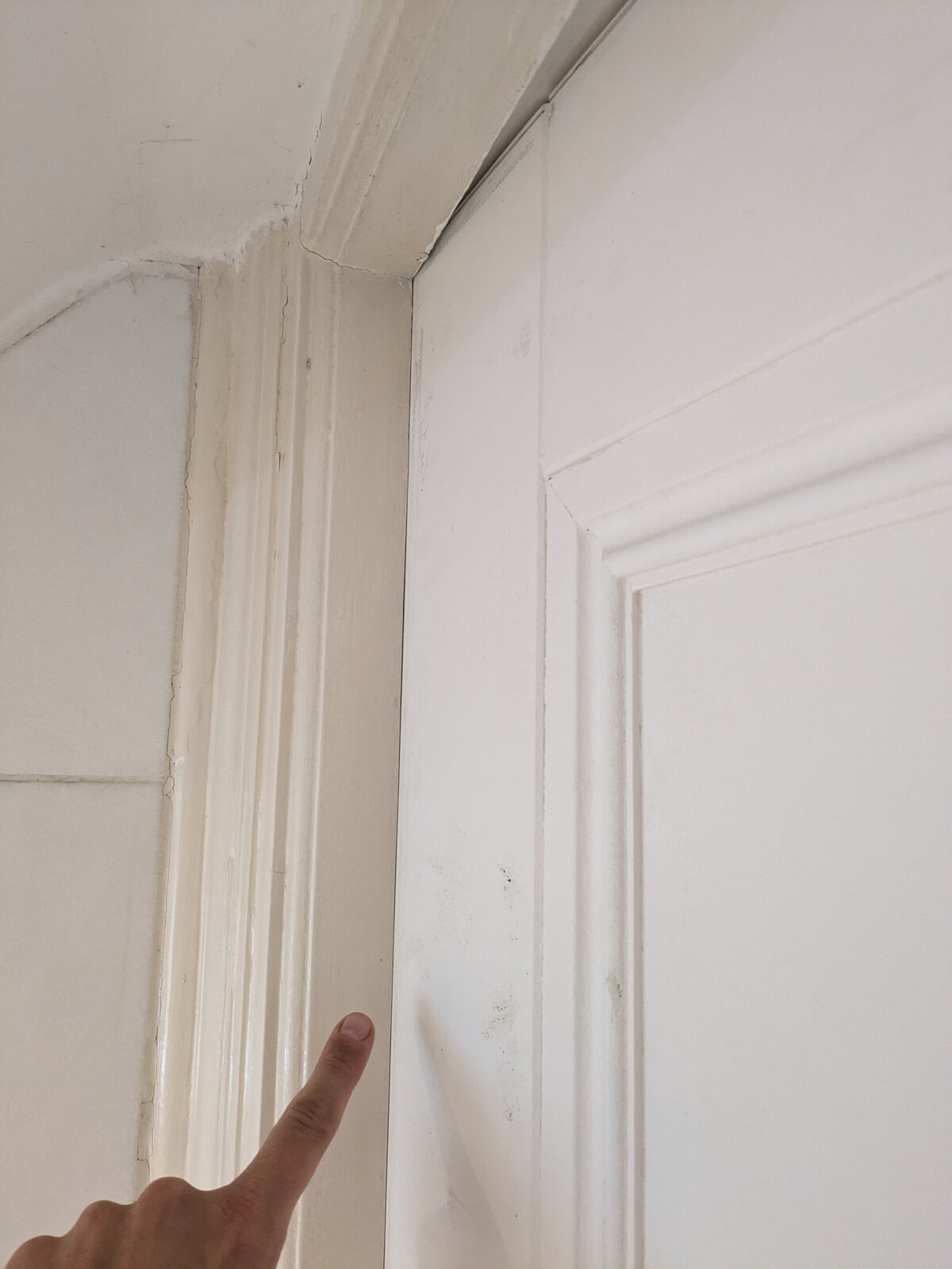

Hi all.
My lovely new internal door won't easily close because the inner/hinge-side edge of the door is too tight against the jamb, when it's being closed.
I want to trim a mm or 2 off the inner edge of the jamb, so the door can close properly, and sit flush against it.
I'd prefer to do it in-situ, and not to remove the jamb, as I'm only looking to remove a mm or so.
Was planning to run a router up it, removing a mm, and then tidy up the ends (where the router won't obv reach) with a bit of sanding.
Anyone got any other tips on how to do this easily?
The hinges on the door are definitely in the right position. They're old frames/jambs, and the previous doors had obviously been quite seriously altered to accommodate the proportions of the doorway.
Pain in the backside because the hinges are too close to the baton.
I would use a detail sander with 80 grit on the baton and protect the frame with a metal blade (i keep a cream spreader for cakes in my toolbox).
Then finish with finer sandpaper and paint that bit.
Good point, I hadn't even considered a detail sander. My solution was much too complicated . I might give it a bash today.

I doubt that the stop can be trimmed down to leave a dead straight and square edge.
Remember the the stop on the frame head will need reducing too.

Thanks all, it worked!
Which option worked?
Personally, I would have used the match stick option. The problem with your door stop option is that if, you were, for example, to remove 2mm from the hinge door jam, you might need to remove 2mm from one side of the header door stop down to 0mm at the opposite side.
I am confused though, the door is new. Why has the corner been rounded over?
Didn't need to alter the hinges, in the end. Trimmed about 2mm off the inside edge of the jamb with a multitool sander. Works perfectly
