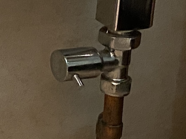

Two valves, gas central heating.
I've learned that the two valves are likely to be:
-- Lockshield: Controls amount of hot water entering the radiator ("also ensures the operation of the towel radiator won’t impact the performance of other radiators in your home).
-- Wheel-head: Controls amount of hot water released by the radiator ("to control the radiator’s temperature"). Anti-clockwise: increase flow; clockwise: decrease flow.
But which is which in my system?
The left-hand one likes to leak some blue-green fluid since I first fiddled with them last year.
The rad is roughly above the combi boiler, which was newly installed in February.
This is the back of the house (left). All the other rooms are off to the right of this pic.

No idea, and I'm afraid I don't understand the terminology here.
Visually, they look like this on the exterior...
With them both open and the heating on, the pipe to the one that gets hot first is usually the wheel head side.

Once you know which is which, you can experiment by slightly opening the lock shield valve. As you say it’s pretty near to the boiler, I’d start by cracking it open a small amount and opening the wheel head fully. If it doesn't get hot enough, quick enough, open it a bit more until you are happy with it. Trial and error really.

With both valves fully open ,turn on central heating. Go to the rad and feel both pipes ,one will heat up before the other and that is the flow.
The valve on the flow side is what you will use to turn that rad on or off as you wish. The other valve is the lockshield and must be left open,to some degree ,exactly how much is a bit of trial and error . Try closing it fully ,leave the rad to cool then open it a little bit until the rad starts to heat up. And leave it in that position.
Show us a pic of the top of the rad, the air bleed valve may be under a removable cover.
Ah, okay. Left was first to heat up. Left is flow.
I have ended up putting the lock shield somewhere between open and closed, and the flow at maybe a quarter open. Sound about right?
