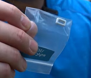

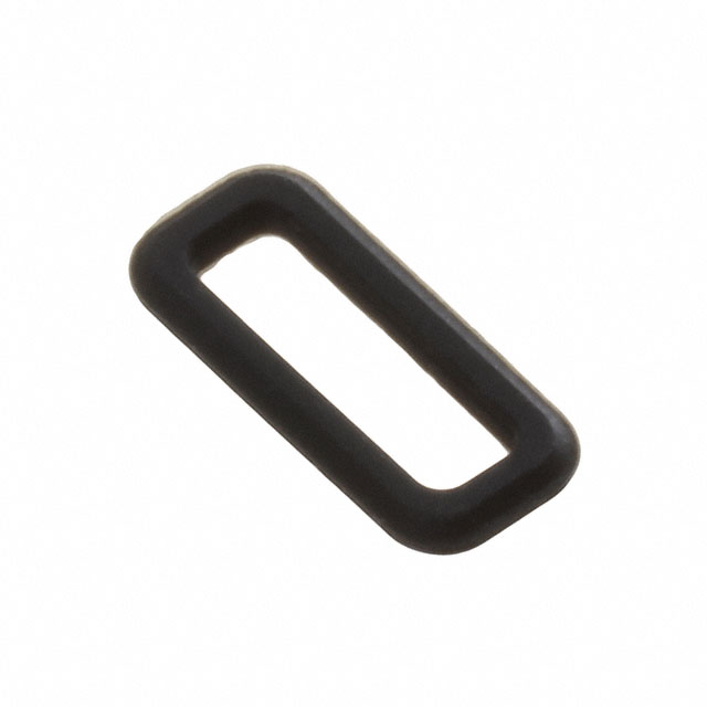

As far as OP’s actual issue, I ended up calling Eufy tech support today to see if they would provide some of the model specific waterproof cable gaskets that they ship in their Eufy-branded solar panel kits, in case they would fit nicely. I have Eufy 2C’s, and bought 3rd party panels on Amazon for $16. The guy was very helpful but couldn’t find the gaskets in system as shippable parts, and suggested I email the request. I’m not hopeful. Meanwhile, I wanted to get my panels installed today so just used some dielectric grease. May pick up some silicon tape and add that on.
Here's a link to the panels I'm using. They’re working well enough that I left a review with pics showing one mounted in my Rhododendron patch.
I'm attaching a screengrab of the official "Waterproof Gasket" in case it is helpful to somebody with Eufycam2C's, and also a pic and link to something from DigiKey which might be interesting.
