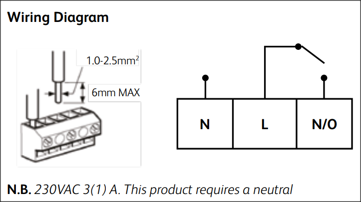

To those who successfully managed to install this setup I was wondering how they're powering the Nest thermostats when they locate them where the existing ones were? I have 2x ESRTD3's (and a ES3247B programmer) and want to put the Nest thermostat where the old thermostat went, but as far as I can see the old thermostat runs off the mains neutral and live? Are people buying small transformers and jamming them in the wall or is there something I've missed?
Thanks!
Russ
First of all if you have a programmer that also controls the hot water, the Nest Heat link replaces the programmer not the thermostat. The thermostat doesn't have all the necessary wires present. So you need to explain what your existing programmer does.
Your thermostat has 3 terminals there should be three wires connected to it:
A live wire to L
A switched live wire to N/O
A neutral wire to N
Is this what you have?

Hi Stem - apologies for hijacking the thread, as Milly said I thought it better to have all the information in one place in case someone (like me!) looks for this in the future, as I found this thread incredibly useful so far! You are correct in the setup, below is a picture of the physical connections:
Hi Milly - thank you for your response, that has got me thinking! I guess the question now is whether the L and N that go into the thermostat are directly spliced from the mains (in which case they are useless to me) or whether they route all the way back to the programmer where they are connected to a common connector. If it is the former I'm stuck, if it is the latter I guess I can repurpose these wires to take the output from the heatlink - I will take a look tonight! Thanks again!

If the above diagram is correct for your system, then you have three motorised valves connected to two central heating zones and a hot water cylinder. Not an easy system to convert to Nest, I'm afraid.
First of all, you will need two Nest Heat links, each with its own thermostat. One Heat link will control one heating zone and the hot water. The other Heat link will control the second heating zone
The existing wires going to the programmer will need to be split and redirected to the two Heat links. This will involve major rewiring and needs to be done by someone competent who fully understands the function of each wire and what it does. Unless you are really competent, this is not something that can easily be done DIY over a forum.
