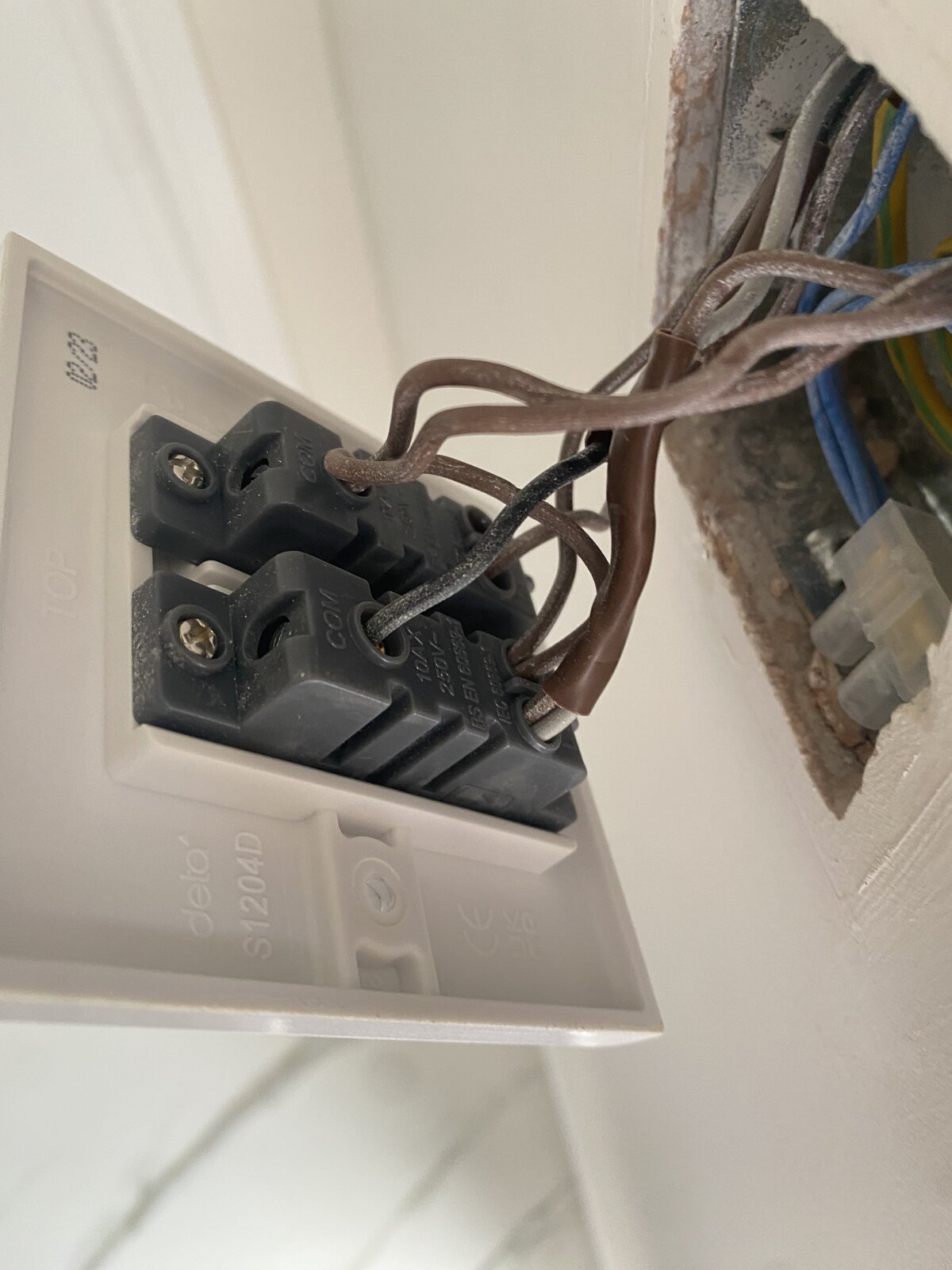

Can anyone tell me how to wire from the existing switch to the new one please?
Photos attached

Look at your original light switch and you can see it is two triangles. But with both COM's at the top.

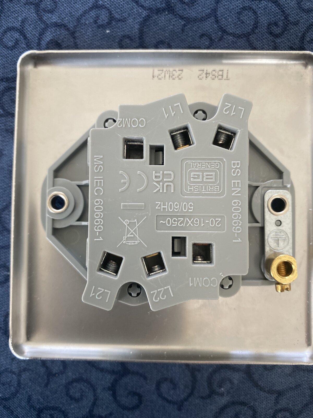

Your new light switch is also two triangles, but one triangle is upside-down to the the other.
One triangle with its COM at the top and one triangle with its COM at the bottom.
So you need to transpose the wires in the two triangles from the original switch to the new switch,
(with new switch having one of its triangles upside down).
So from the original light switch move the wires that are in 'COM left' and 'COM right', to COM1 and COM2.
And move the two sets of wires in the two 'bottom left' holes, to L11 and L12 (it does not matter which is in which).
And move the two sets of wires in the two 'bottom right' holes, to L21 and L22 (it does not matter which is in which).
Left Switch:
'COM left' =to= COM1
'bottom left' holes =to= L11 and L12
Right Switch:
'COM right' =to= COM2
'bottom right' holes =to= L21 and L22

Dam I missed something important..
Now on bigger screen and can see it is a metal faceplate on the new switch.
I think I can see ground wires connected to the metal back box. You need to coo ect those wires to the ground connection on the faceplate. (Or if you have some a short length of ground wire from the metal back box to the socket).
This is because metal switches and faceplate need to be directly connected to the ground wire (and not just through the faceplate screws).
From?? I have removed the earth wires from the back box and attached to the plate, if that’s it?
(sorry -uploaded half way through typing).
Perfect. That is exactly correct.
