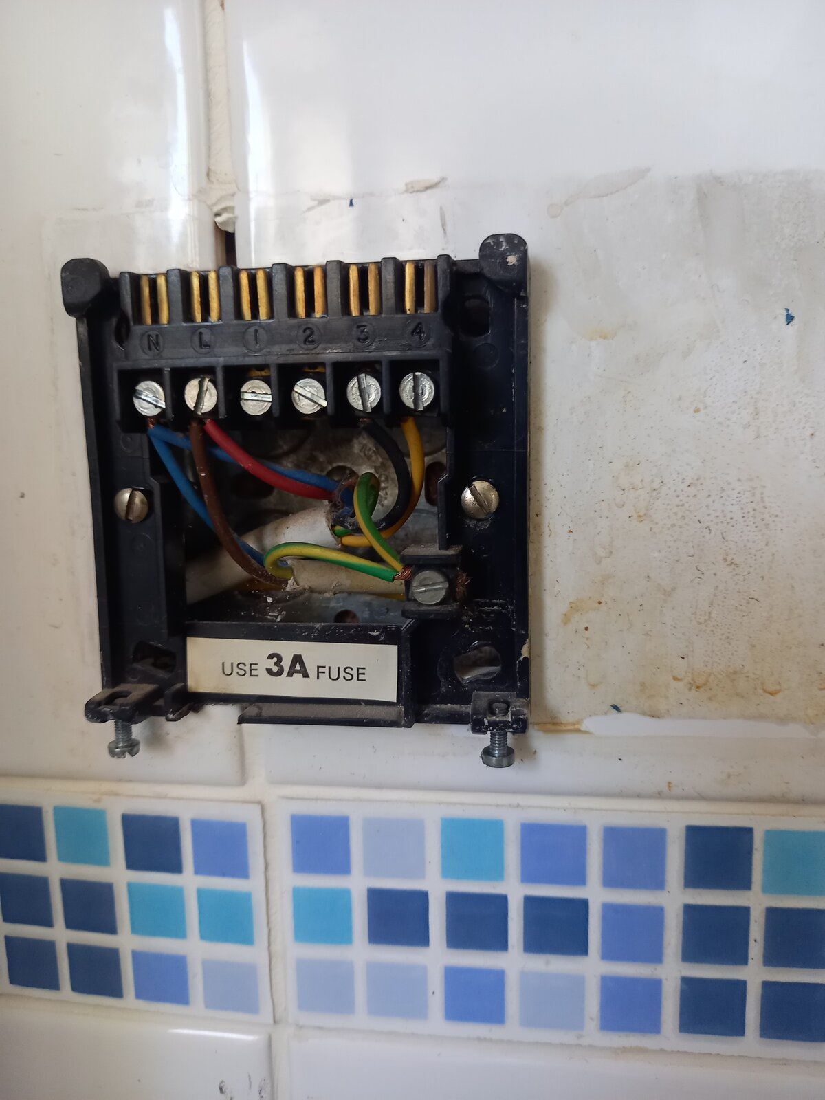

We recently changed our water cylinder to an unvented one. Our old drayton programmer was really old and melted (!) so I bought a new one but didn't change the background wiring. Since we had the cylinder installed our heating comes on when the hot water is heating unless I turn the thermostat right down. I am unsure if this is due ot the wiring of the programmer as there is nothing going into terminal 1 or 2. Could anyone shed light on what I need to do to fix this? Thanks!

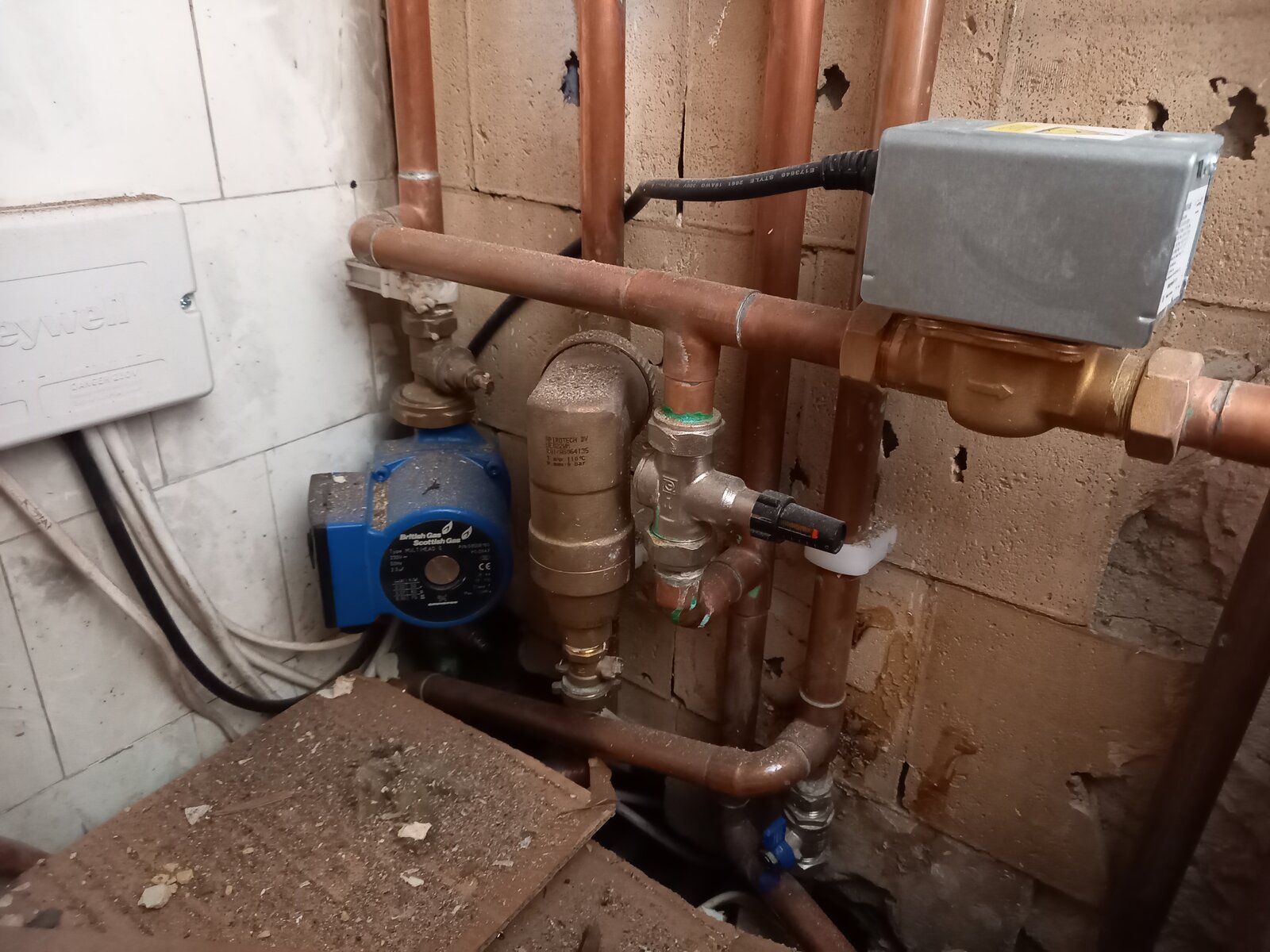

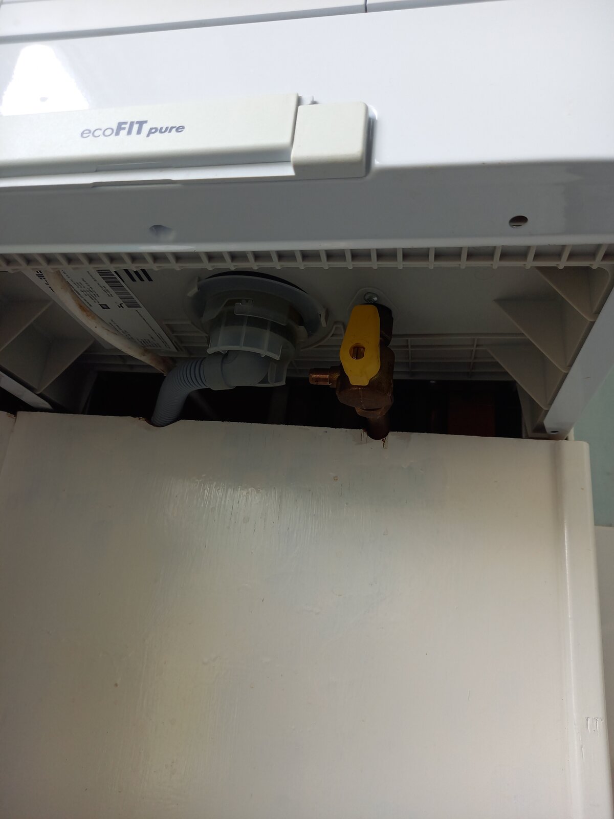

Please photograph the pipes and cables and other items around your boiler, cylinder and pump
Look for a motorised valve
Thank you. Boiler is from 2018.
Photos attached. Sorry complete novice I assume the valve is in our airing cupboard?

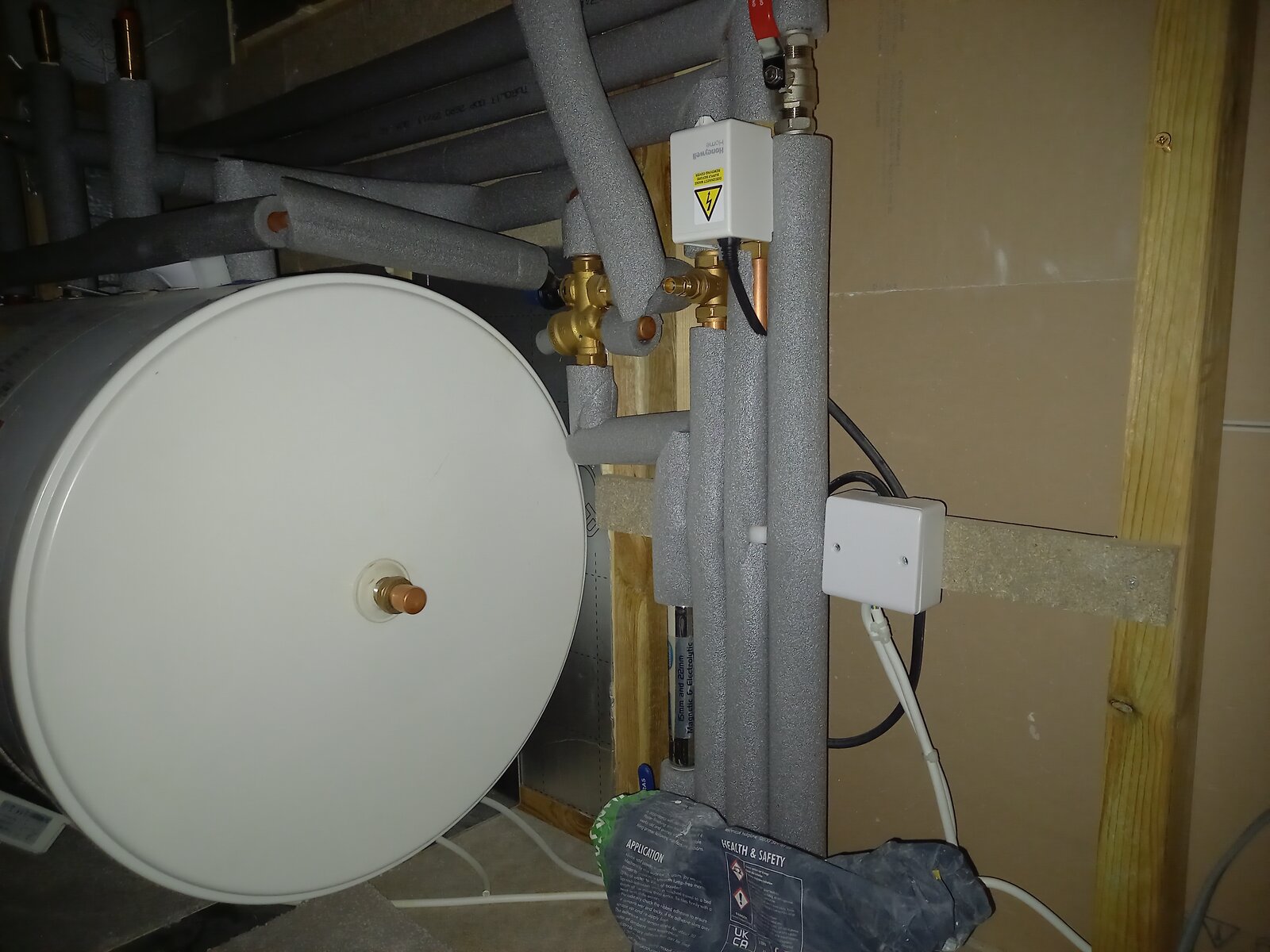

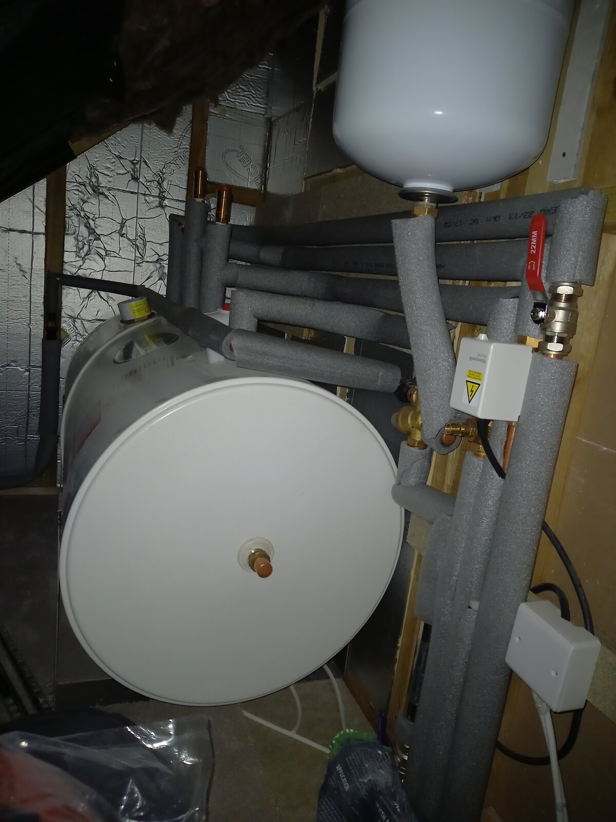

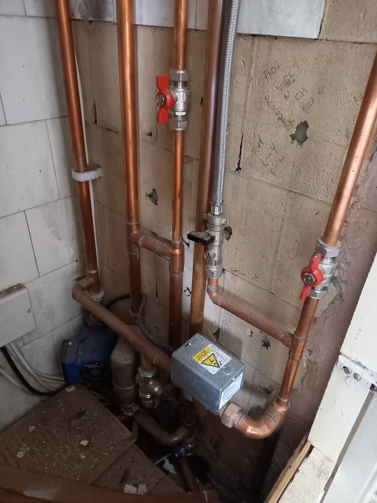

What Drayton did you purchase? Can you get better photos of cylinder cupboard? I can only see one motorised valve but cabling for at least two.
Drayton LP722 it looked identical to my old one apart from being able to programme 7 days rather than just 1 day
I wasn't sure if you meant the airing cupboard which used to house our old cylinder and has the blue pump or the nextcto the cylinder but took both again.

I have limited experience. But we had a string of similar problems and it was always a sticking motorised valve. BG eventually changed all three and there's been no problems since. So, it may be nothing to do with the changes you've made.

OK thanks. The programmer got changed afterwards as the man who installed the cylinder said we should replace it. I don't see how it could be the programmer really but wanted to check it wasn't the wiring.

To answer your OP about terminals 1 and 2, you don’t appear to have a y plan, so 1 isn’t used, and 2 is very rarely used.
